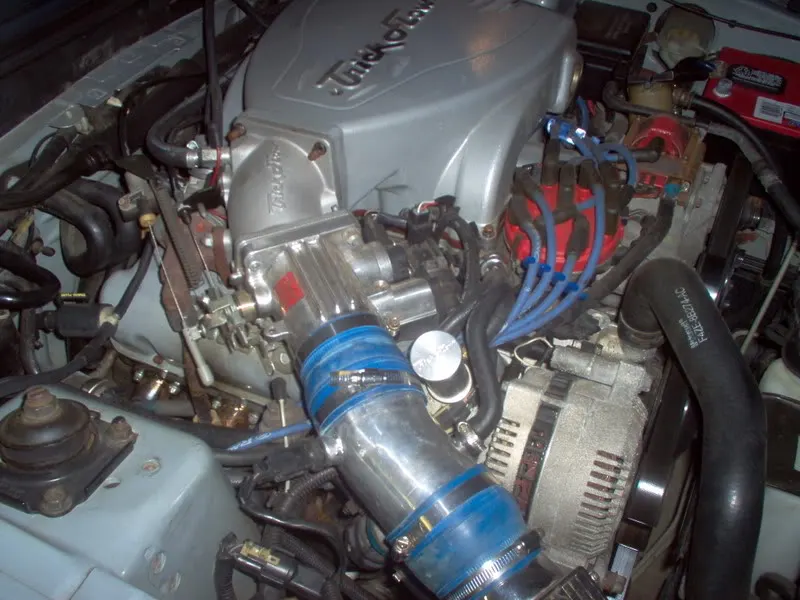

let me see if I can find a pic....or 2

I'll tell you how I made out and you can take it for whatever lol.
I have the street heat with a 1"spacer. I have fox vc's which are higher then stock I believe. I needed a spacer for the egr valve to clear. people say I could have used a 3/8 or whatever the smaller one is but i wasn't gonna buy it and find out they were wrong so I just bought the bigger one. Also i had to use 2 of the adapters that 50resto sells to keep the egr pipe on there right cause it kept coming loose and falling off. (I have a 3rd one never opened if you wanna make me an offer) I have a TFS adapter on it as well and a bbk 75mm tb and it all lines up fine. The CAI I have on it is a little shady but it worked. As for the hood clearence I couldn't tell ya I have an after market hood. The first one I had which was the same style i had clearence issues but the new one don't. The STB def will have to come off. they make aftermarket ones that will fit around different intakes but i never felt the need for it. Off the top of my head thats all i can think of. If you have any question feel free to ask
