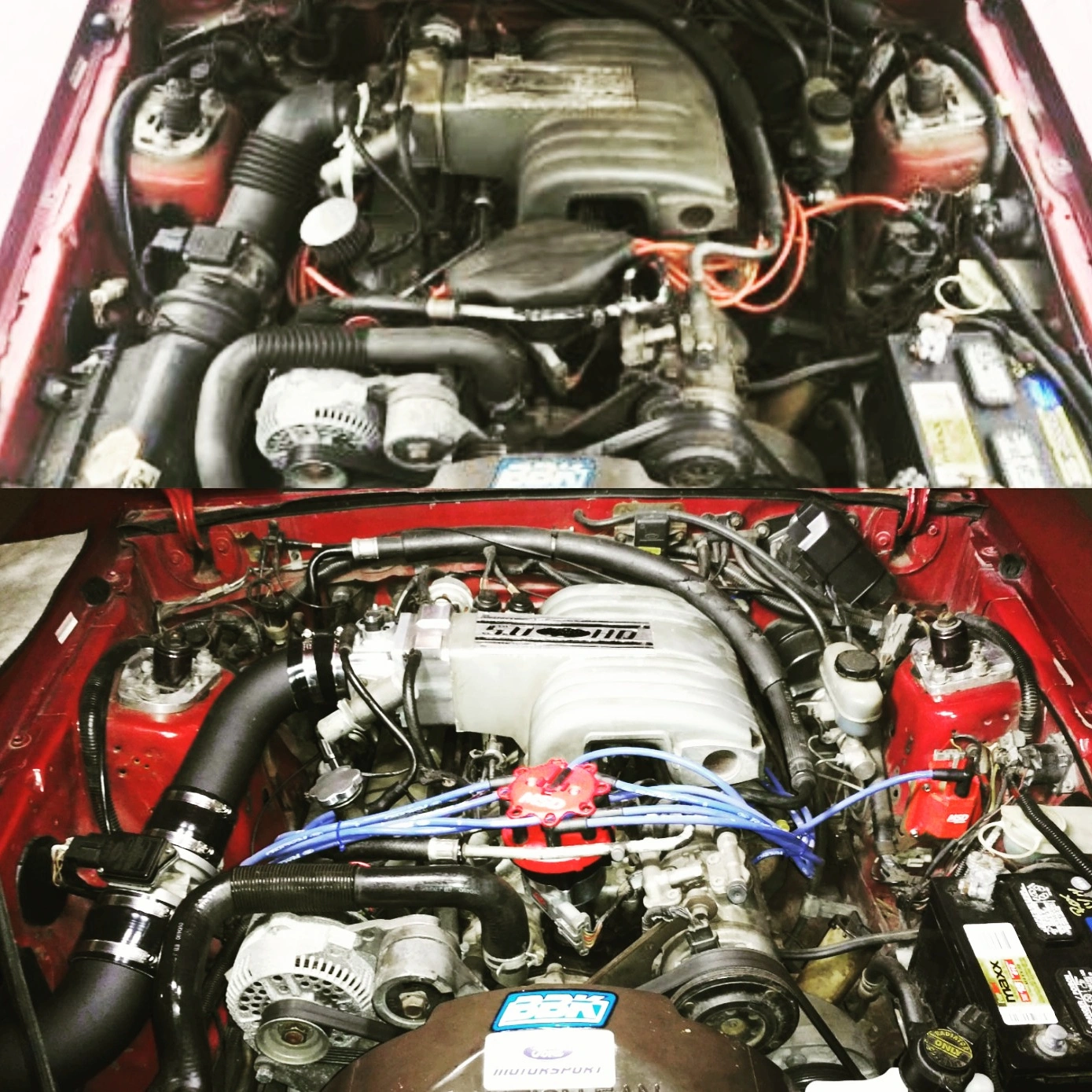

I've been contemplating upgrading my stock intake, possibly heads and cam as well when cash permits, but i've been torn deciding whats the best "bang for my buck". I like the look of the Cobra intake, theres some pretty cheap ones available on Ebay, then theres your edelbrock, trickflow, more expensive stuff. I just want a decent power increase and a good look in the engine bay. The stock manifold that I have is, OK. I refinished the 5.0 plate, but the rest of it shows wear.
as far as heads and cam, i've heard GT40 heads are good, cheap, but not sure how much power those actually yield. The cam, I really do not know much about. I don't know the differences between them, but I want something thats as aggressive as I can get on a street car.
current mods- underdrive pulleys, 3G alternator, electric fan, welded SFCs, lowering springs, msd pro billet distributor, msd ignition coil, performance starter, smog pump delete, CAI w/ 70 mm throttle body, caster plates.
next in line- cobra rims, better brakes, H/C/I, blower

FWIW your typical GT40 iron head, Explorer intake and decent OTS cam, 65-60mm TB. 70MM MAF, aftermarket 1.6 rockers will yield around 260-275 rwhp. A good aluminum head combo- AFR, TW with the same other parts will give you another 30-50 rwhp and reduce the weight over the front end by about 40lbs

I have the SR performance cold air intake with 75mm throttle body and EGR Spacer. I am looking at intake manifolds lately and wondering if I will need a whole new air intake, throttle body, EGR if i replace the manifold. I am looking for a cobra intake on ebay. I also saw trickflow track heat, and some edelbrock used on ebay, but I honestly like the look of the cobra intake the best. Any advice?
Explorer intake.
Cobra is nice, but only if you pick up one of the older Ford-made intakes. The latest intake is made in china. The explorer intake is pretty much the same thing as the cobra with slightly different look to it. Also, I believe the upper manifold on the explorer is sized for 75mm while the Cobra is either 65mm or 70mm.
With a cobra intake, you can sell off your 75mm EGR spacer as it's intergral to the intake.
75mm TB is kinda large for even your stock intake. Certainly won't hurt to keep it though.
If you are still running stock heads, there's really no reason to get a bigger intake beyond Cobra/Explorer. The heads are a huge bottleneck.
