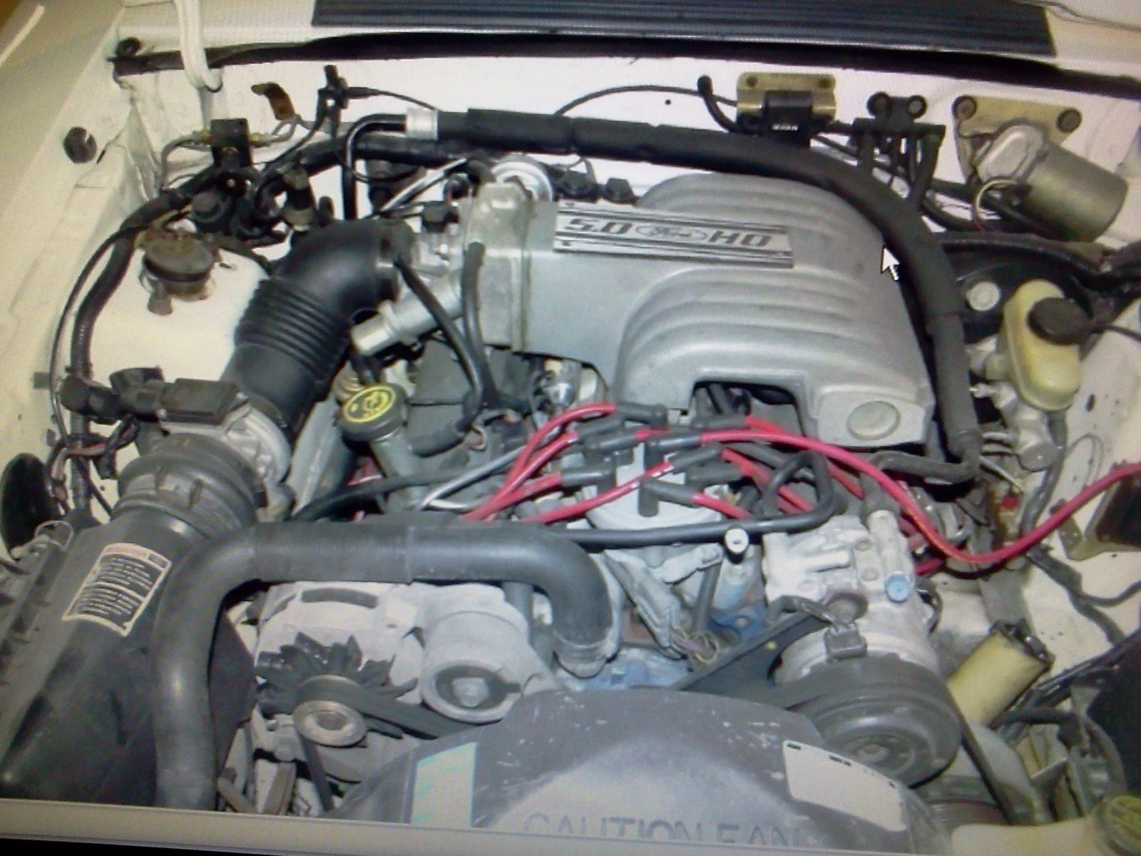

I am very new to the fuel injection stuff. I have been old school working with carbs. With the better flow exhaust I think I should have more air intake but now sure. I was wondering if a bigger throttle body would be the answer and if so do I need to change the mass air also?
Stock air intake setup is pretty much a cold air intake already. Not much to improve unless you want looks.
A decent intake to go with that's cheap is an explorer setup. You can get them for around $100 with the 65mm TB. Takes a little modification to work on a 5.0 Mustang, but nothing complicated.
A 94-95 GT 70mm MAF is also a good part to swap out.
For under $200, you can have a pretty decent upgrade. At that point, your main choke point would be the heads.
Reactions: A5literMan
All good points above. Only thing I'll add is for $30 grab a 94-95 mustang 70MM MAF as well. You'll need either an adapter which they sell on Ebay or fab one up. It's a plug and play swap that increases the MAF area from the stock 58MM.
