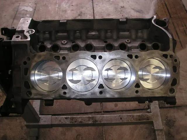

well, i mocked up my stuff tonight.....
short block as seen here...
I put the heads on ( Windsor senior lite aluminum heads) valves are 2.02 and 1.60... as seen here

the intake valve actually hit the piston and i didnt go any further.....

AHhhhhh.. the 2.02 valve size.. I'll bet it is way OUTSIDE the notch on the piston!! Yes?? Take a die grinder and "layback" the valve notch to clear the valve... it isnt that the notch isnt deep enough... it is it is too small!! Or pull the engine down and have a shop do it!! cool??

yes, the valve touches ABOVE the valve relief in the piston

I would never take weight outta a piston (grinding) w/o re-weighing everything making sure each piston was exactly the same down to the nearest grahm. This is your rotating assy dude, dont do some shady stuff. Those look like stock forged replacements, easiest thing to do since your alls etup up (shortblock wise) get some tfs tw heads (2.02) they clear stock pistons.
Other wise i recc u pull the pistons have them flycut..and then re-mock the motor up and do your clearance cks.
