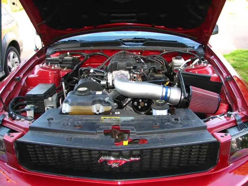

The C&L and Bamachips X-cal II tune are very, very impressive!
MM&FF said a 'Shield' is a must, not a closed airbox.
