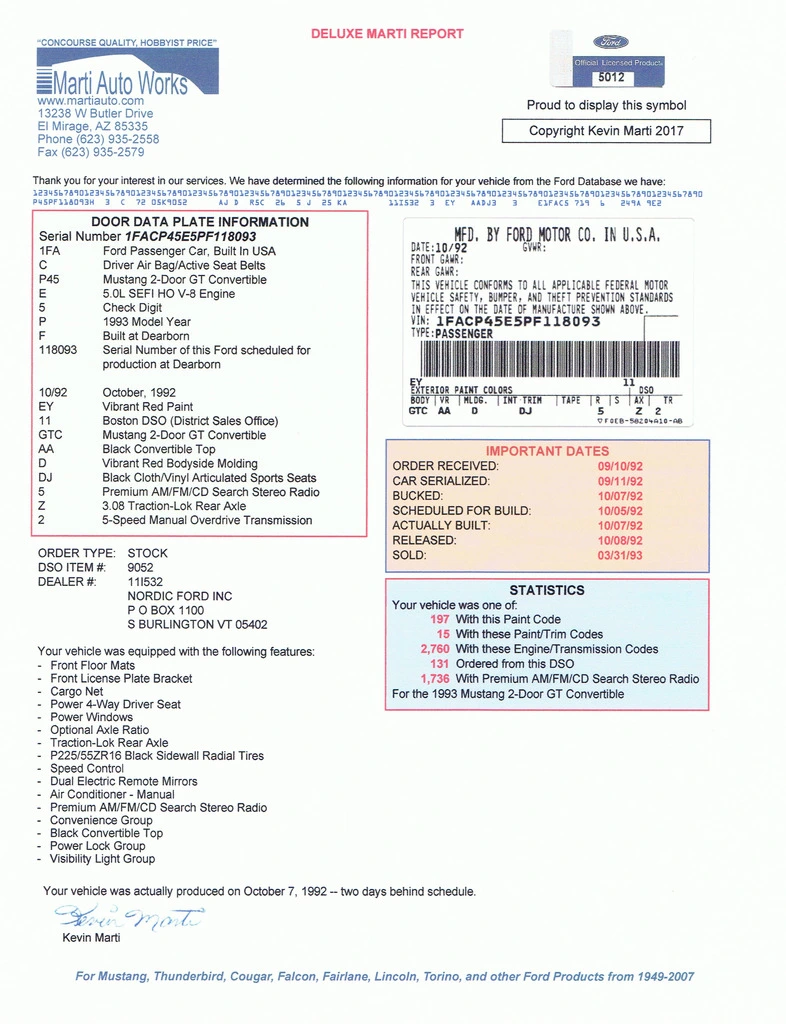

Last year I posted a thread about my 1993 Mustang GT vert with 25,000 original miles. I got a Marti Report this morning and was surprised to see that my car is
1 of 197 with paint code EY
1 of 15 with paint code EY and interior code DJ
1 of 1763 that came with Premium AM/FM/CD search stereo radio

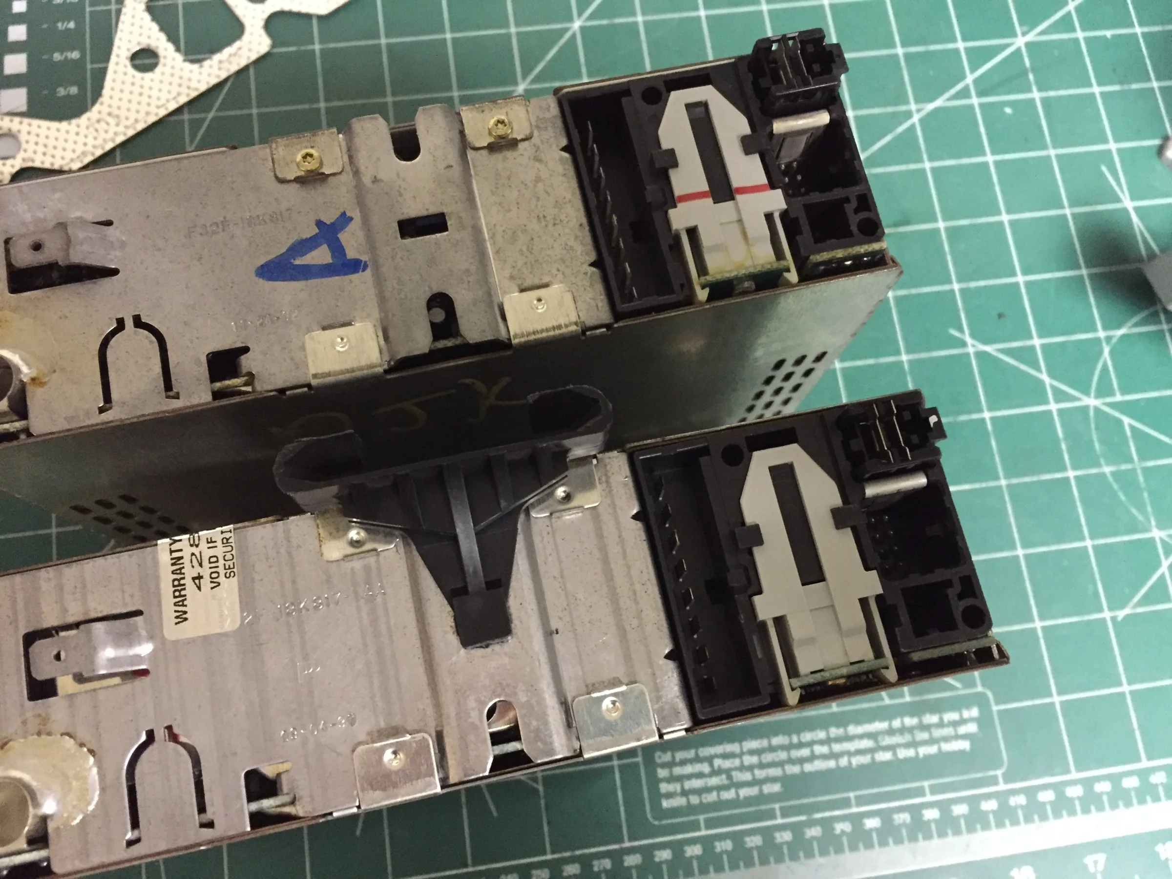

Here's a side by side of the factory 1993 cd and a contour CD player. Contour on the bottom. Same plugs. Like I mentioned before I'm running a contour stereo in my car with the mustang amp and wiring. Works fine
Main thing to look for is some radios feature a 6th preset, and some have a clock button. The mustang setup used a clock button radio.

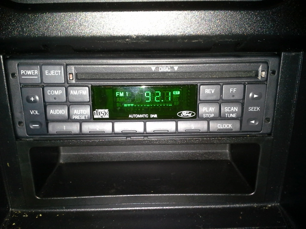

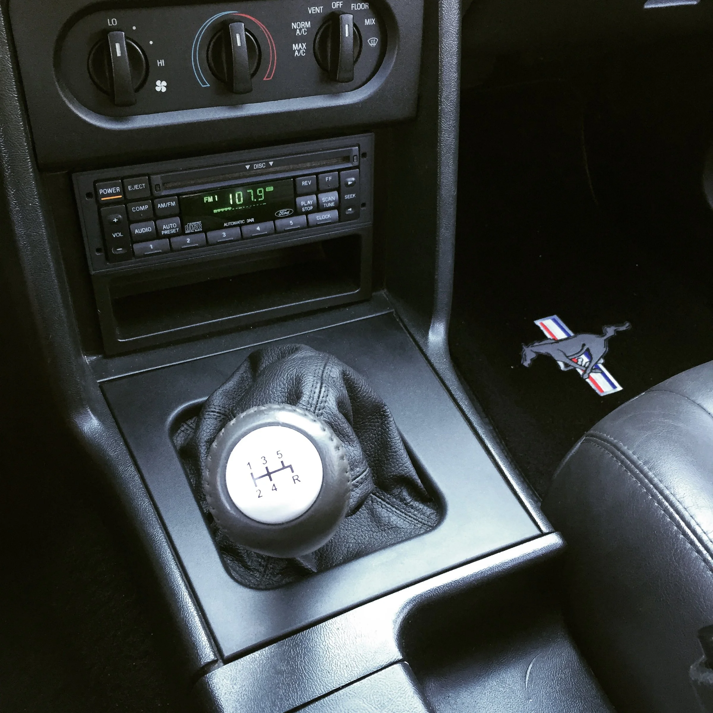

Here's my radio. It's a contour radio guts, but as you saw in the other thread, I dissected a busted 1993 radio for the bottom plate and the faceplate. Works fine

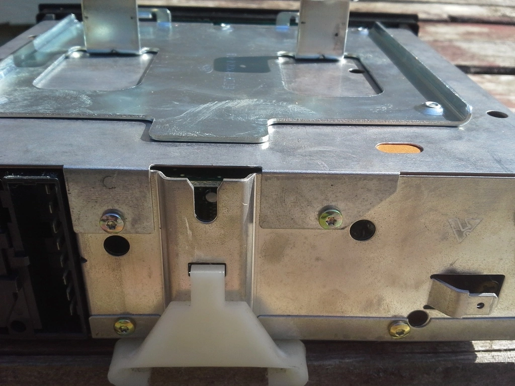

What I'm not seeing is how you swap the cubby mounting bracket from one head unit to the other

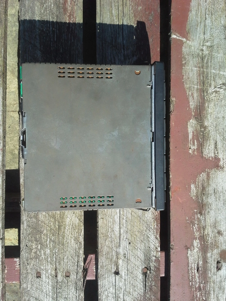

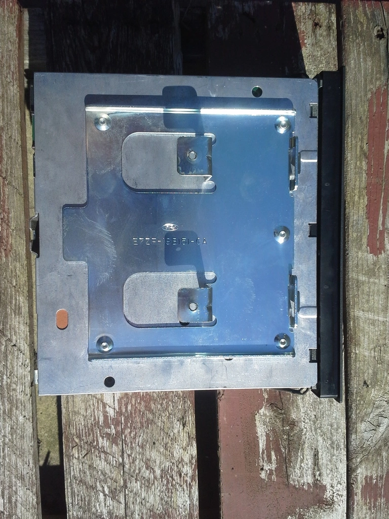

Here is the bottom of the 1993 tape player with the cubby mounting bracket installed
here is the bottom of the cd player
Did you remove the entire bottom plate from the head unit and swap it over to the new one or did you remove the rivets from the cubby mount and remount on the new cd head unit?
It looks like I may be able to remove the small torx heads and take the entire bottom off?
Gotcha. I was going to edit my post since I went back and reread your posts from above. The only thing stopping this from being a five minute install is the fact that I don't have a torx bit small enough to remove the plate!
Hopefully this job will be done tomorrow.
