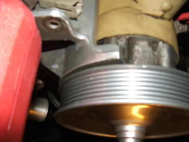

i think i got it on all the way. i put the pulley on up until the back side of the shaft doesn't show any of the clean part. but the front isn't flush, from what i remember the shaft and the pulley was flush. i'll try and get a pic.
not the best pic, but you could see that the pulley is not 100% flush with the P/S shaft.
also you can see i'm pretty close to the braket
