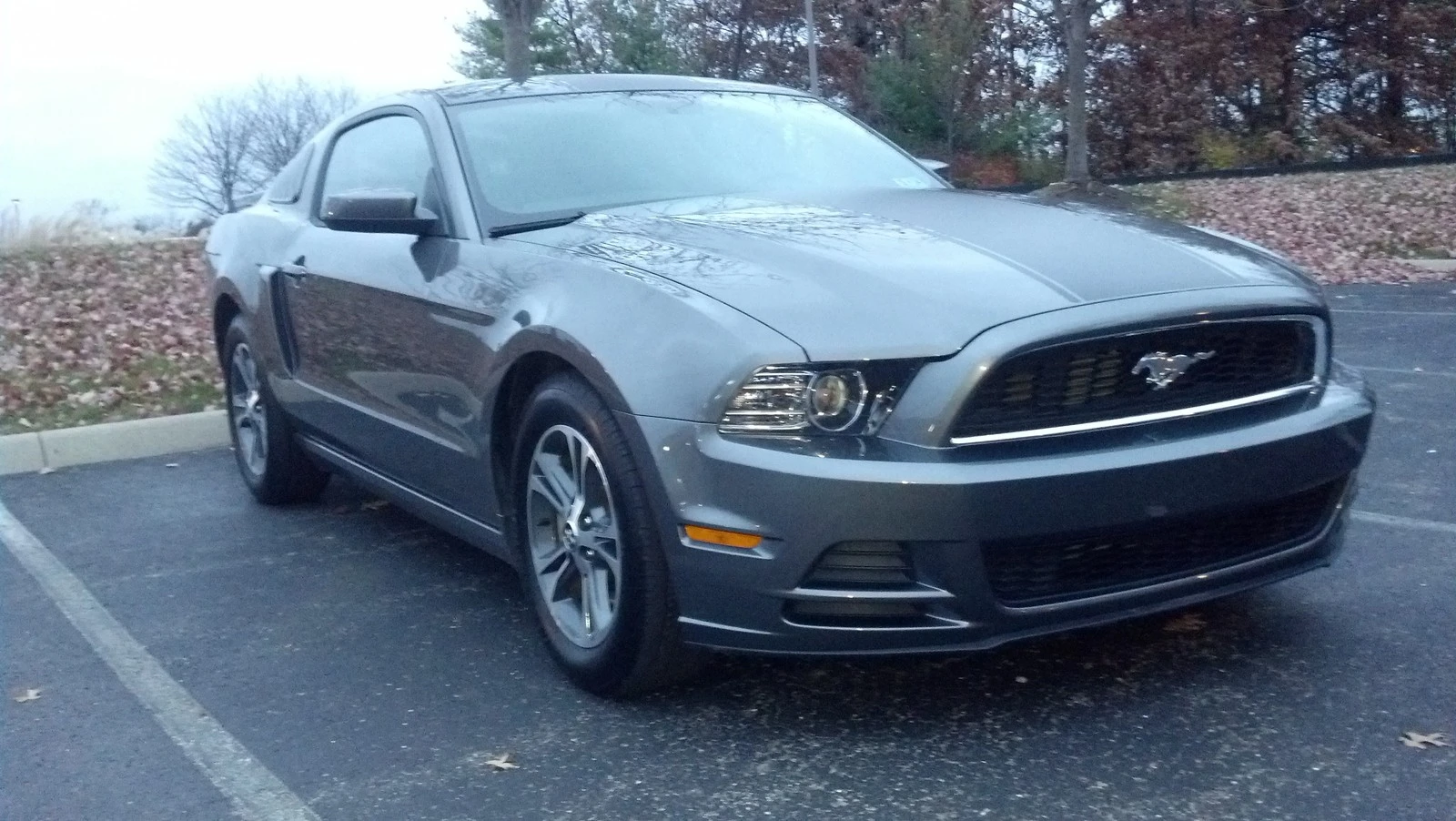

Thanks for all the help! I just bought my first Mustang today, and I could not be happier.
It's got the 3.31 rear end. I made sure of that.
I've still got to get used to it because the only manual that I've driven regularly is my motorcycle, but I can tell that I'm keeping it. Thanks again.

Once I saw the Sterling Gray, I fell in love. I didn't want to go with red because 90% of my cars have been red. I liked the blue and the black, but to me nothing quite looked as good as that gray.
I didn't even notice the racing stripe with the first pictures that the dealer sent (low rez & bad angles).
