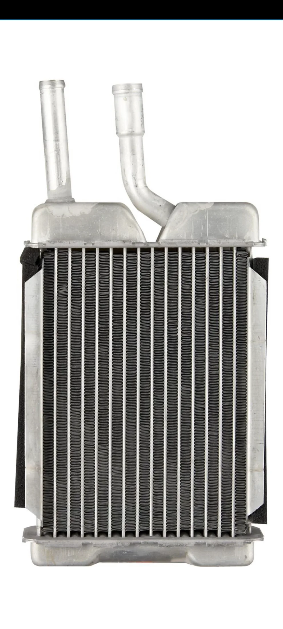

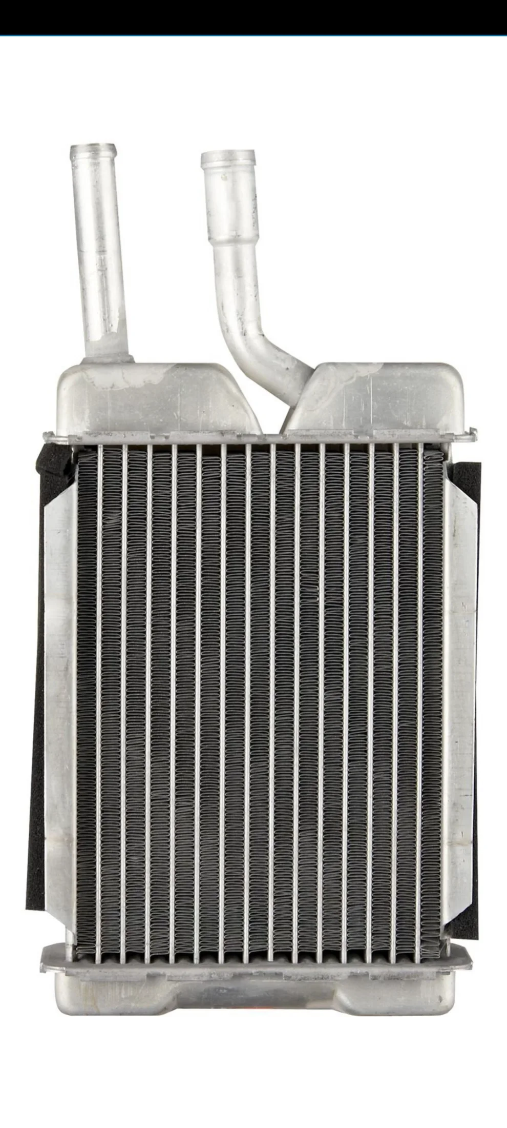

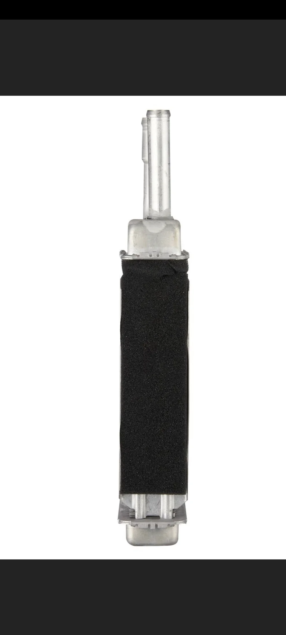

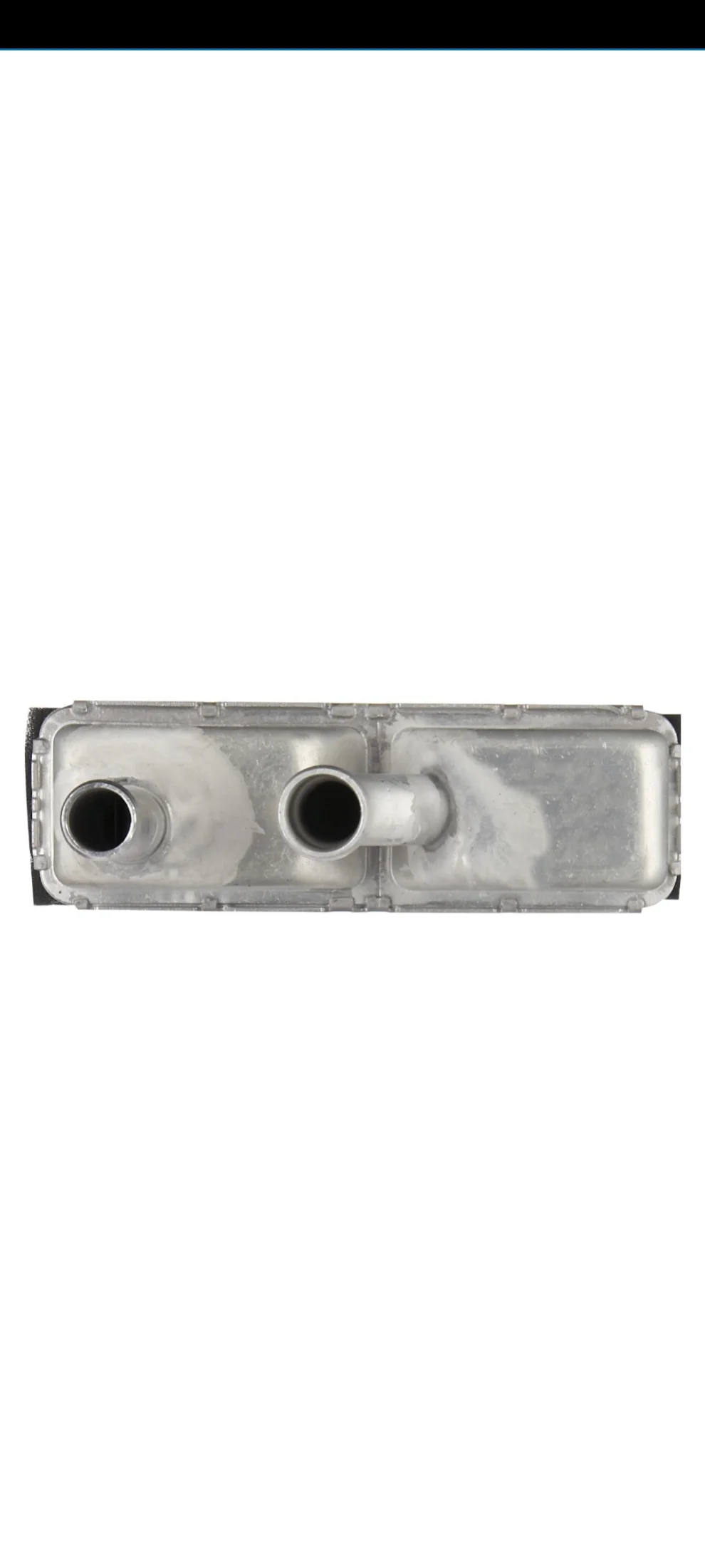

The aluminum aftermarket ones are all about the same.

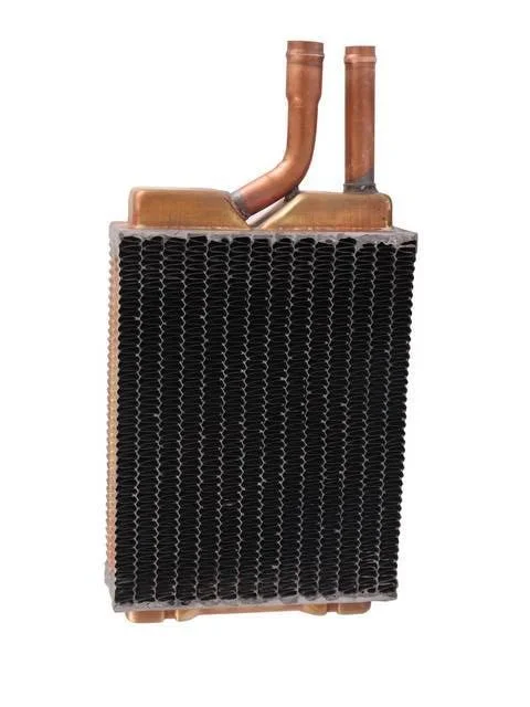

NPD does sell a brass repro. No idea on quality though.

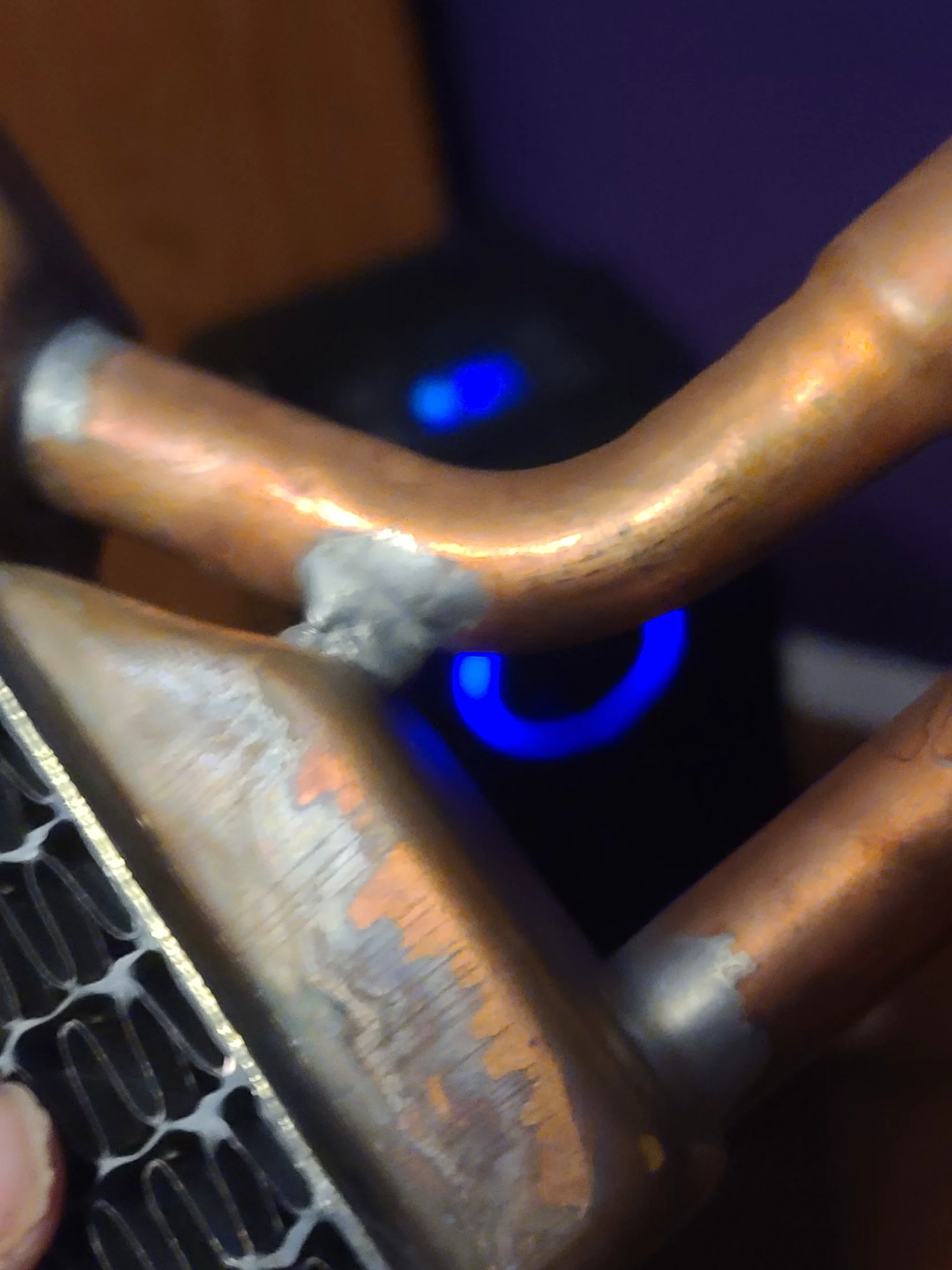

Would like to see NPD bring that one back. They soldered the on tube back to the body of the core which should have eliminated most of the failures on the replacement units. This was a common issue on the replacements as the offset in the nipped added another stress point to that piece and they typically failed where it was soldered to the core. Soldering it to the body at the bend would strengthen that and all but eliminate the failure.

yes you can see that in that pic looks more secure. I hope they restock it i will buy 2 ...or maybe just mod that Spectra Premium the same as the solder on the brass one...

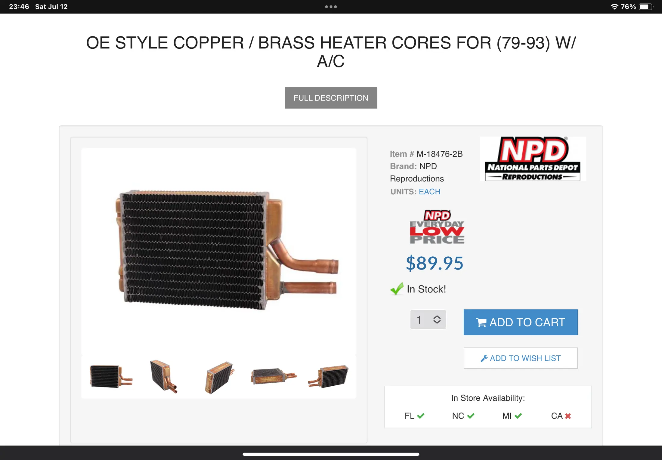

They were available a couple months ago. I almost ordered one when they first released. I think it's reasonably priced and they soldered a support to one of the tubes which was a weak spot on the original design.
If you can afford to wait, might be worth holding off picking one up.

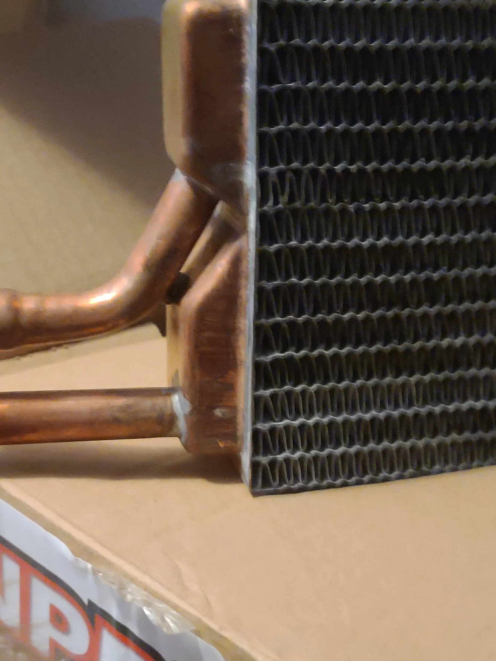

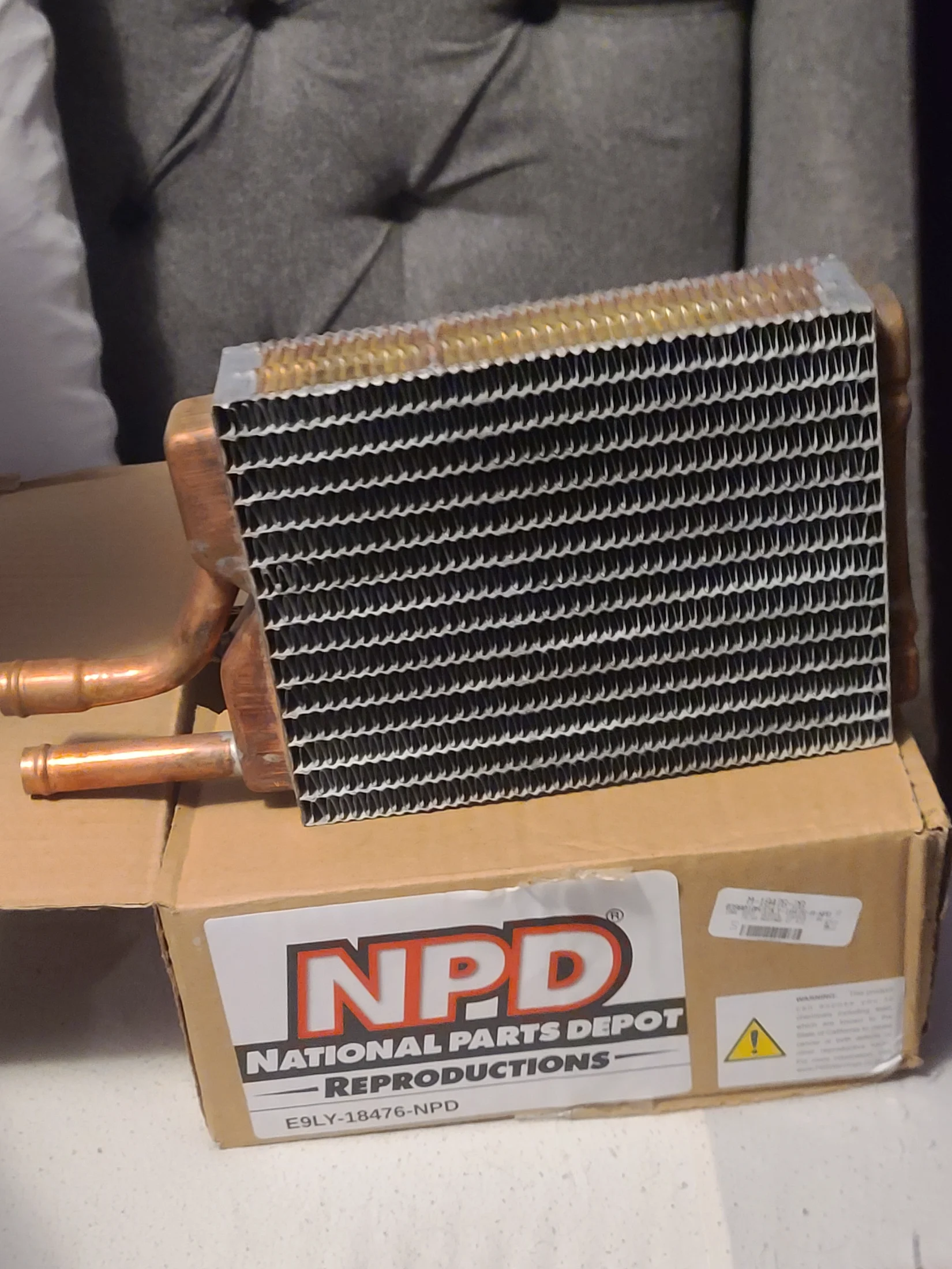

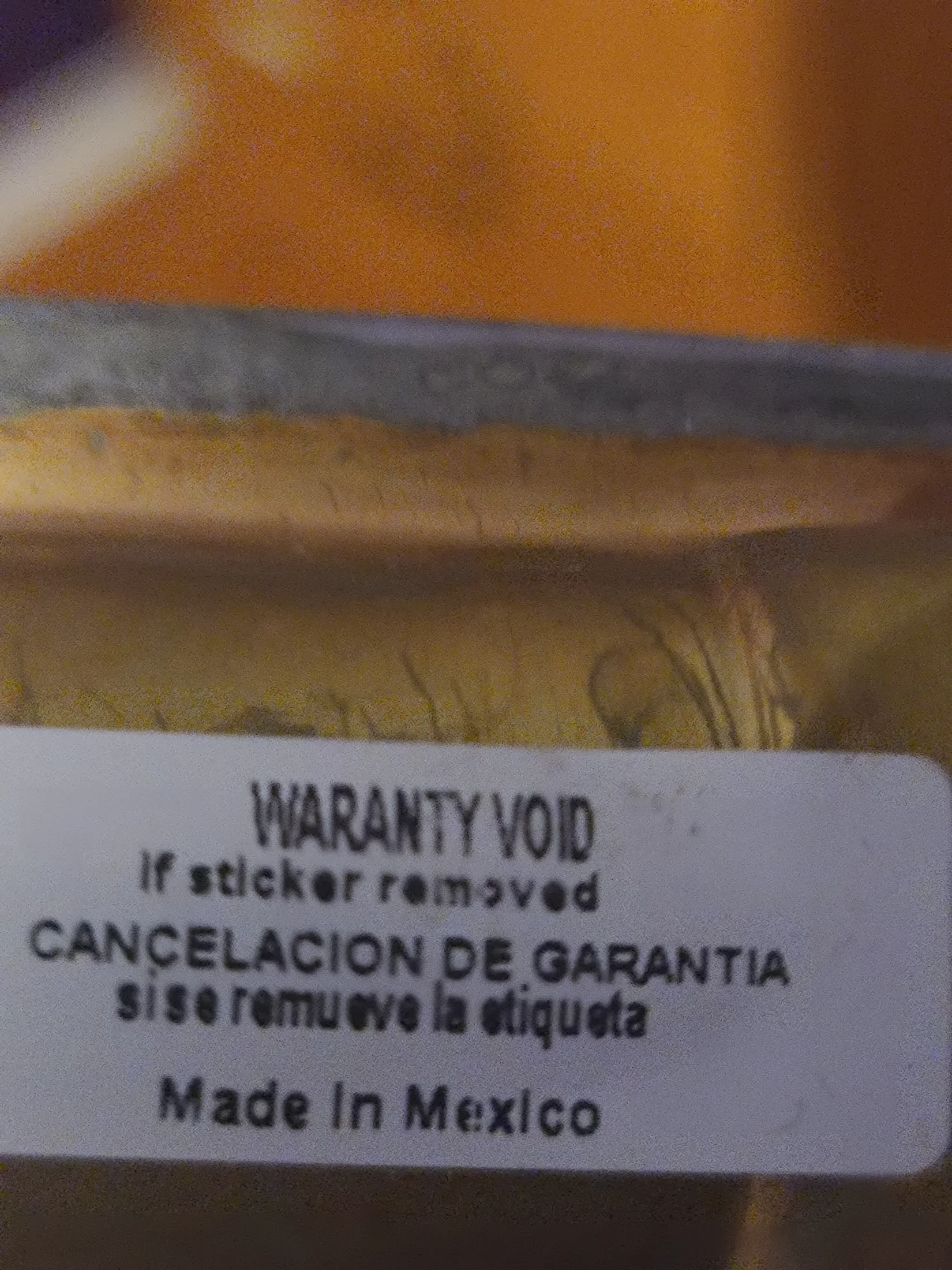

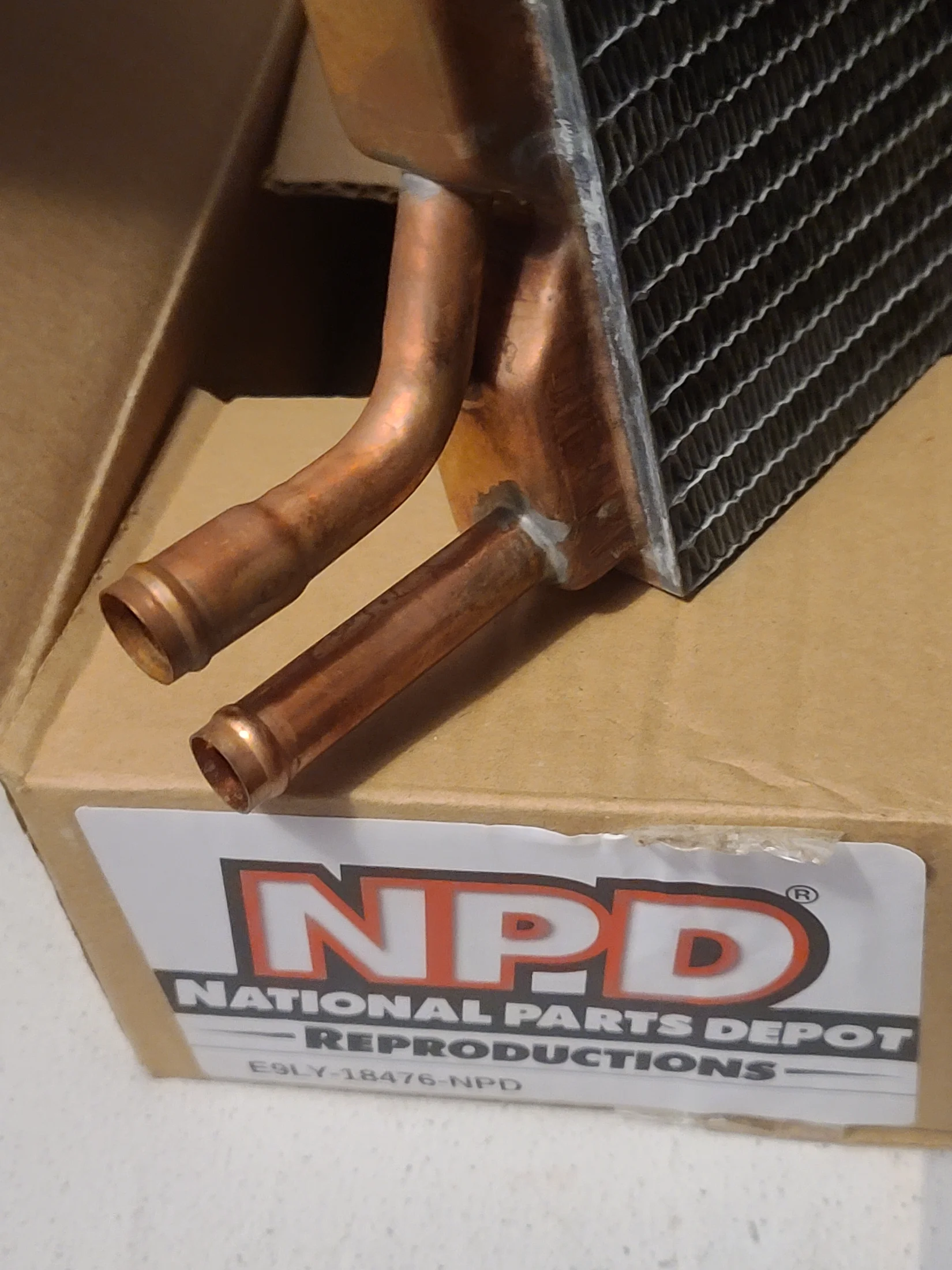

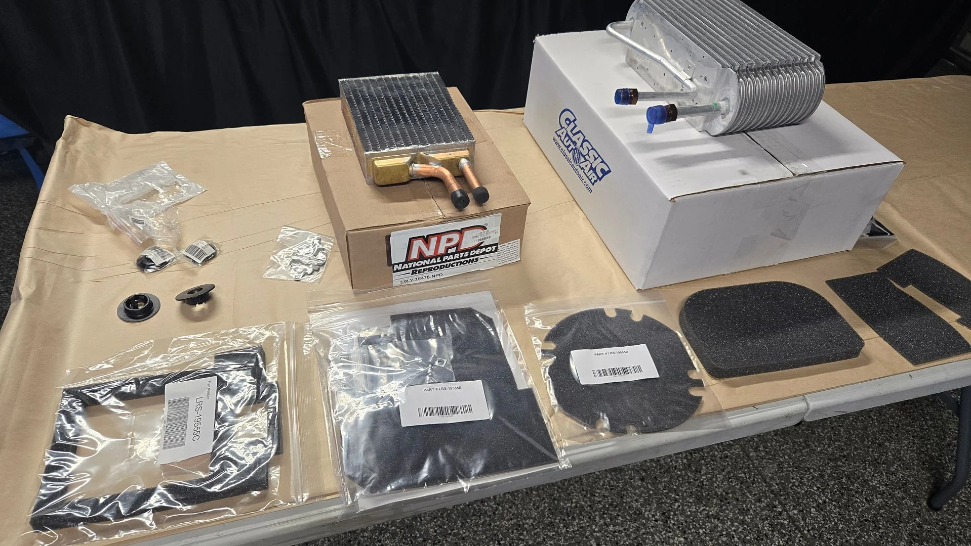

Just got both delivered to me today, and it looks pretty decent. Nice solder points, made in Mexico sticker on it lol I even got charged an extra 115.00 tariff tax, before UPS would drop it off , for a grand total of 339.88 Canadian or 247.80 US dollars for 2 heater cores in the same box shipped to me check out the pics. Next will be heatercore install time.
