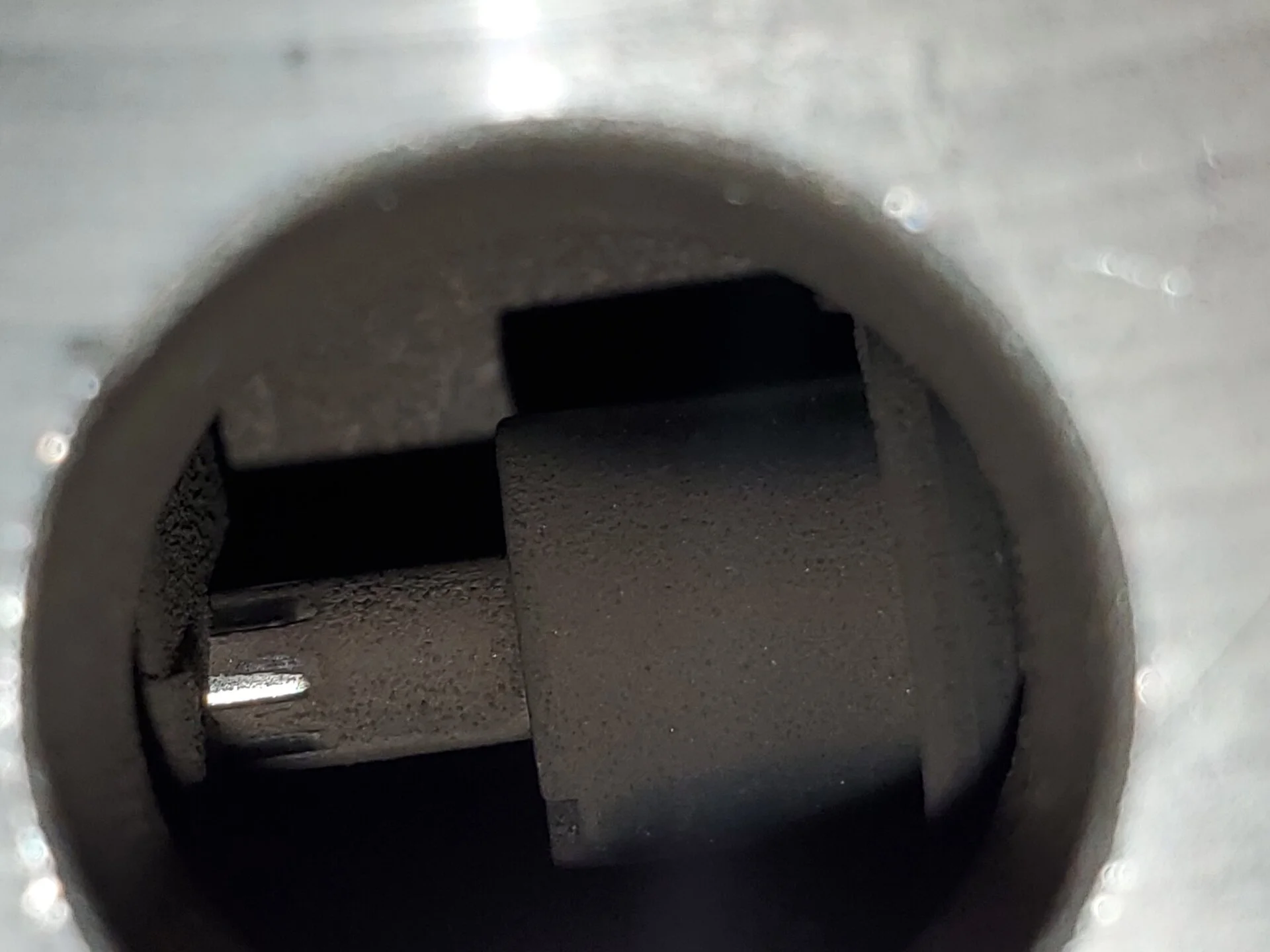

I'll take if off tonight and post a couple pics, before TB cleaner and after.
I say it is worth the cost and low level of labor to try a replacement. If the noise is gone while detached, and it functions with and without it correctly, that’s not like a random replacement of parts.
Looks a lot better, but sadly the issue remains.
It's present when the IAC is plugged in, and not present when the IAC is unplugged.

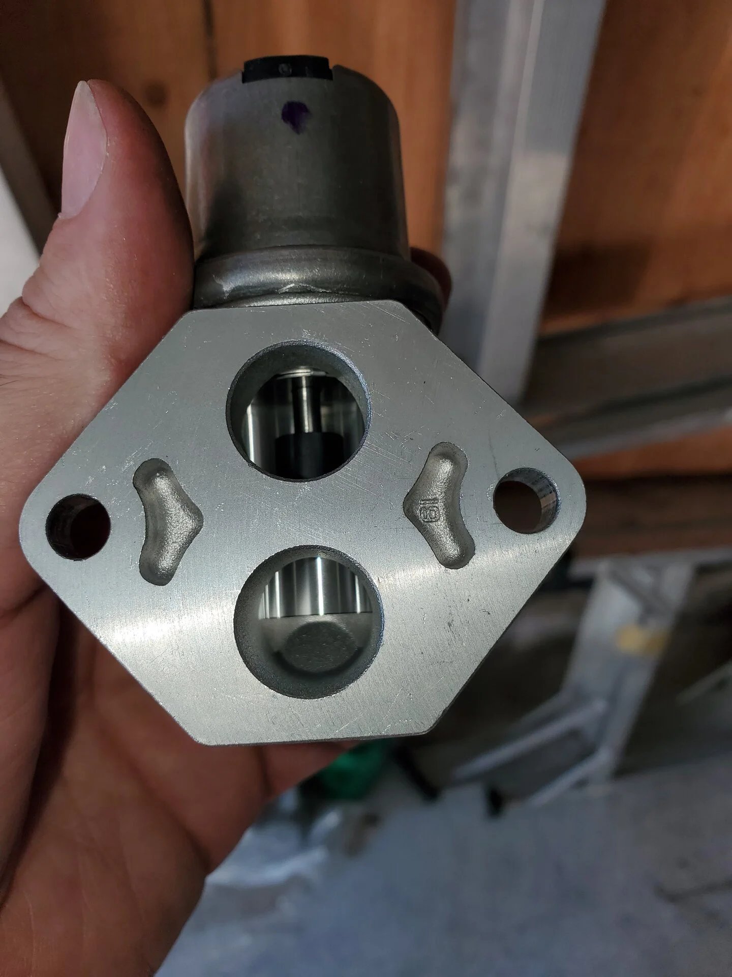

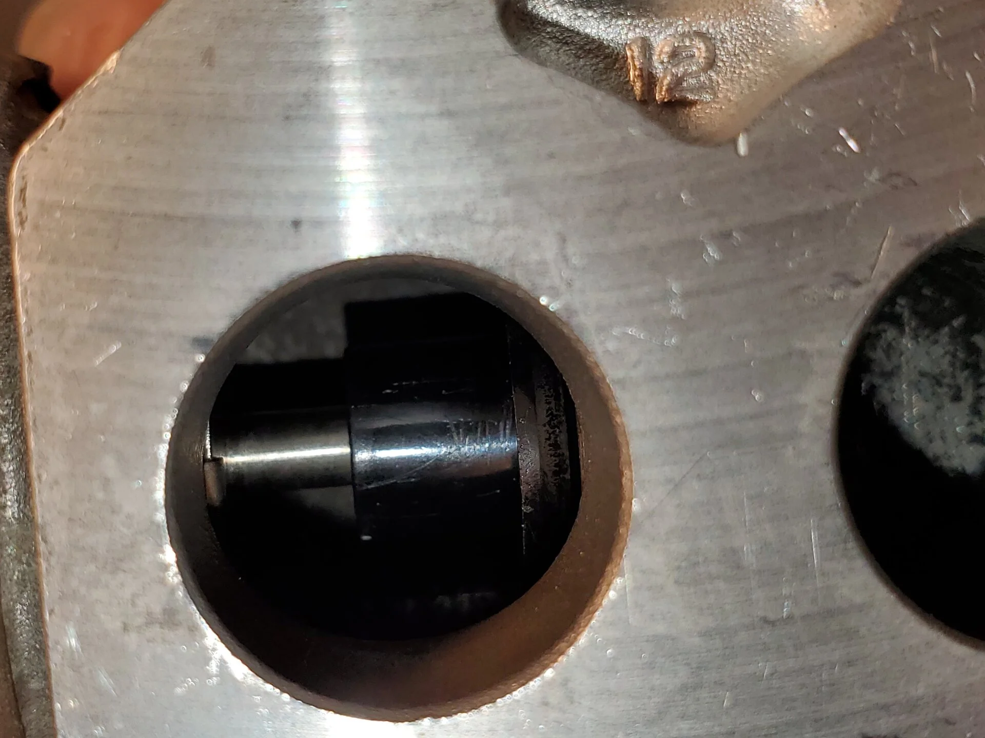

Part arrived today. Identical fit.
After installation....... the sound is 90% gone!
Firstly, thank you so much 7991LXnSHO ! You were correct in diagnosing.
Second, now that we know it was the IAC, anything i should check next, the remaining 10% has me curious why it remained.
