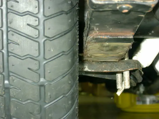

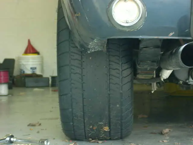

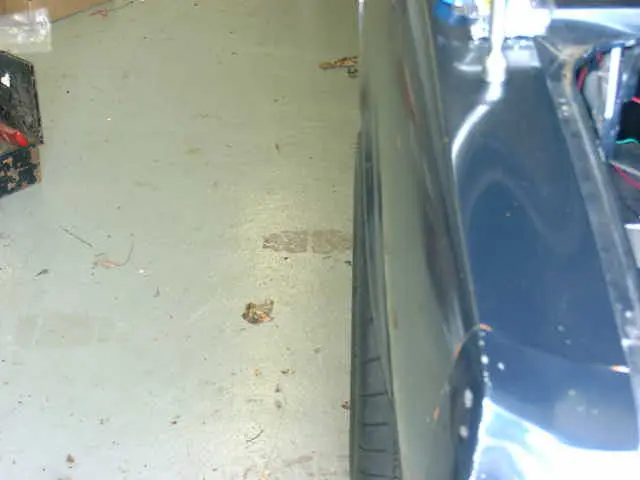

Anyway I took a chance and ordered a set of 275/50/15 bfg drag radials from jegs and had them installed on my 15x7 weld draglites today. I took them over to the garage and put them all and they FIT!

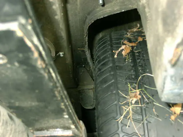

I did have to massage the inner fender lip as it was touching just a little. I'm also going to get a 5/16 or maybe a 7/16s spacer just to be on the clear side. On the outer fender there is NO complications what so ever because the tire is actually a 1/4 shorter over all. I think they would fit better if I had them on 15x8s so there wouldn't be so much bulge but damn they look good!

I'm going to put a spacer on there just to make sure the clearance is good to go as its damn close as it sits right now.
get a 3 or 4 lb hammer and give your car some love,We did or I did on my buddies and then we went on a windy road and not even a scrape.I would stay away from the spacer if your goona hook really hard with DR's.
It would take a lot of love. We did some pounding on it already and it still is barely touching it. I'm talking one of those huge spacers that have their own studs just a little one so there will be some breathing room. Do you still think that would be a problem with say a 5/16 or 7/16 spacer?

Yup, the funny thing was that it was the inner fender not the outer. I don't think 275/60/15s would have worked though. I'm going to try the 7/16 if the local speed shop has it. If not I'll have to call jegs and it will be here tuesday before I can go for a test drive. I think that will give me enough slack room to be on the safe from rubbing side. I'm just pumped that I got those big meats back there!

He's still rubbing... even with a little love to the inside fender.
Plus, a 275 tire on a 7" wide rim is horrible in every fashion from a performance point of view.
So, at best one can say at this point its functionable but not practicle.

I didn't mean to step on anybodys toes I just get a little touchy when somebody is trying the limits of something and people continually tell me that it won't work when they haven't tried it or seen it done themselves. Now don't take that the wrong way I'm not saying you haven't personally I'm just saying that not everybody that is telling me it won't work has.
I did measure the contact and its about 10-10.5 on the ground. A buddy of mine has 315s and he has 11.5-12 on the ground. I just gained 4-5 inches of total rubber over my 235s.
Also 2bav8 I did say it BARELY touches and when I say barely I might have been able to get a piece of paper through there but it wouldn't be safe that close. So I went out and got a 1/4 spacer which everybody I've talked to about spacers says that is a safe distance and now I have well 1/4 of room :D .
