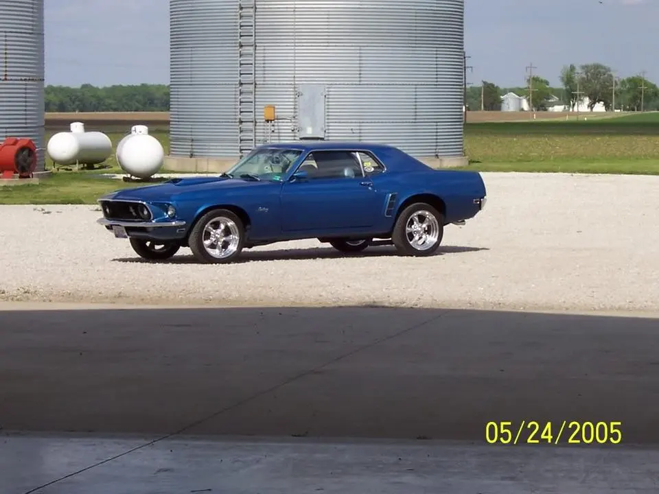

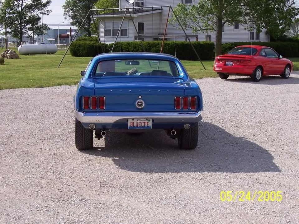

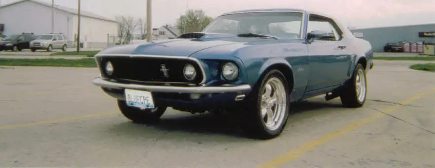

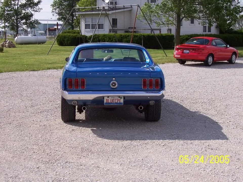

It's got a 306 in it w/ a C4 (2800 stall), 8" rear (hopefully w/ in the next 6 months a nice 9"). The car is not lowered but has a TCP rack which 10secgoal said he'd need to check out. The car will be lowered eventually but I think I'll wait til I get the turbo kit and see how much clearance I have on the DP before I go w/ the drop. Also I plan on putting some TTII 9.5" rears on as they're 17X8 right now in the rear w/ a 245 on the rear. 17X7 up front w/ 245's. Lips aren't rolled but I'll wait and see on that once everything falls into place.
Here's the car this would be going on....

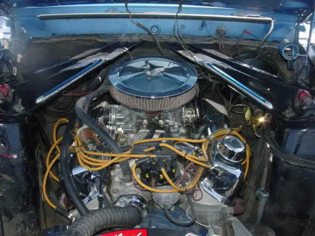

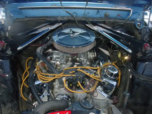

BTW The engine bay is dirty in this pic and is now housing an MSD distributor and also has no power steering pump any more. Also the battery is being relocated to the trunk to clear up some more room. The tower bars will also be replaced w/ some sort of tubular type bars.
The rear normally doesn't have that much height on it but after being in storage the air shocks had settled a bit and so I aired them up all the way for awhile so they could regain their seal. The rear on a normal day sits about an inch lower than in the pics....

BTW....when IM'ing 10sec he noted that my CR may be a lil high at 9.5:1 so I may have a good friend port the heads a bit to bring down the CR to around 9.0:1 or so.
I'm sure they know some good ways to bring down the CR as they build drag cars when they're not restoring old mustangs or working their everyday jobs. This is the car they built for themselves....first '05 glass body....514 block....super fast. (4.2 in the 1/8th).....

yeah, dont lower it till the kit is on, mine MUST be raised at least a inch:notnice:
and if you decide to get new tires, either get a drag radial or MT 26/11.50/17, youre gonna need them:nice:
my 275 tires(Kumho,not the best) are useless with anything past 1/2 throttle, while its fun, its not exacly safe in the wrong hands:(
