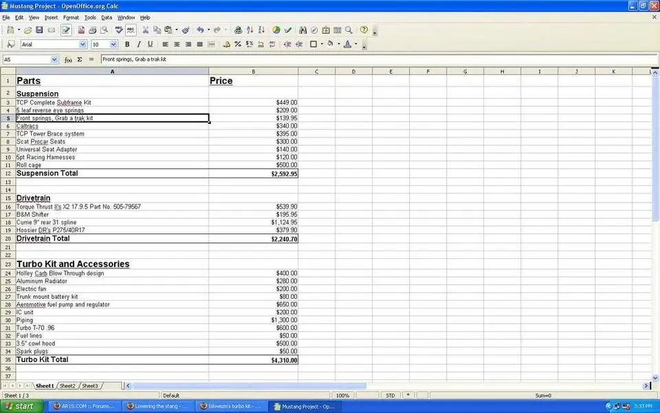

God this is gonna be expensive. 10sec....I hope you're still alive by the time I get around to ordering the kit :p
Here's the spreadsheet.....:( And to top it off that doesn't even include labor time or shipping costs....****...

Well...that's not including all the **** I've already done to the Stang in about 8 years. I agree mine's probably easily in the 30-40 range and growing. Frickin ridiculous. Well I won't tell your g/f if you don't tell my fiance. Deal? :p
