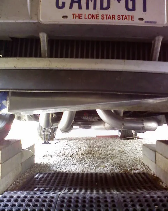

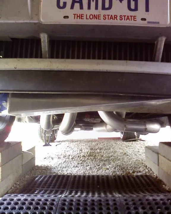

^ WOW awsome setup! Ill get you some pics as soon as we install it...but I do have a picture that is not in this thread. These pipes have the waste gate flanges welded in and are ceremic coated, but you get the idea.
Wow, your running the piping UNDER the sway bar?! What diameter is it? and is the car lowered any?
My piping is about even with the stock convertable subframe brace and I still freakout about smacking it on something. But my car is dropped about 1.8" in the front.
