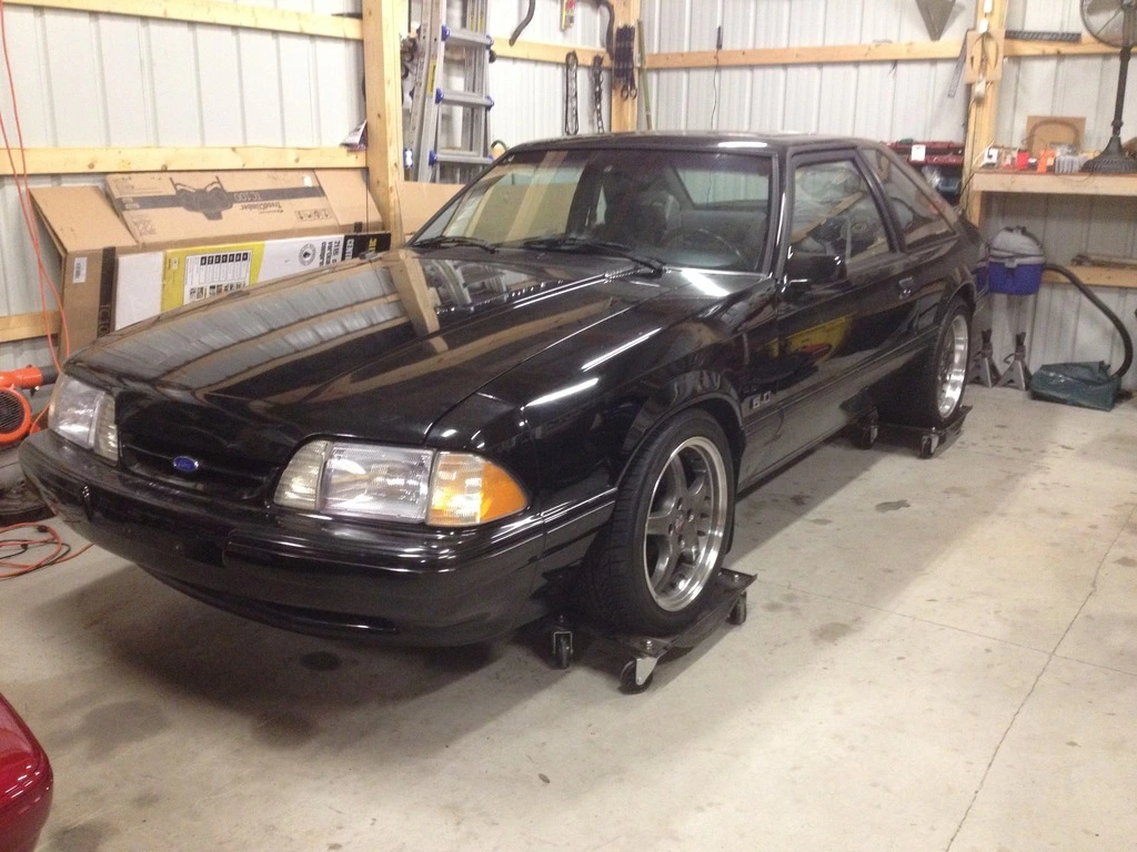

It idles very smooth and has great throttle response at no load. It's raining here today so no test driving for now. Timing set, no leaks, radiator fan set and ready for action.
Here's vids. 1) idle and throttle. 2) Idle A/F ratio . 3). idle vacuum

Hood is back on. Snow rolling in tomorrow so I'll have to wait for that to clear up before I take her for a spin. I've run it in the garage for about 45 mins now. 20 mins at 2000 rpm steady. All vital signs good.
