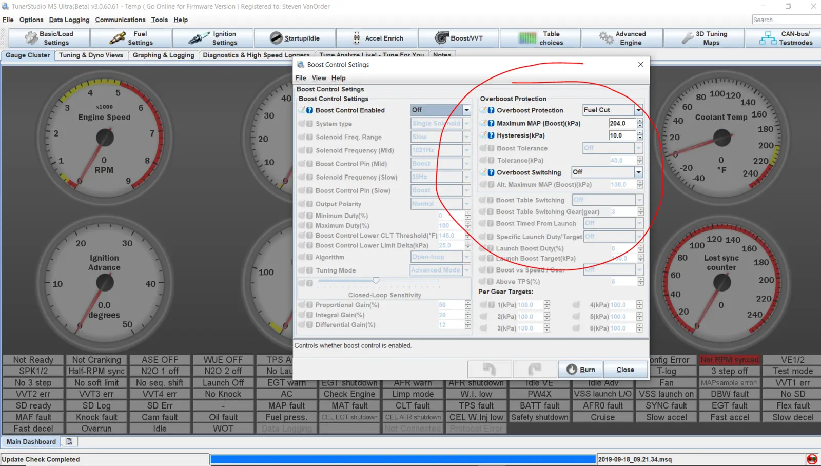

I found your problem... you are hitting a fuel cut limiter based on MAP...
during the pull it would have lit an indicator on the tuning screen labeled " FUEL CUT"
this is what needs to be fixed, along with a myriad of idle parameters.

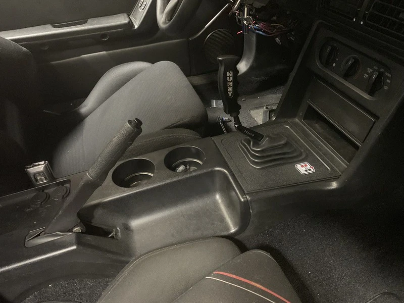

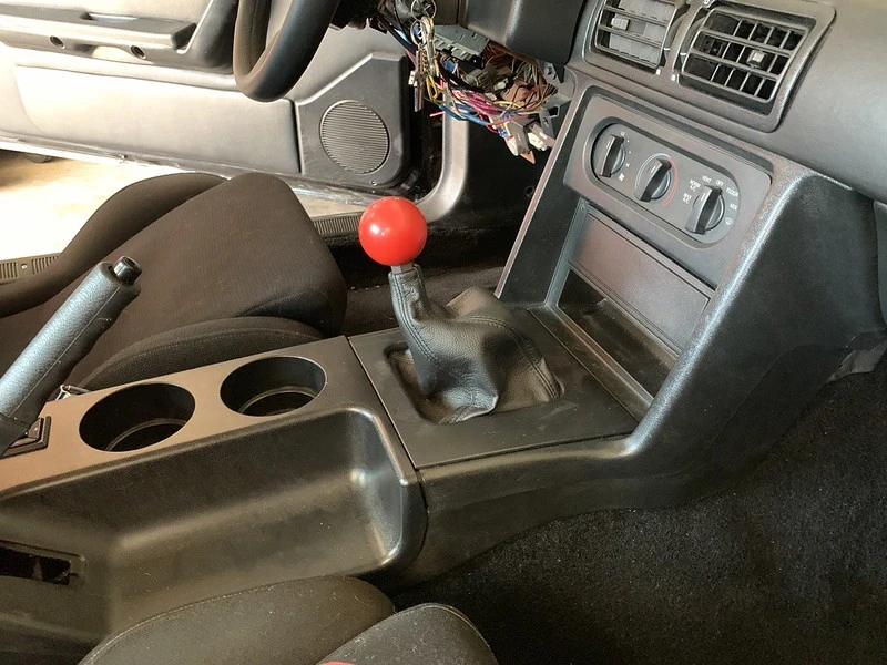

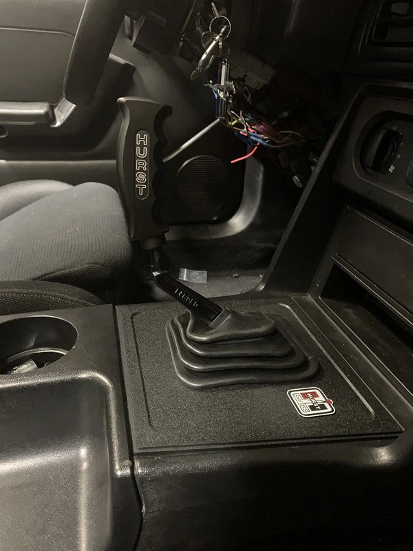

While I am trying to figure out the tune and the drive-ability of my fox, I wanted to do something different to my shifter set up since it is not cutting it for me anymore. It looks old and factory when my car is far from factory at this point.
I wanted a murdered out looking shifter set up. I got myself the Hurst plate and boot. I pulled my Steeda Tri Ax handle off to paint it black and then I put on the new Hurst black pistol grip handle. I absolutely love it! I think it looks wicked. Makes me a fighter pilot wannabe - I know the pistol grip is kind of a Mopar thing, but I love it. I originally had a silver pistol grip handed down to me from someone a couple of years ago and I did not enjoy it much with the stock seats and then I sold them off. Now I am sitting much lower in my Recaro SE seat and the pistol grip feels amaaaazing with the Steeda Tri Ax Handle. You know 5 speed is life!
Before:
After:
Hope I did not piss off any Mopar haters haha.

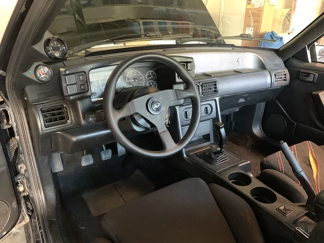

I am itching to button everything back up inside the car - need to find a good place to place the meth indicator lights then I should be able to button everything up and try to get the seats re-upholstered then hopefully I can rest easy for a while.

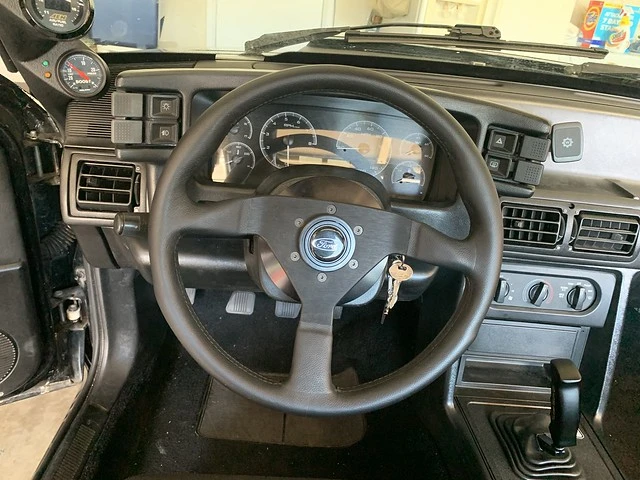

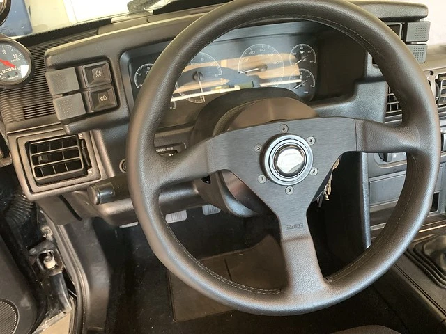

Is it just a monte carlo wheel?
edit:
Also, I don't recognize that hub adapter. I think the real adapter accepts the horn button (my car is on my lift and my kids are sleeping, so I can't look now).
If you look at all the pics in that ad, if I remember correctly the horn button snaps into the silver ring, not the wheel itself.
I could be wrong, but I think that's what I did. Been a while.
Thanks so much for chiming in on the horn button issue I am having.
You are correct, I did not purchase the momo hub adapter since I thought it looked pretty funny. I got the universal hub adapter from ebay, which looked pretty nice I thought - http://rover.ebay.com/rover/1/711-5...0001&campid=5335821607&icep_item=182608763647
It looks like the hex bolt is preventing my horn button from being able to sit recess into the hole. I'll be damned. Will have to get creative or suck it up and swap it out to the momo hub adapter. I will try with different bolts or try to dig out the horn button internals so it can just be a "cover" rather than an actual horn button. I have not had a horn for as long as I can remember anyway.
I ll need to make sure I have the correct ring for the button to snap into though.

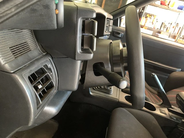

If i'm reading right, you used a momo wheel on an air bag column, correct?
I don't think it looks right no matter how you slice it. I considered many options to use the momo wheel on my air bag column and found none to be good.
IMO, swap in a tilt column from an older car. It's not really all that much work and the column cost me $100 on ebay.
Do the momo adapter and a tilt column. It's worth the effort.
Well, I actually love how it looks right now. Just that I am unable to put the center cap into the wheel with this adapter. I reached out the seller who made this adapter for me and turns out they do sell a 12mm ring spacer that will help me be able to install the center cap. I should have asked them first of all.
I honestly dont think momo adapter looks right being so small and funny looking. Feel free to call me weird :D
However I wanted to ask why tilt column? Assuming thats because the momo adapter will only work with the tilt column?
See pics below of my adapter, I think it looks rather good! Pending arrival of the 12mm spacer ring so I can properly fit my ford center horn button.
I guess I just solved my center cap/horn button issue with the new spacer ring coming. Thanks all!

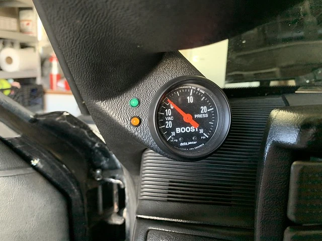

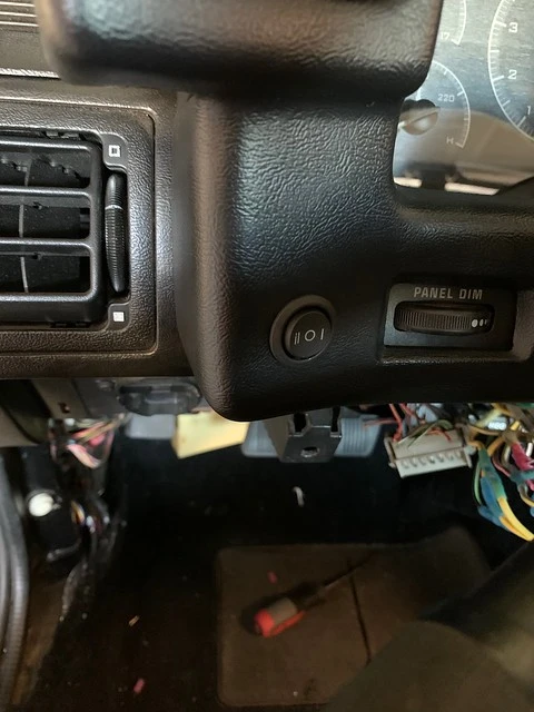

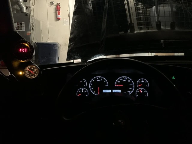

Worked on the car some more yesterday: Installed the methanol activation light (green) and low level light (amber) on the bottom gauge pod. Also installed the Dakota Cluster switch next to the dimmer switch. Looks right at home I think.
Finally was able to button up the interior after installing those stuff and now my OCD self can settle down haha
Still cant get over how pretty the Dakota cluster is at night time. Too bad I have not done much of night time driving.. Hell, I do not drive this car enough overall yet. Need to upgrade the lighting in my boost gauge to white led so it should flow better with my new cluster.
