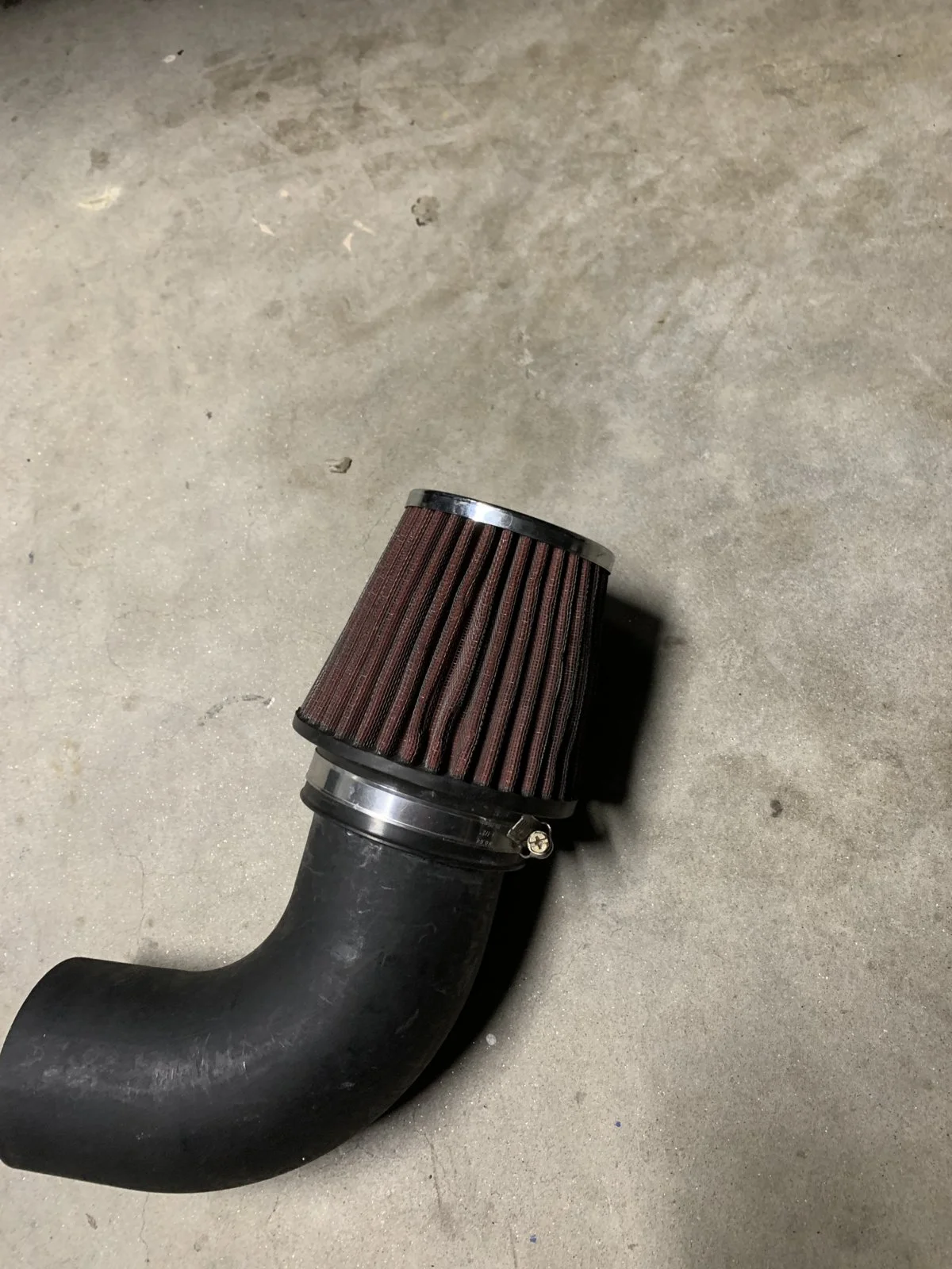

I definitely have a filter that is too small.I am wondering what is the ideal size universal filter should I get? I only can tuck it under the fender unless I relocate the Meth tank. Is 9" universal filter going to be good? 9" K&N Air Filter on eBay
Edit: Isnt it better to have the filter mounted in the fender well anyway? considering it probably is tad bit cooler than the engine bay? Not sure about the flow though... I have not gotten around to installing the wheel plastic liners back in yet so I suppose that is going to give me some problems. I can always keep leave them off.

Here is my lawnmower filter :cool:
It is 4.5 inches tall and 5 inches wide at the base. It looks like I could do 2" taller filter before it will hit the passenger front fender. Will 6" tall filter suffice or do I need to reroute my CAI?
Edit: this is probably the biggest one I could fit under the fender.. 6.7" Tall Spectre Filter Do I go for it or reroute the CAI to under the hood and run 9 inches tall filter?
