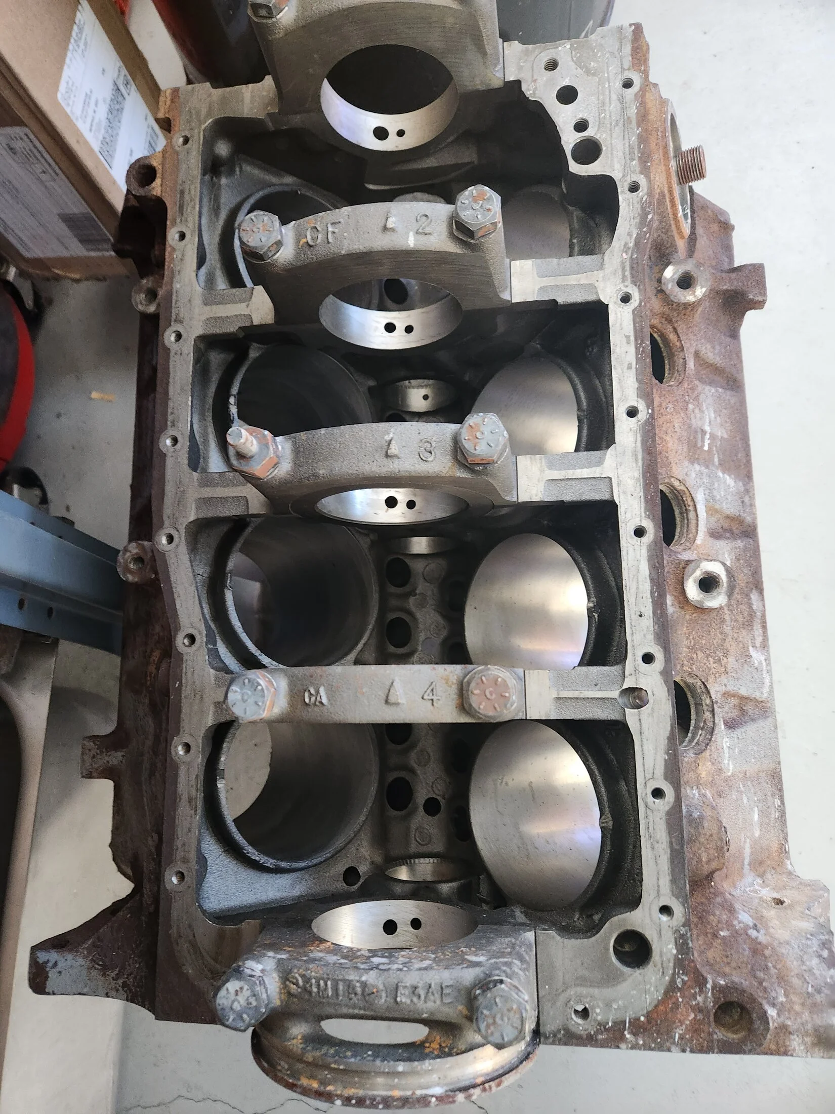

Well after a price and lead time of a Dart block it just is not in the cards now. Besides cost and the 6-8 month lead time there is also reluctance in some of the block is the only Ford thing left besides the obvious architecture. Oh and the front cover and distributor.
Anyway I picked up on Saturday a stadard bore 1968 302 block, it was out of a Cougar pulled in the mid 80's. It still had the factory Ford bearings in it dated 12-67. The only concern is #1 main was a bit rusty in the register, main cap was away from block and there is a fair amount of rust hopefully it will clean up with a light line grinding on the registers and line honing.
What's interesting about this block is the main bolts are NOT threw holes they are ALL blind. I could sware the skirt area looks thicker. All the head bolts as well from what I could tell. I could not remember if my 1992 302 had blind head bolt holes or not. Eventually I will get them side by side and also scale them. So if this block works out I will be building back a 331 only this time internally balanced. If this block does not work out, I will keep looking!

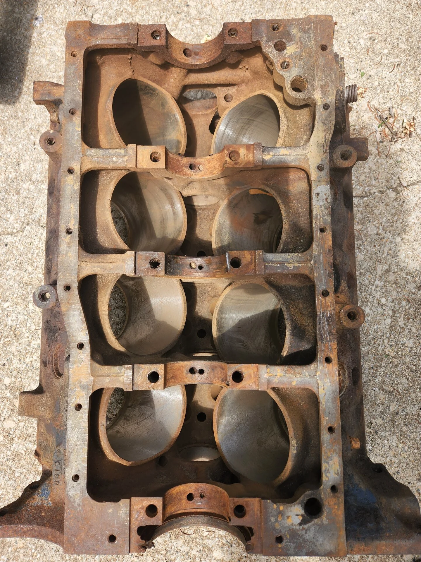

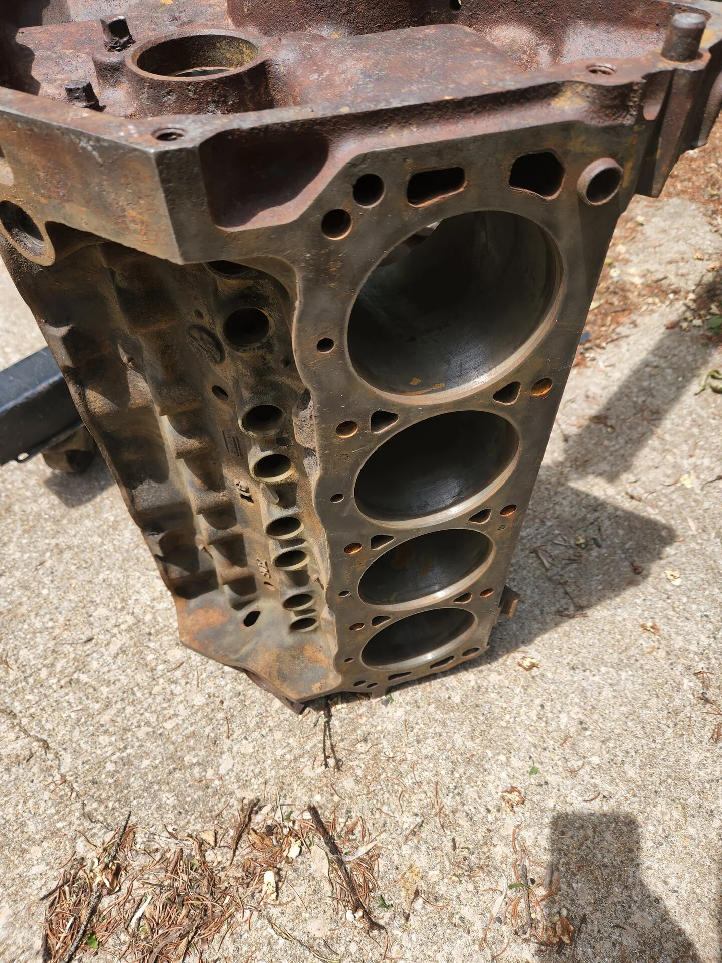

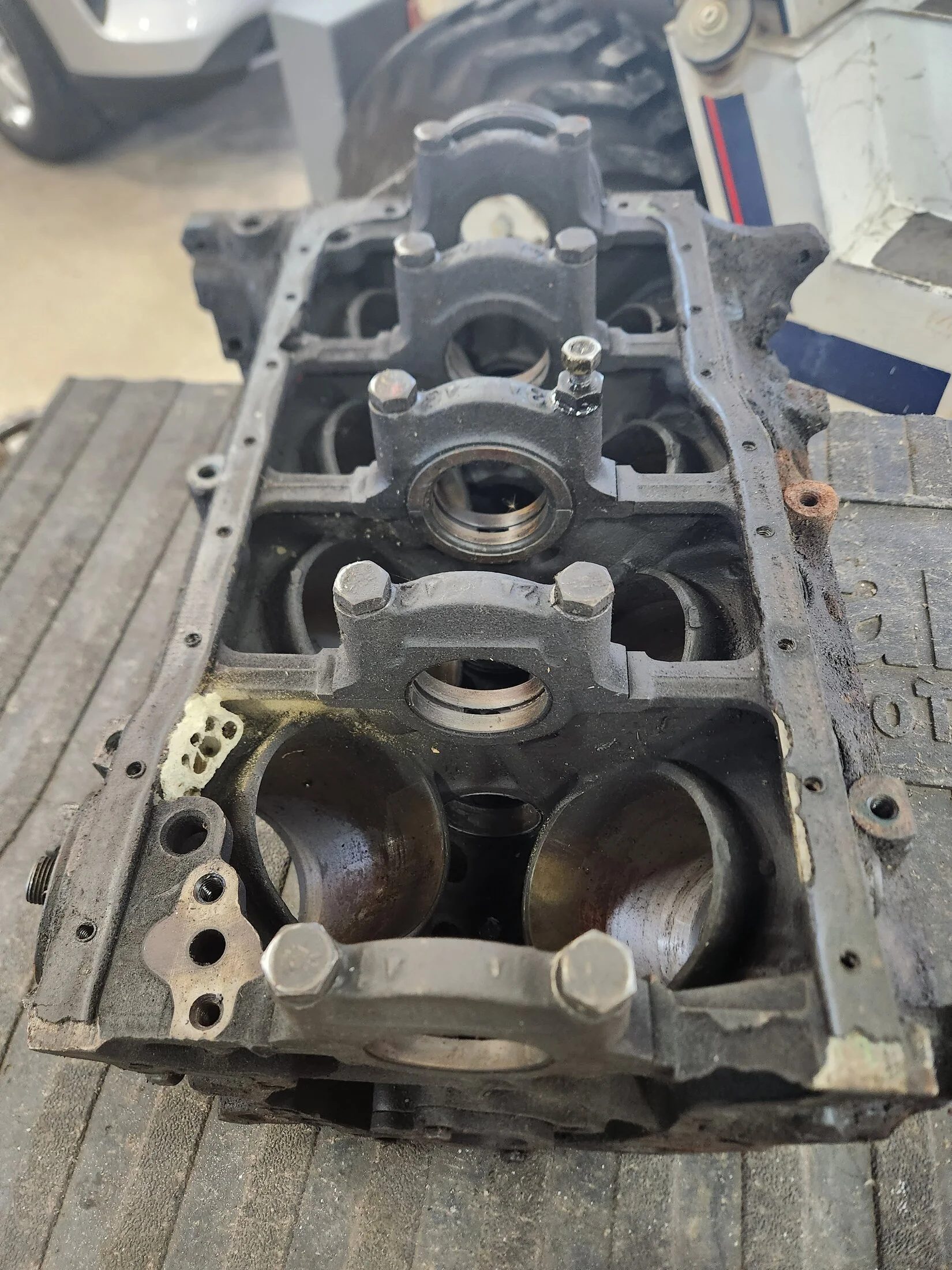

Well I have 2 blocks unless dad sells the 351 on me...
I picked up a 1978 302 std bore.
Sending it to the machine shop to be burned, shot peened and magnefluxed.
The alternative is to build the 351 to about 370-380cid, I don't have to convert to one piece rear main. I will have to buy another intake.

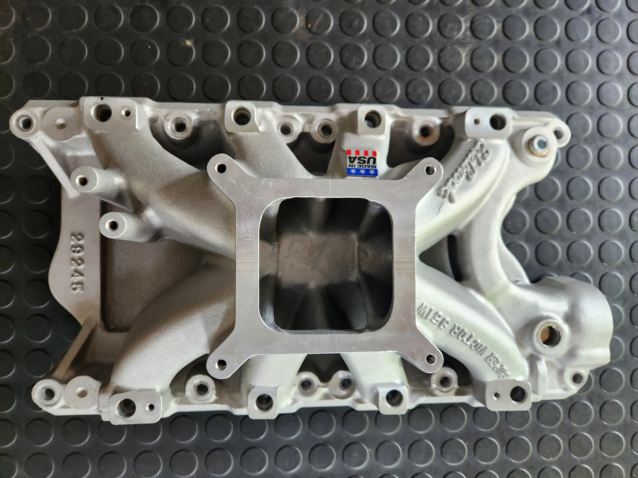

Well...I went 351. Sold or selling all the 302 stuff, block, oil pan, intakes as I have 2, cam last fall. I went round and round with the machine shop, wanted to build a 358 then looked at 383. Finally landed on a 408. Really wanted to stay shorter stroke so I dont kill the TKO600, i believe it is rated around 400 ft lbs.
With my 58cc heads we could just not find shelf pistons for 3.75" stroke. Picked up a EFI Edelbrock Super Victor intake, also landed a set of 1 7/8" Kooks headers. So things are moving slowwwwwly.

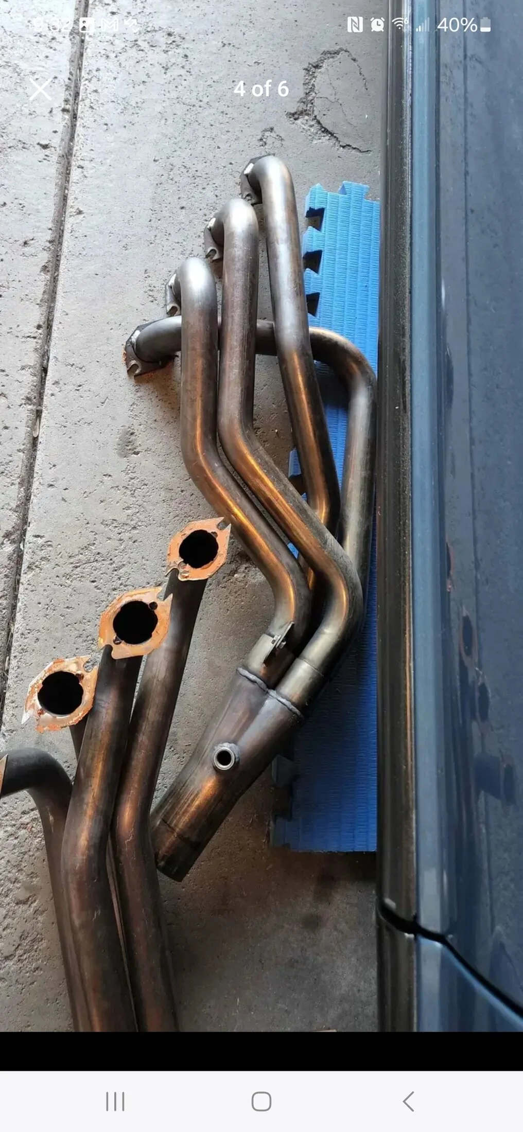

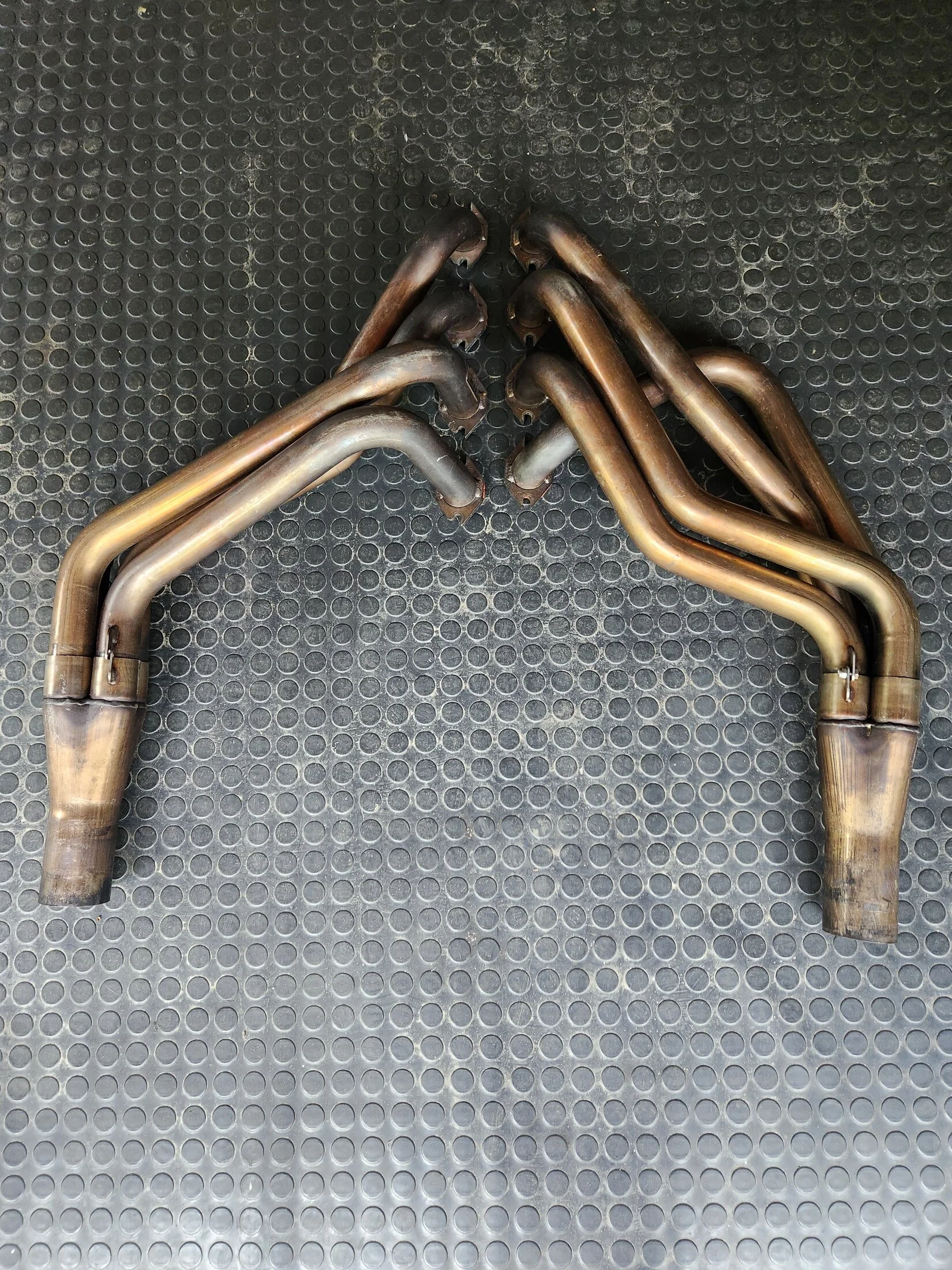

Headers showed up today! Used intake came last week. The FB group 9.5 parts is paying off!
Still need main studs and oil pan. Going carb, but might have future plans for EFI.

What did you pay for the Super Victor if you don't mine me asking?
HotFox
Jan 5, 2009
1,068
700
164
SE Michigan
May 17, 2024
#220
  • May 17, 2024
  • #220
525 shipped
