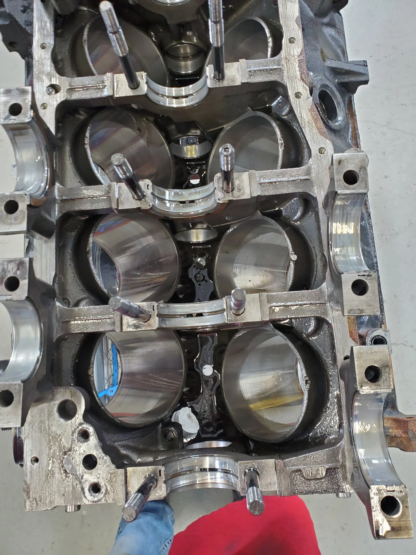

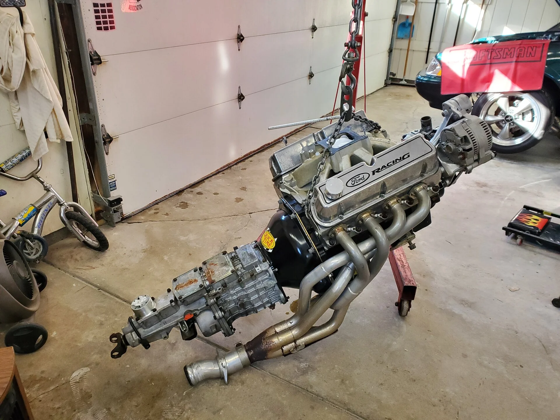

Car developed a rattle on a way to a car cruise last fall. After ruling out the rockers, I knew I needed to dig deeper a full tear down was in order, besides the short block has been together since 2009. I belive the rattle was cam end play that is now more noticeable with cam chain strech, it was like .08-.1.
I finally got around to tearing it down this spring when the weather started to break. Well after tear down everything looked really good besides cap walk and one wrist pin that was alittle tight in a rod but since it was floating no big deal. Rod bearing looked so good I planned to reuse, mains had some wear which was expected from a external balaced assembly turning over 8K. I ran everything to the machine shop to have everything maged. Well first he called and said my eagle crank is cracked in #2 main. Finally last week he got around to check the block and it is cracked in #2 bolt hole into the webbing.
So I am at a cross roads, I have always wanted to build a dart 8.2 deck 4.125x3.25 basically a big bore 347 or 363. Not sure if I want to spend the money with my garage project going. I may just buy a late 60's 302 and put it back as a 331.
