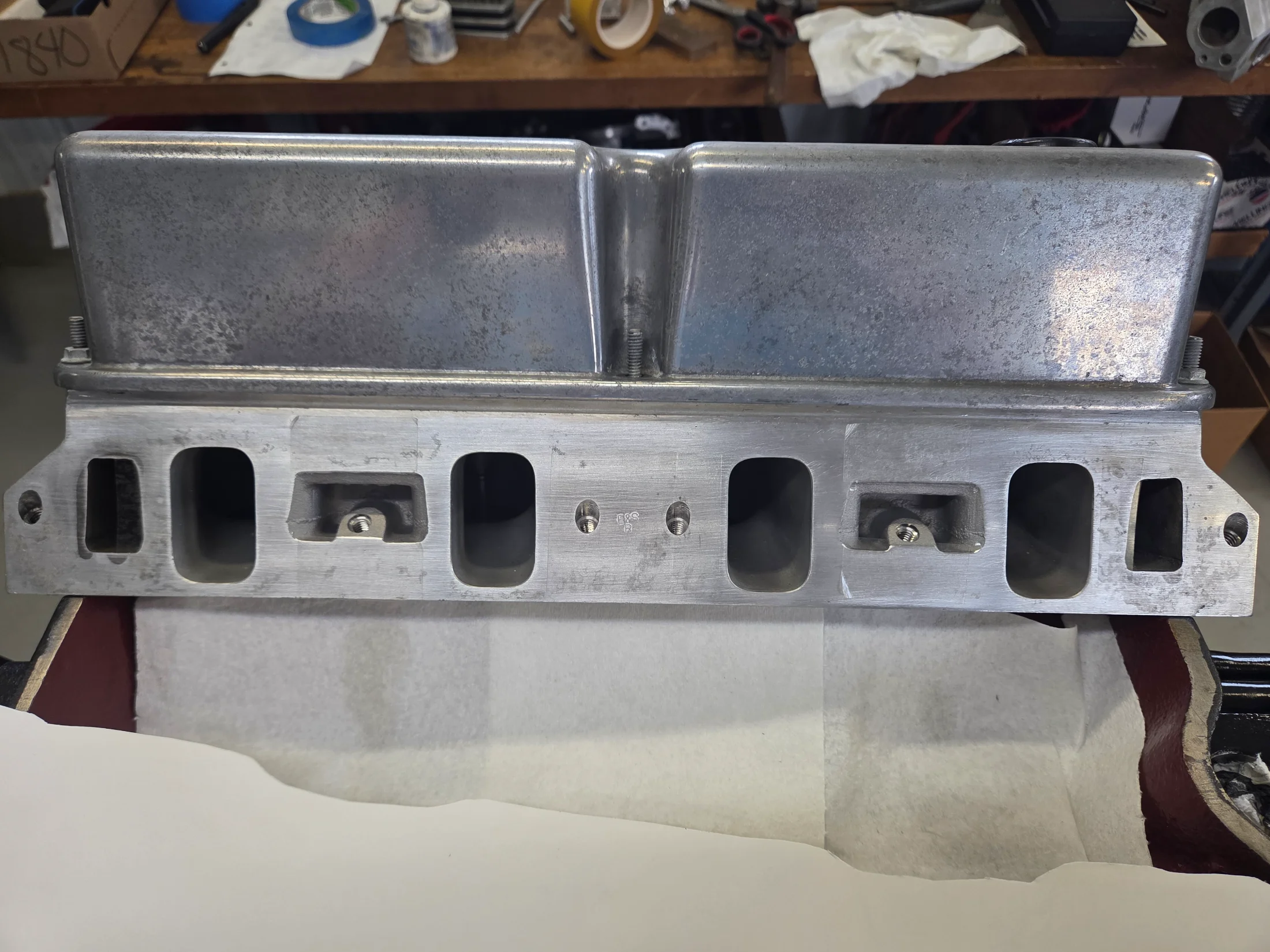

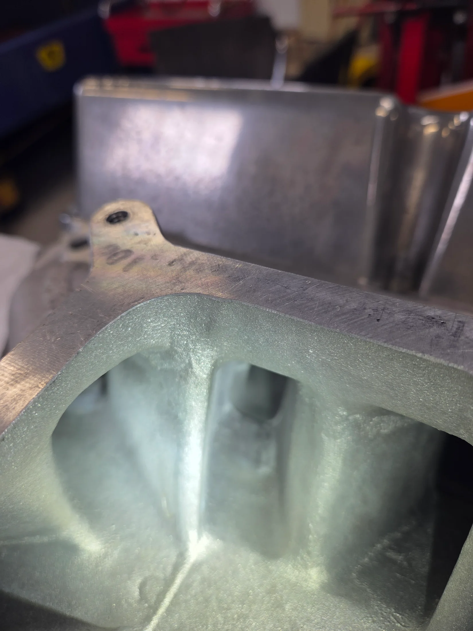

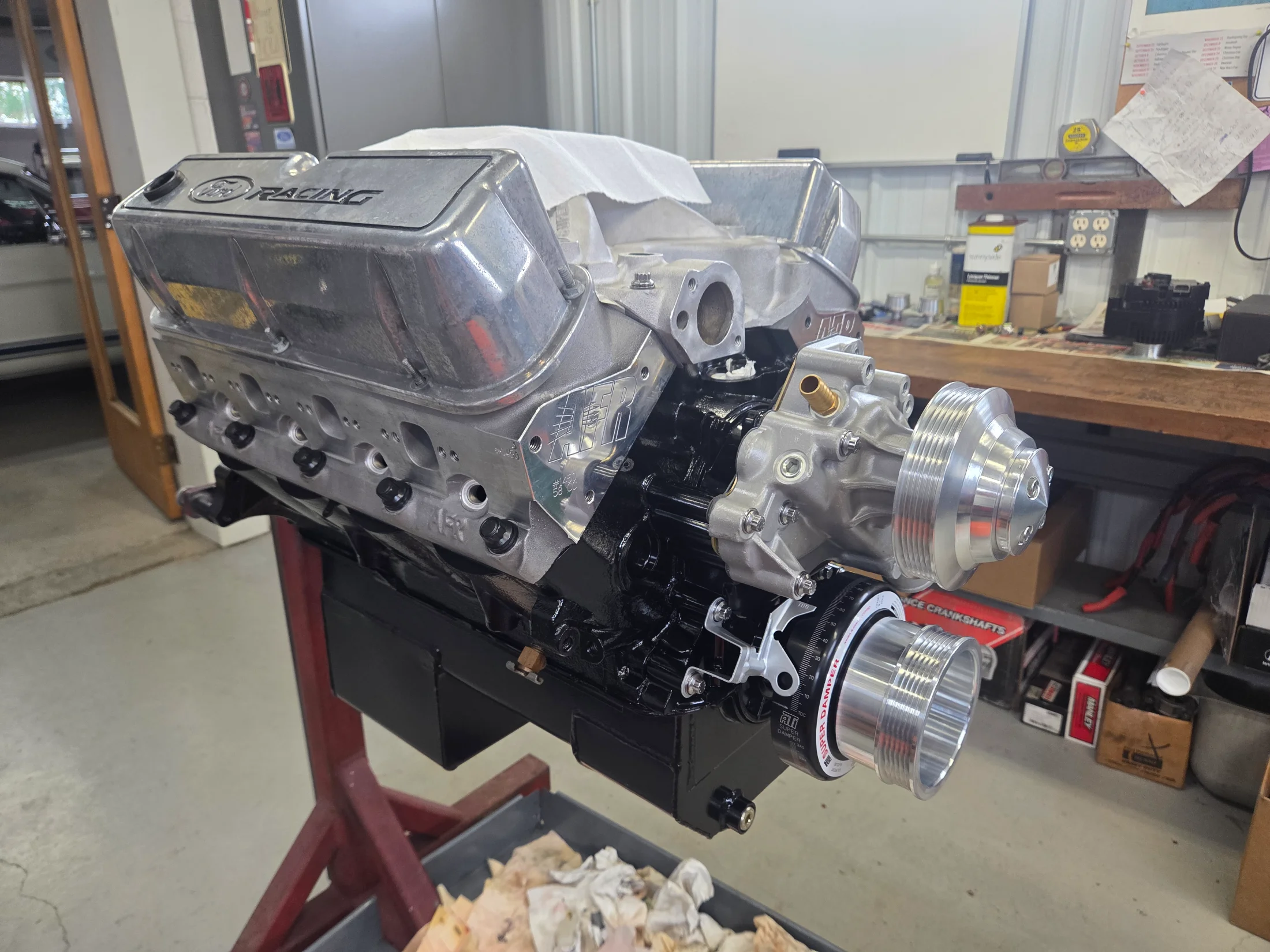

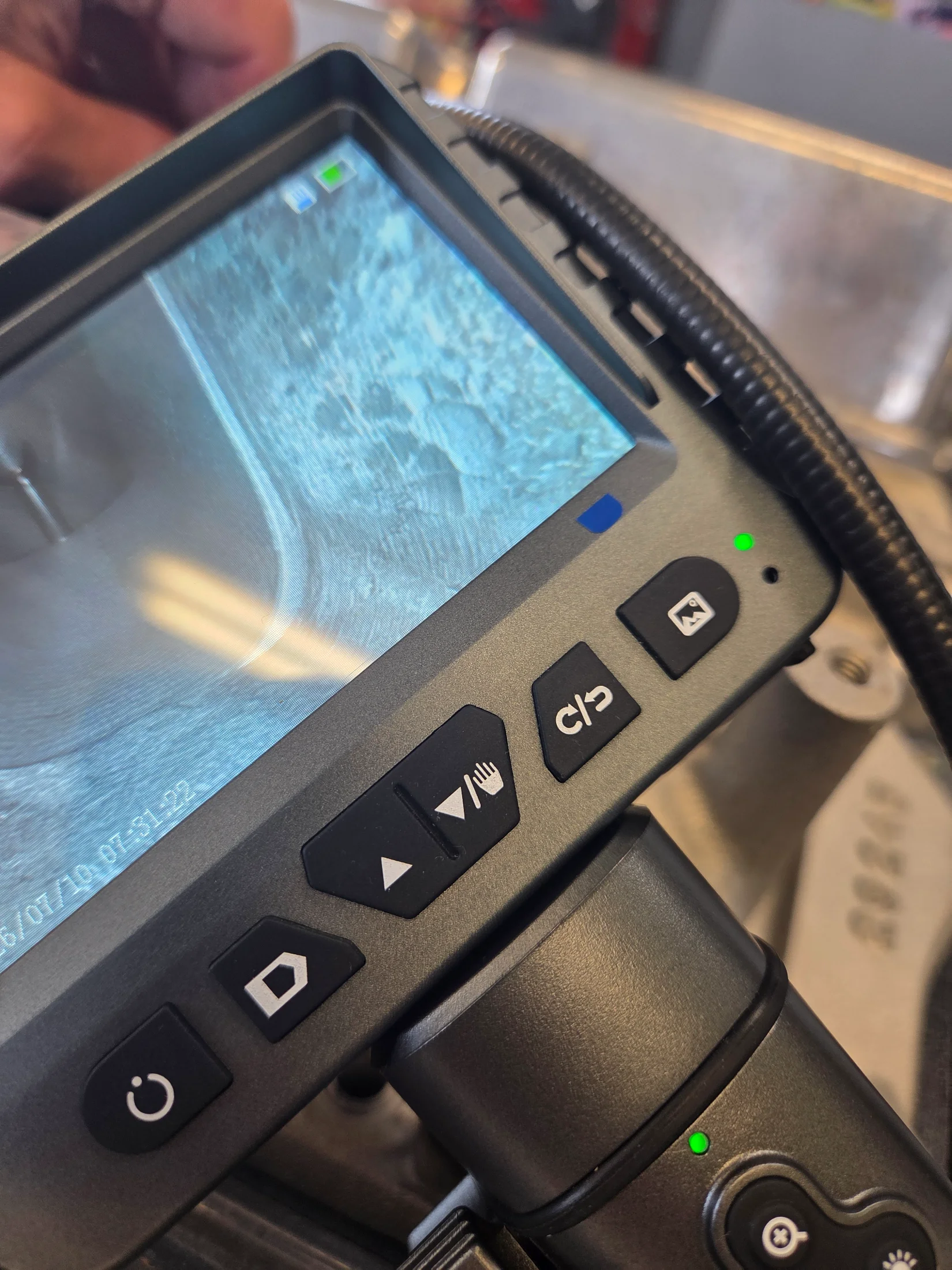

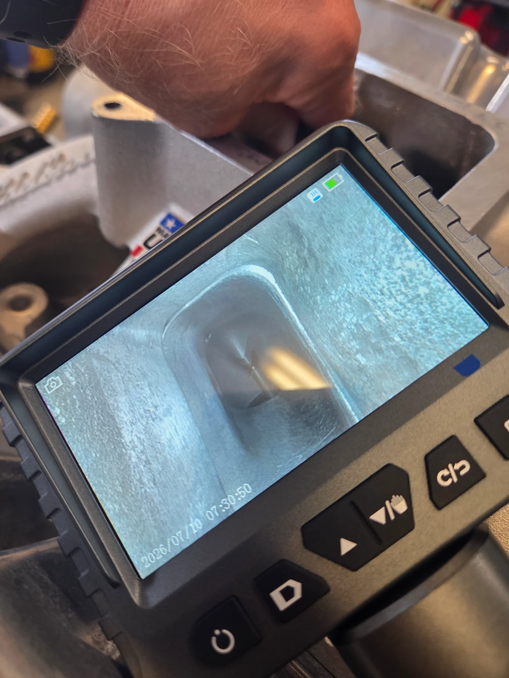

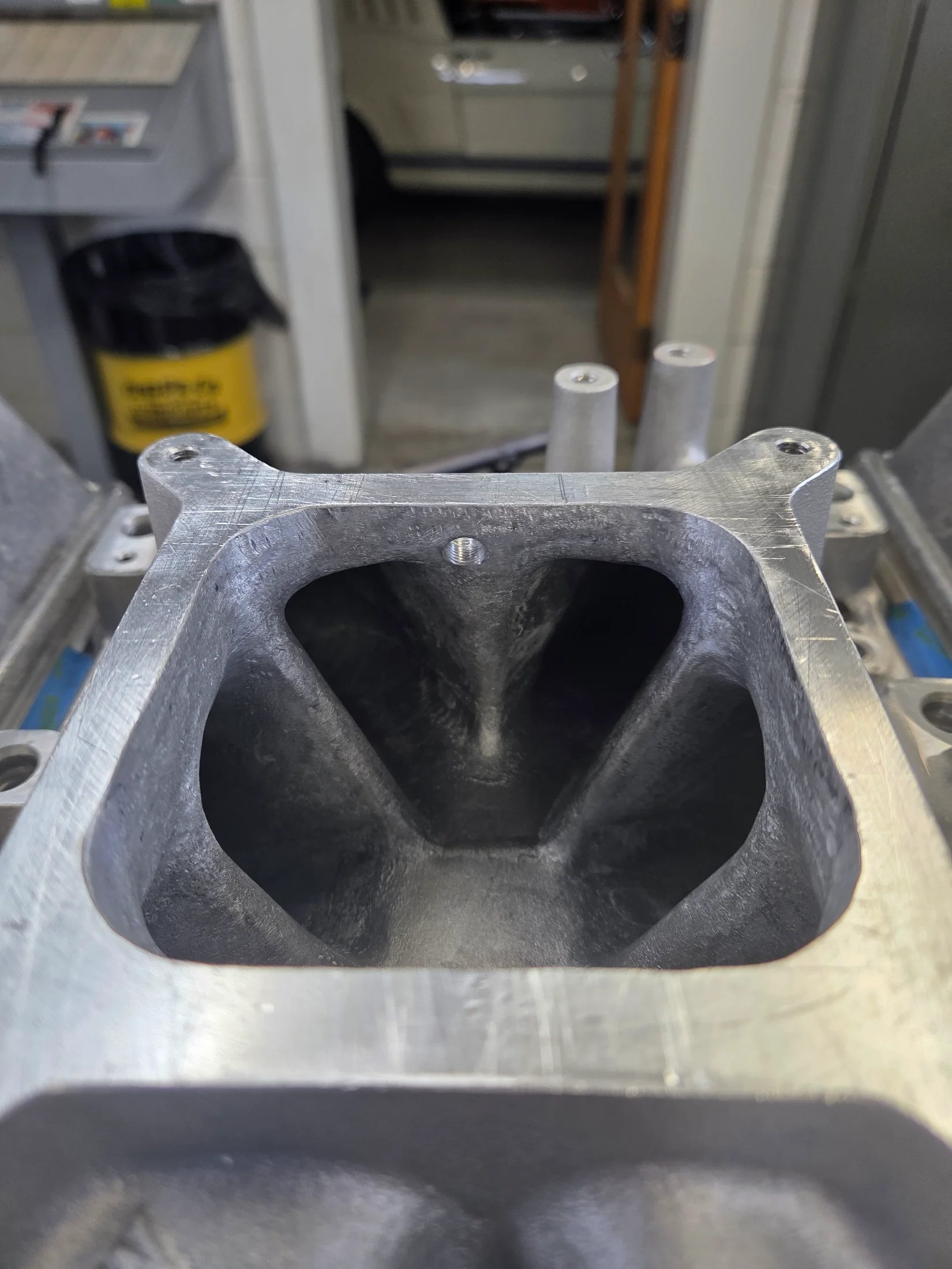

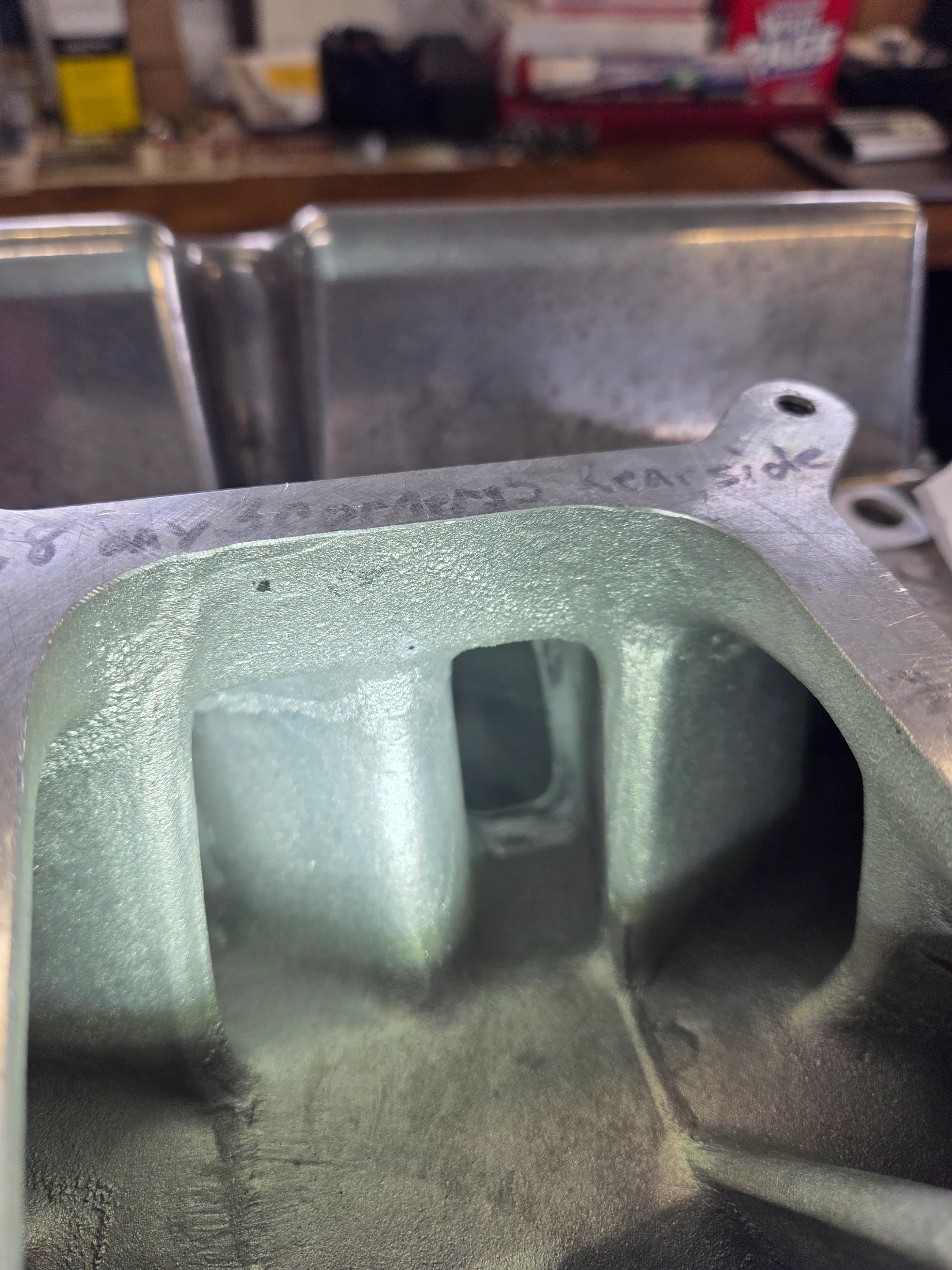

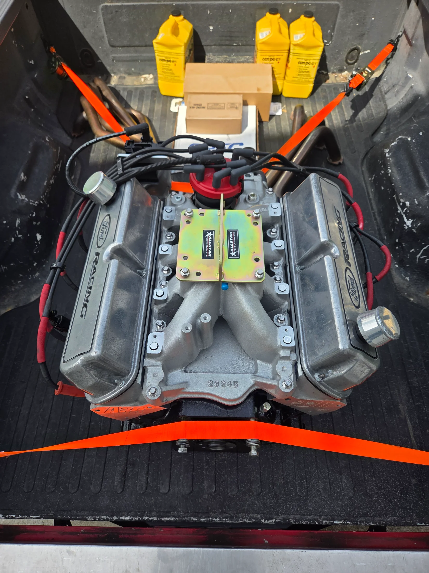

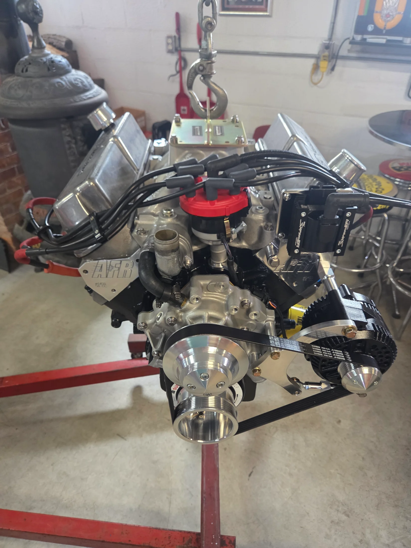

Alittle more progress today. Intake ports are ported and properly fitted. Not perfect but much better then my earlier post.

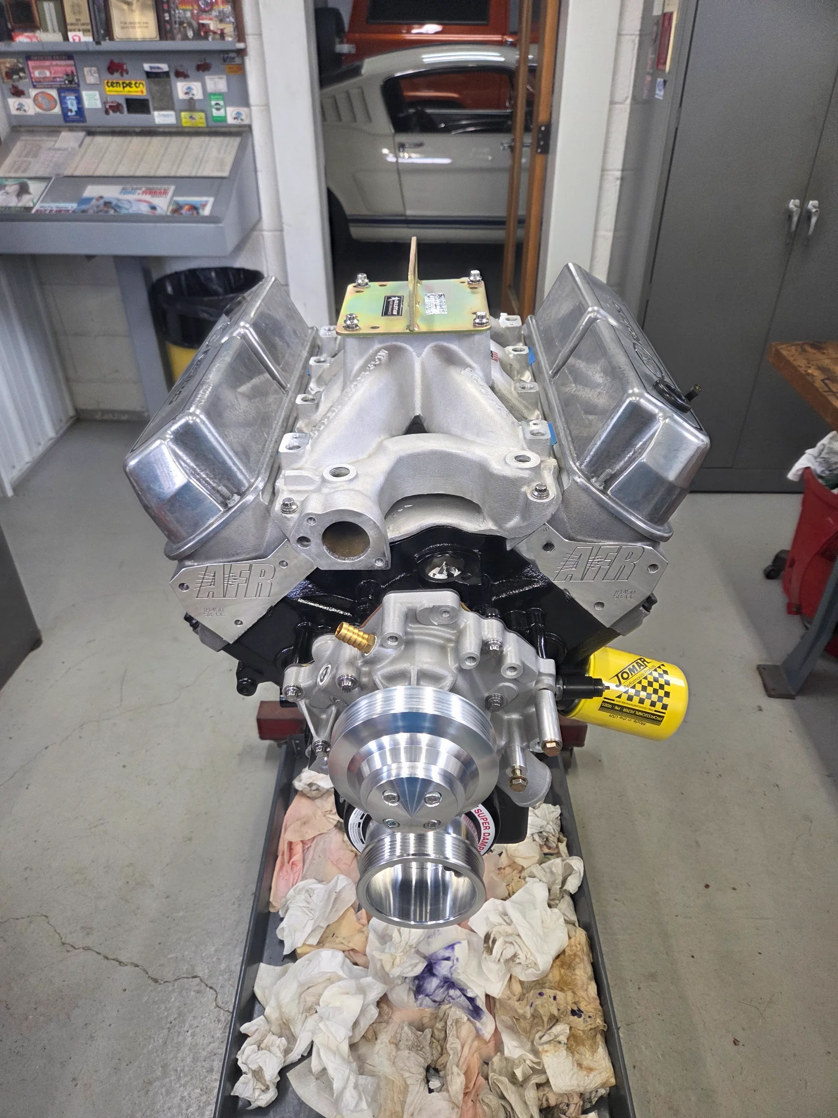

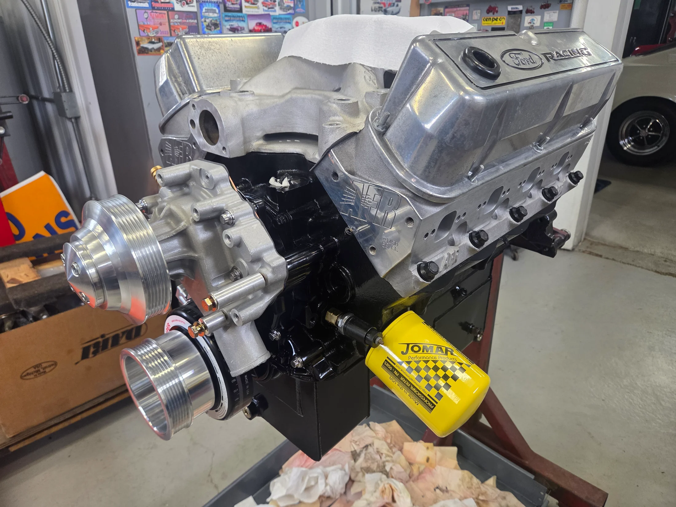

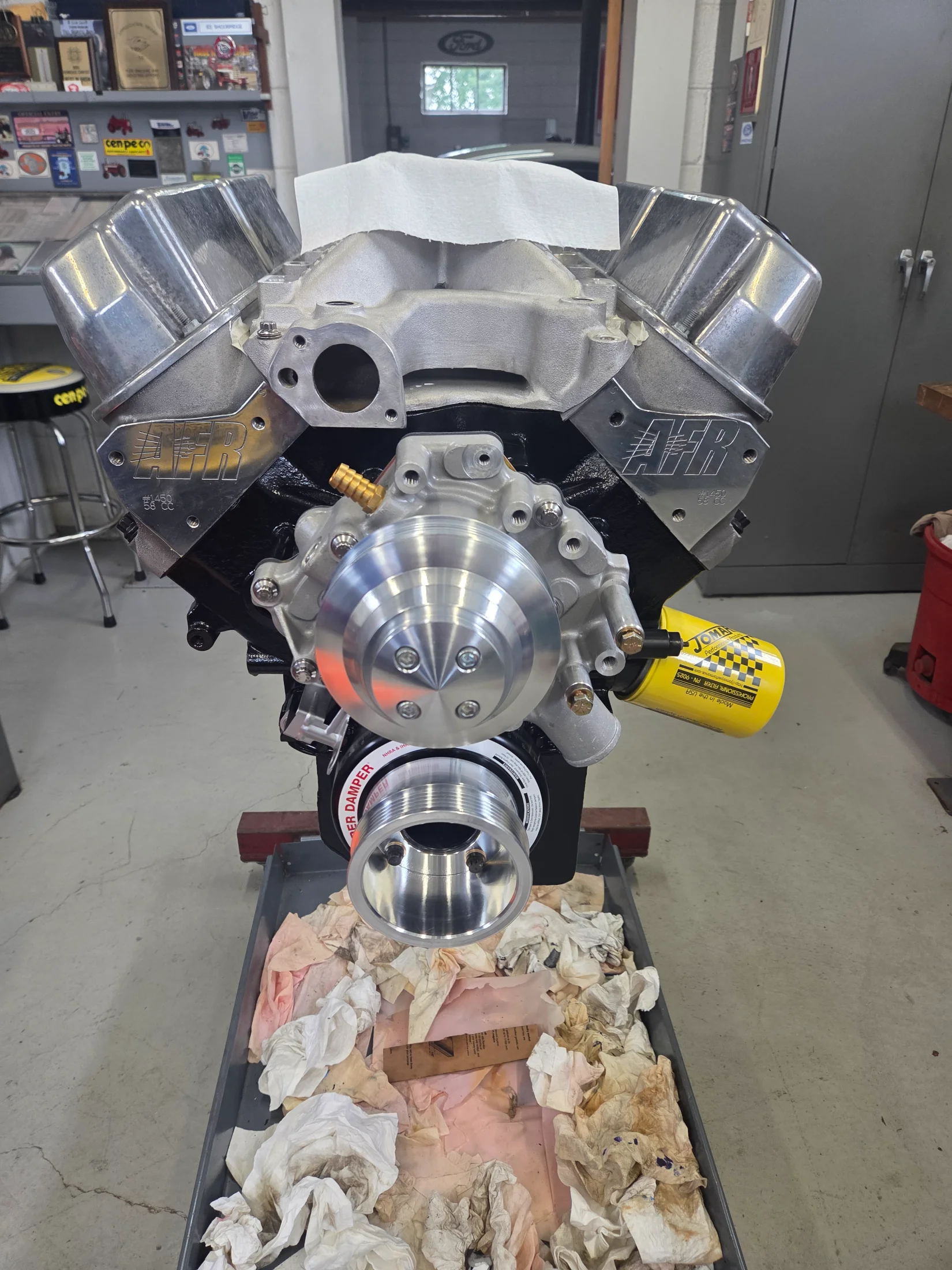

Have stainless bolts installed on the front timing cover as well as the balancer and water pump final installed.

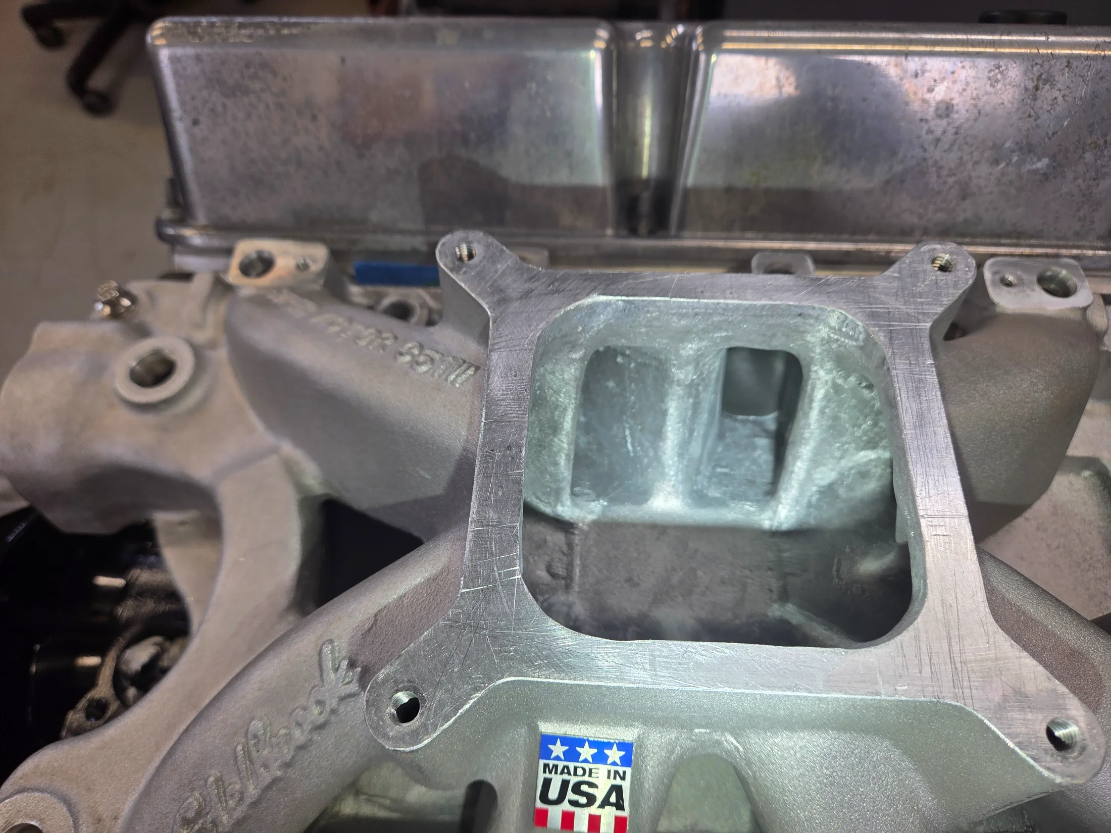

Intake still needs alittle plenum clean up.
Pretty close to putting oil in, priming and final install of Intake. Need to clean a few parts up for clear coating, then I can clear coat the intake.

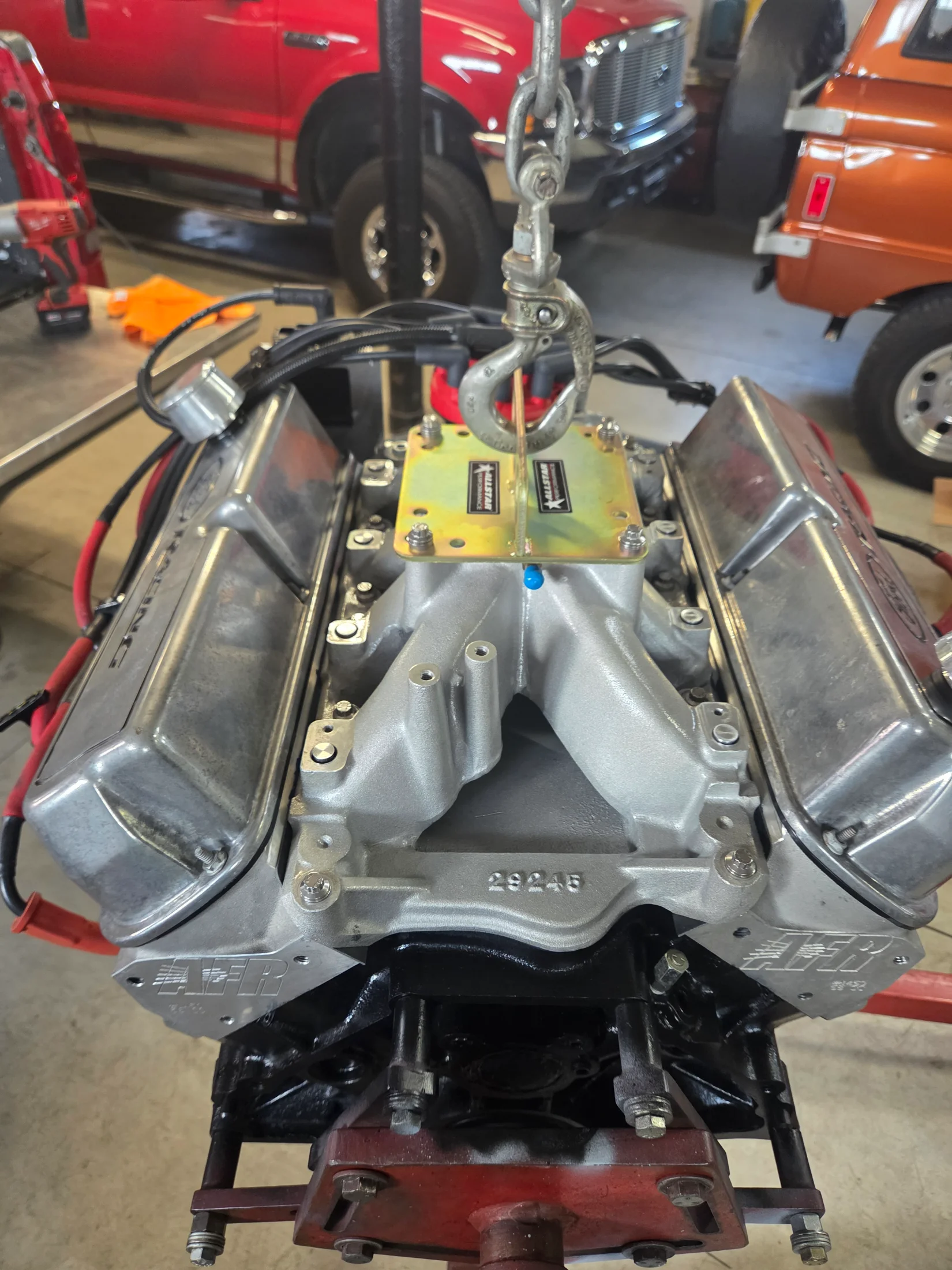

Made it back out to shop today with one objective to wrap up the intake.

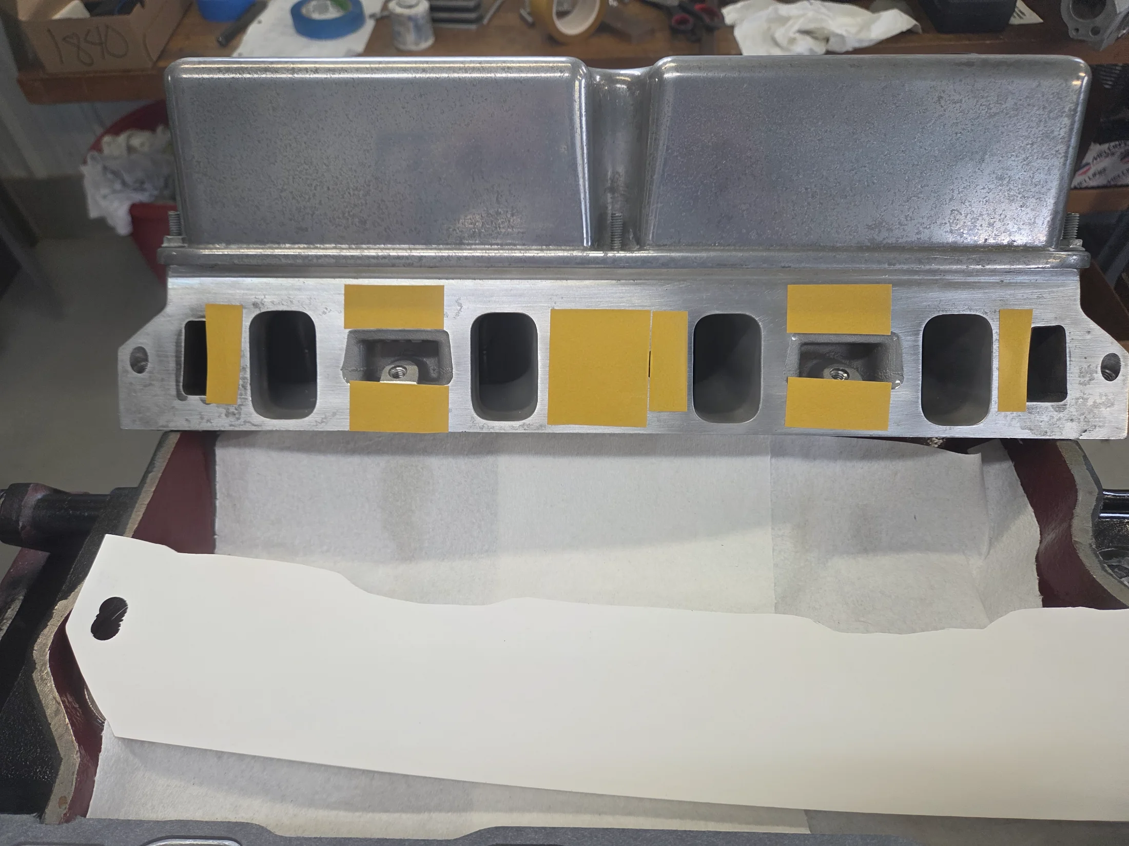

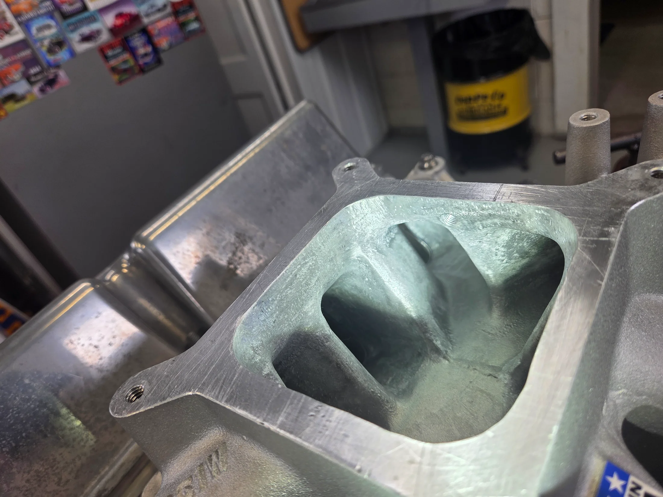

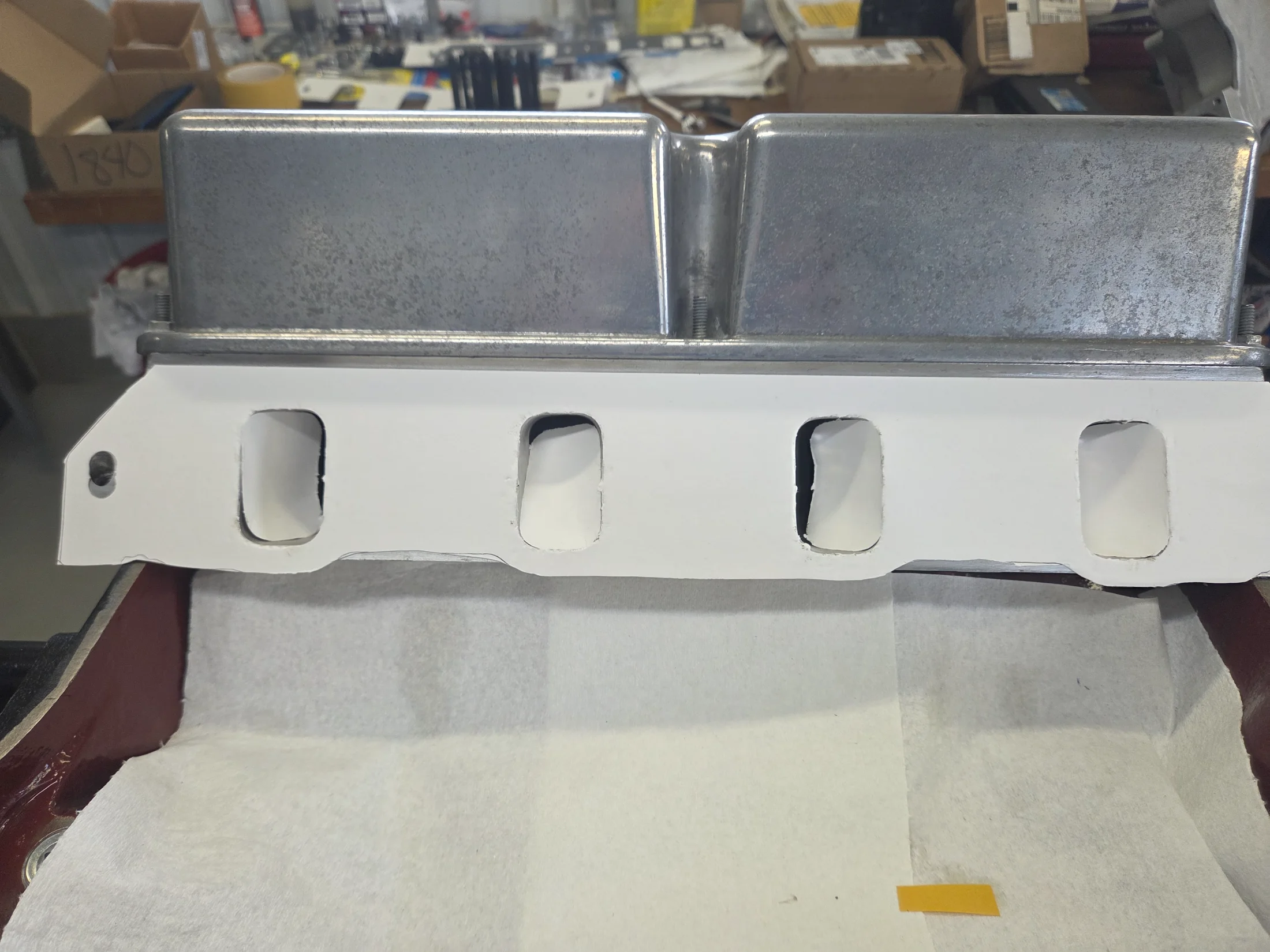

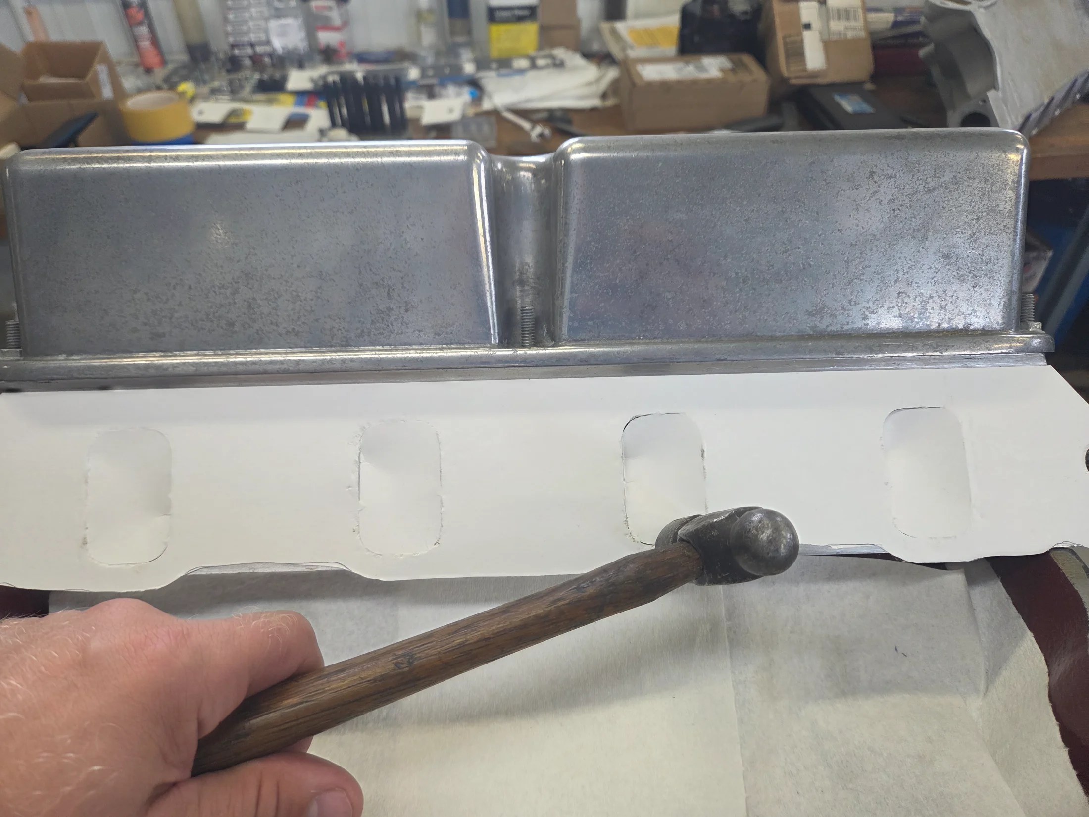

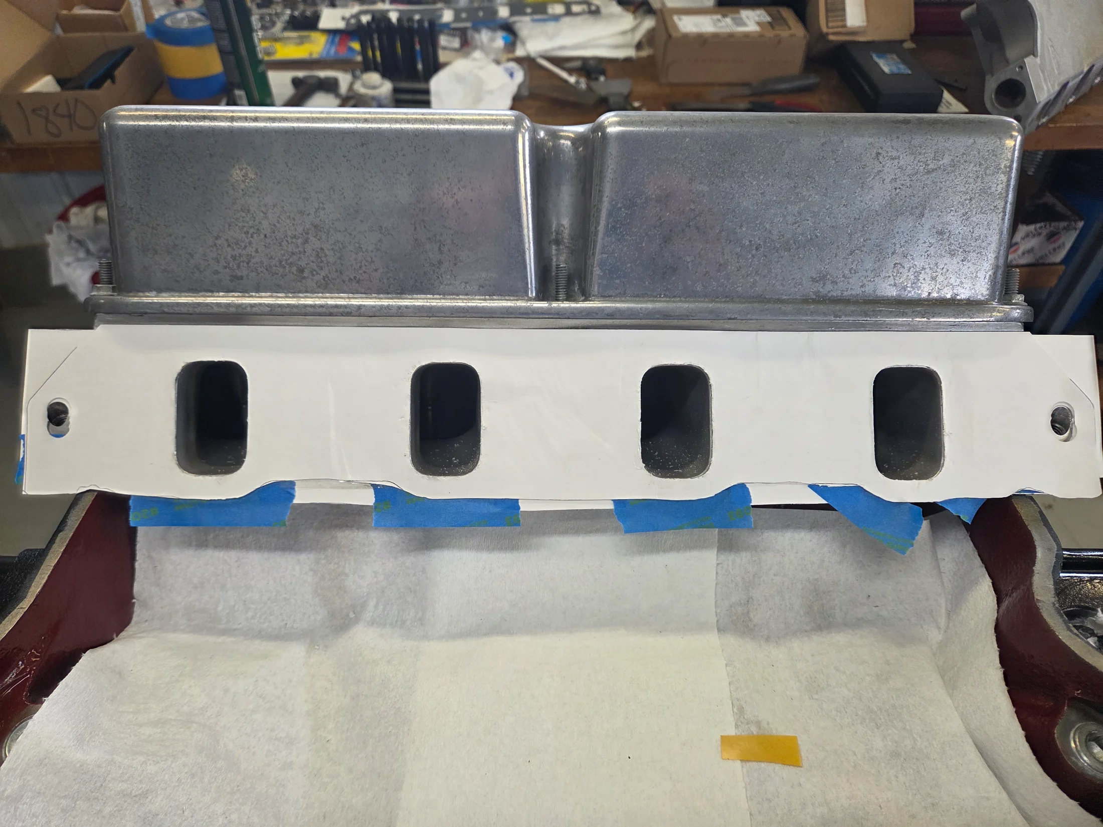

This time I made a template to transfer to the ports. Using thick poster board, need 2 pieces to make up close to the .030 gasket thickness. Worked really well as it helped me know exactly what to grind. After that I cleaned up the plenum, dividers and minor runner touch ups.
It is done next step is clear the aluminum parts and final assemble intake and front drive.

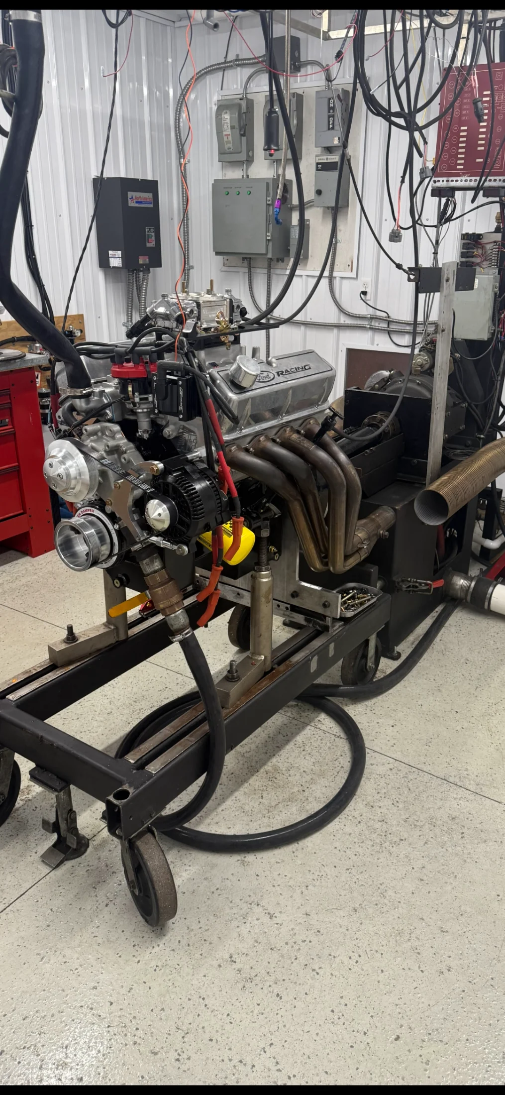

Long story short he had it running the Wednesday prior to Labor day. Dyno was going to be that Friday prior to Labor day.
We had some storms come through just as he started it up on Wednesday. There was a close by lightning strike that he thought took out the throttle actuator. He had ordered a actuator for delivery that Saturday. Well it ended up taking the whole control box. Anyway he got it fixed this week! He has it running, break-in, retorque head/intake, adjust valves. Everything is ok so far. He said he had it to 5K.
So dyno day is now THIS Saturday!

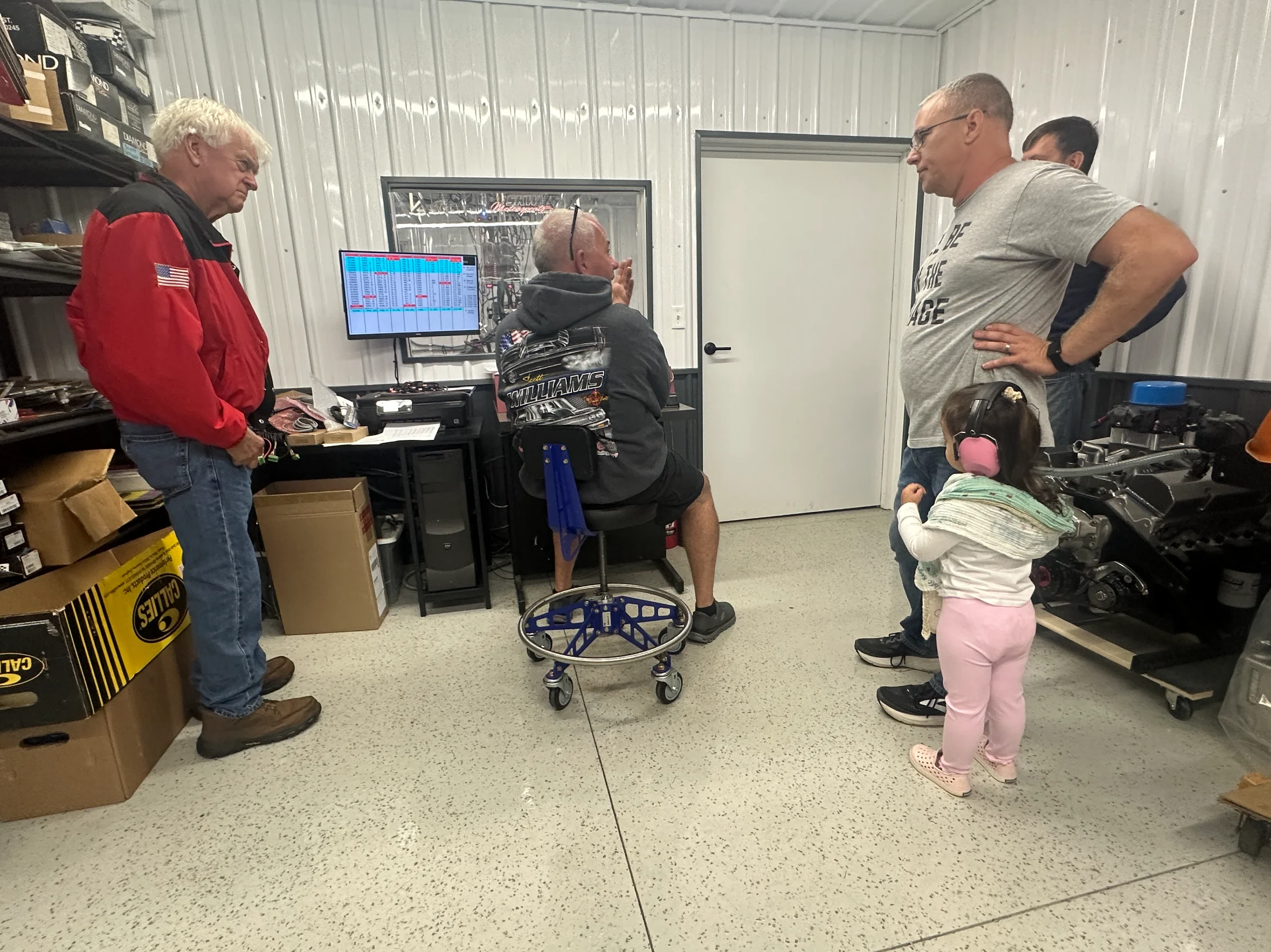

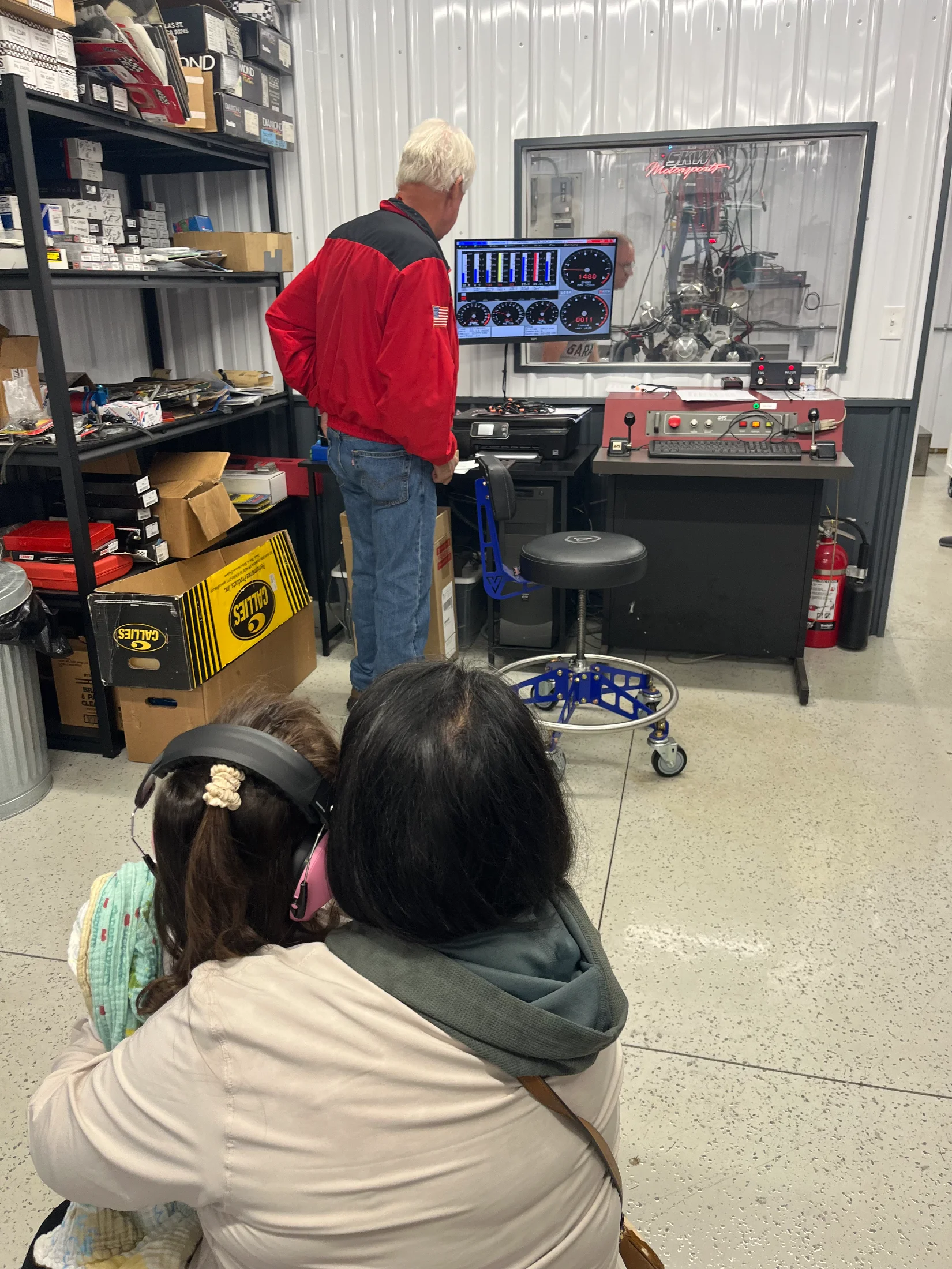

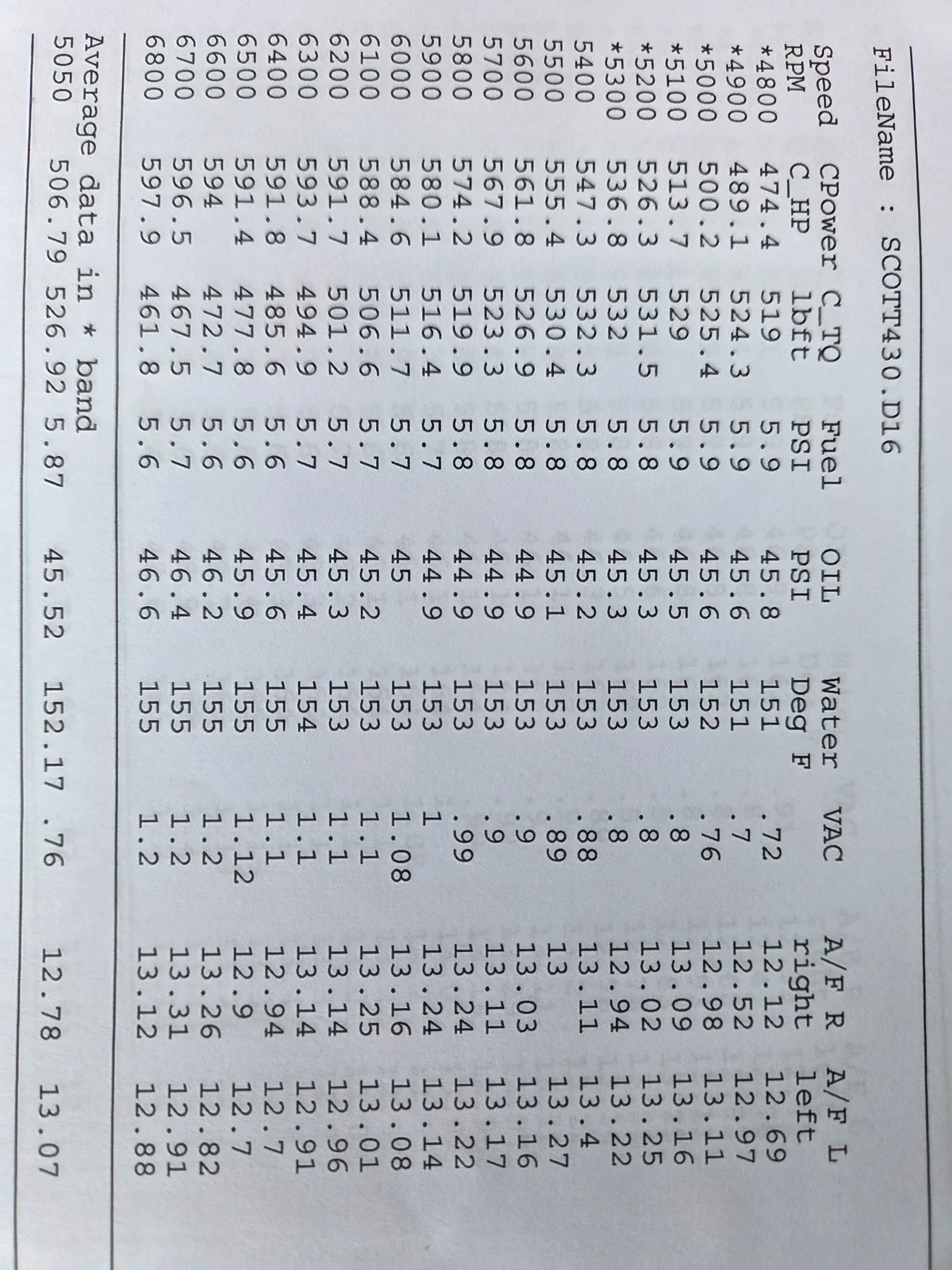

Ok results finally!
It was a family/friend event with my neighbor, 2 friends, mom and dad wife and daughter. Dyno guy was OK with it I think:hide:, hey atleast I gave him a heads up:coff:

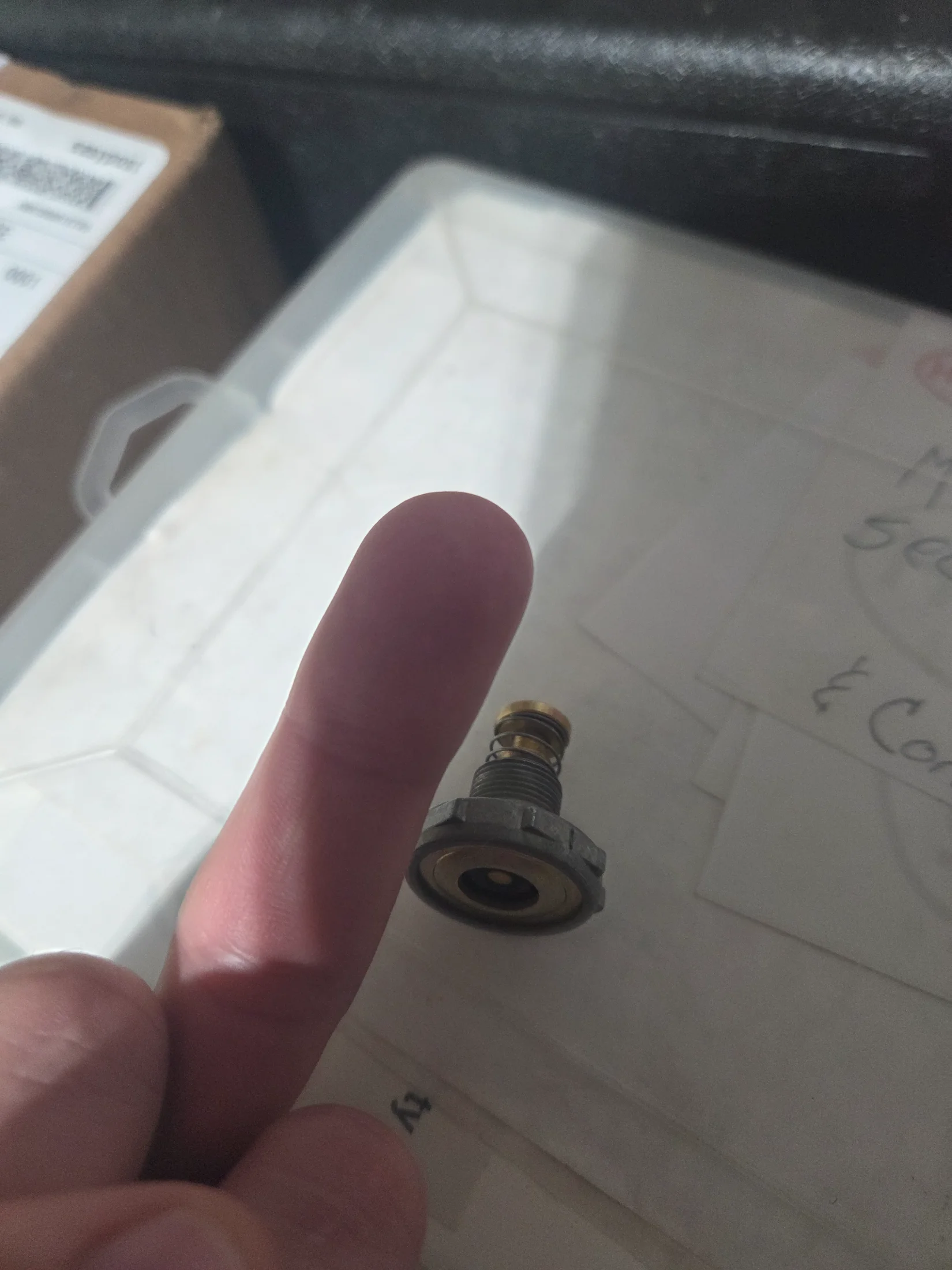

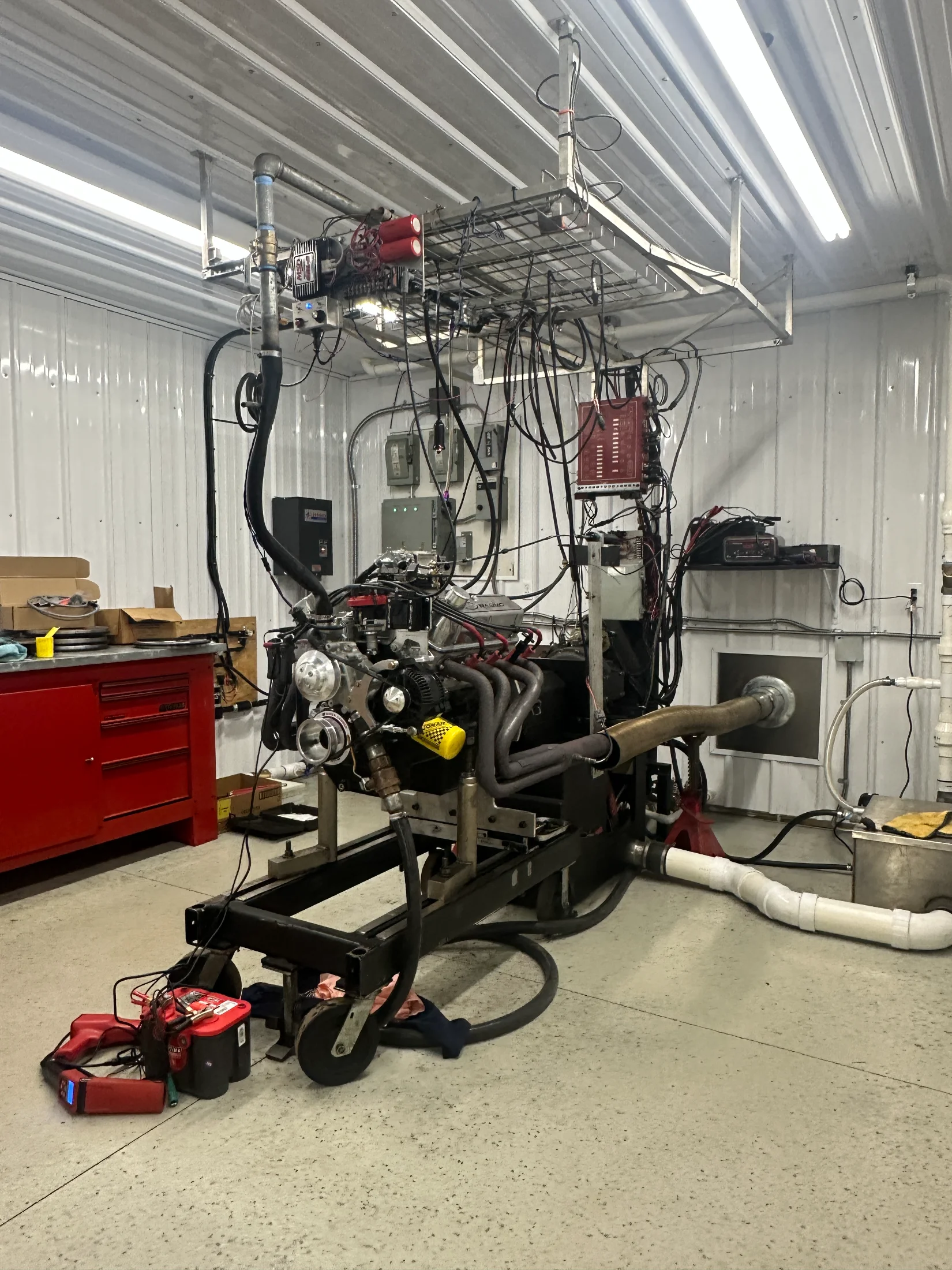

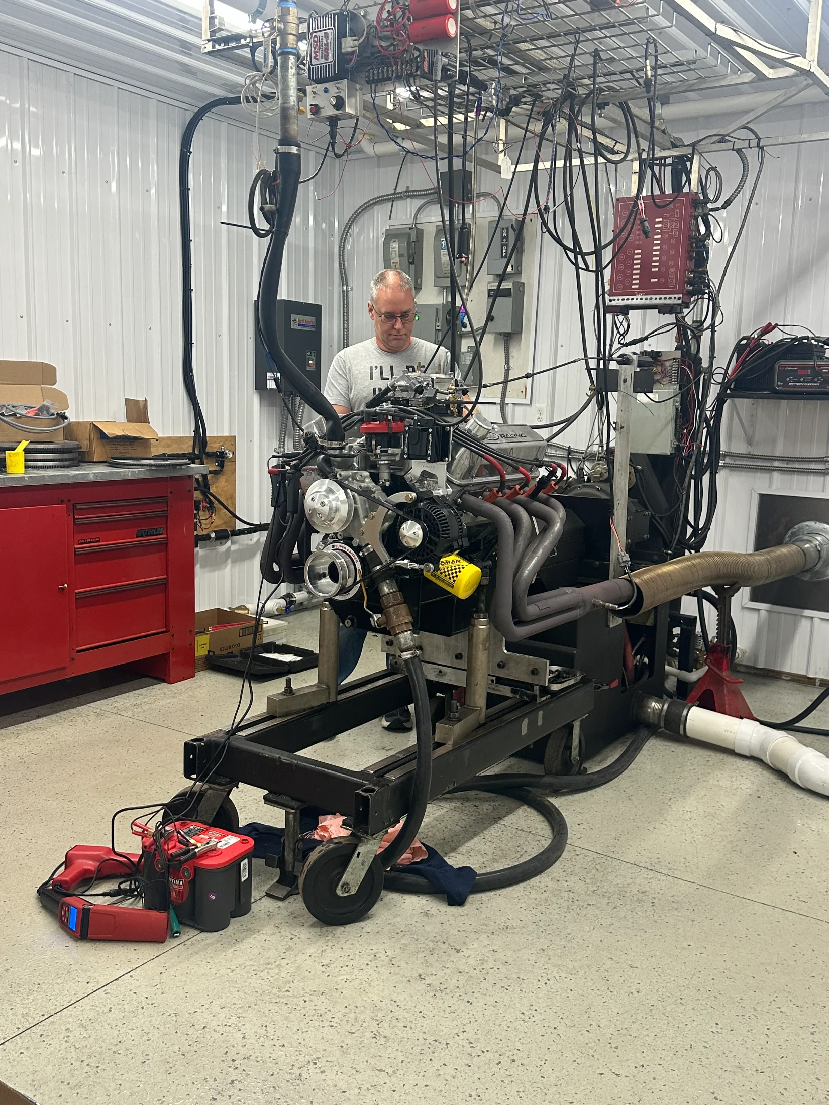

15 pulls, 11 of which were chasing a bad PV in this carburetor.
We only made a few today and we're wrapped up by 12pm. We plugged the PV and started cutting fuel by re-jetting.
Best was 597hp/532 ft/lbs:burnout:. On 93 unleaded with 10% ethanol.
We played alittle with fuel at the end with a blend of 90 rec fuel and 110 race fuel. If nothing else it told me it is so close in HP that for long term storage over the winter it didn't kill hp too bad.
Honestly was hoping for 700ish. I guess that was a lofty goal!
