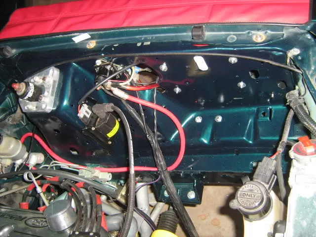

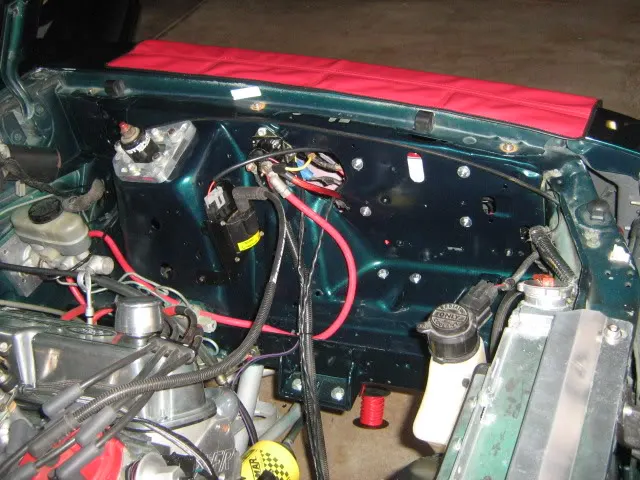

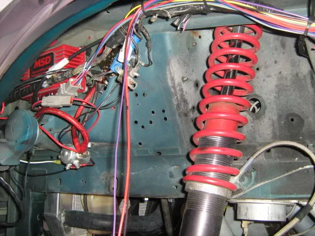

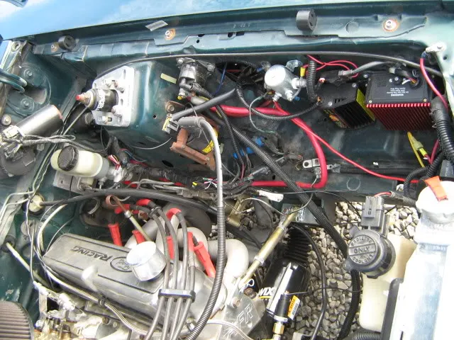

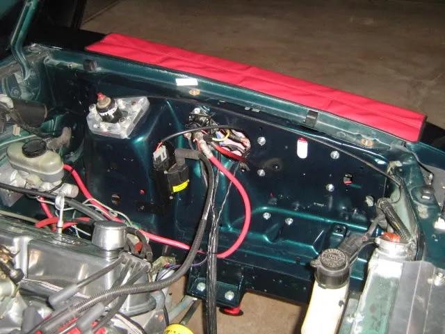

As requested a sound clip. Figured why bother updating thread without sound clip:D. Also did the drivers harness hide with the new MSD 6AL programmable with three rev limiters. I also hooked the factory tach up and found why the high beam indicator didnt work. Still need to calibrate the speedo for the 4.56:1 gears:rolleyes:, I figure it is about 6-8 miles fast at 55mph. I almost have all my list complete that I made in the spring of things to fix this summer.

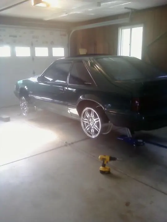

Before

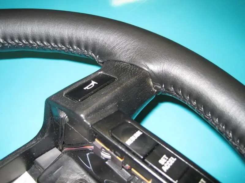

After

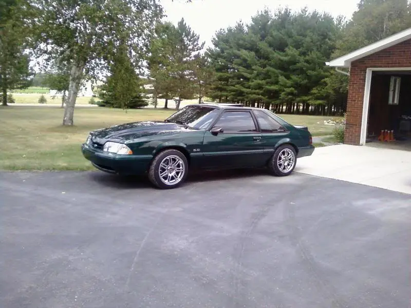

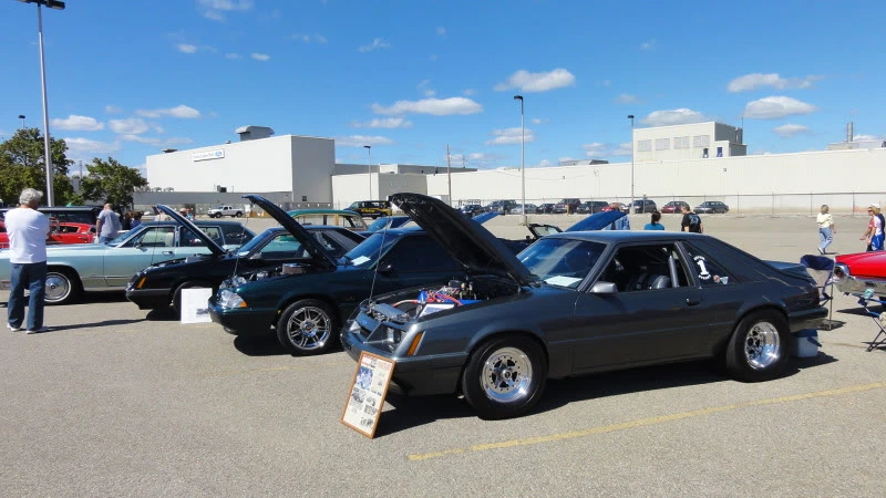

Went to a local car show last weekend for kicks and entered the 80-99modified (3 or more modifications) car class. Well apparently the judges liked the car as I figured I had no chance. Third place a 93 black cobra beautiful with drag lite wheels:rolleyes:. Second went to my car:D, and first went to a 88 vert. Apparently the judges liked fox mustangs! I was shocked to say the least.

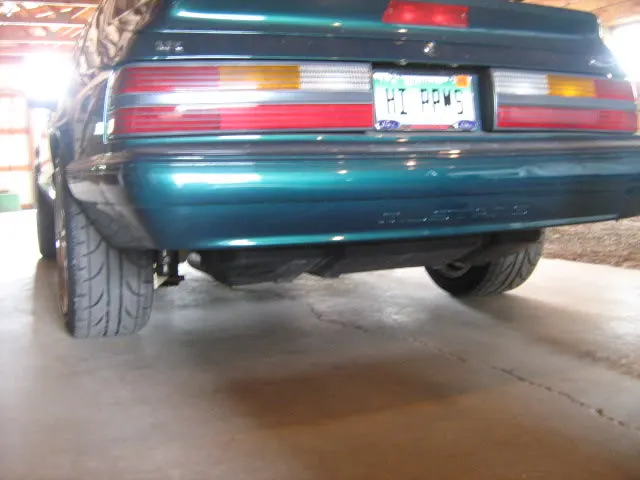

Also had to cough up the money and buy new boots for the back as I was starting to get cords showing on the old ET streets. Had all the wheels balanced and man what a difference. Before I had a vibration in the fronts as they were not balanced. Oh man this thing hooks hard on the street now, wow what a difference a fresh new tire makes.

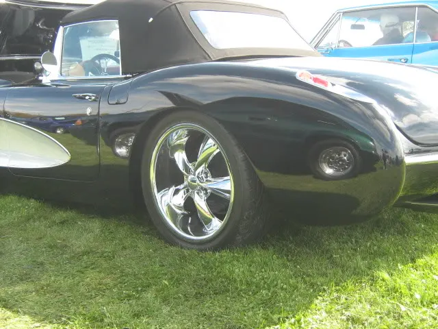

Can you see the reflection off the 57 vett?
Well it has been awhile, I have been meaning to give an update for a while. Well over the winter did not do too much. Gary Williams went thru the carb, installed a Innovate AF gage, installed a viper car alarm where the old air bag power module was, new 200amp alternator, shift light, hooked the MSD to the clutch switch, rewrapped steering wheel and ultra clear head lights. That was about it.

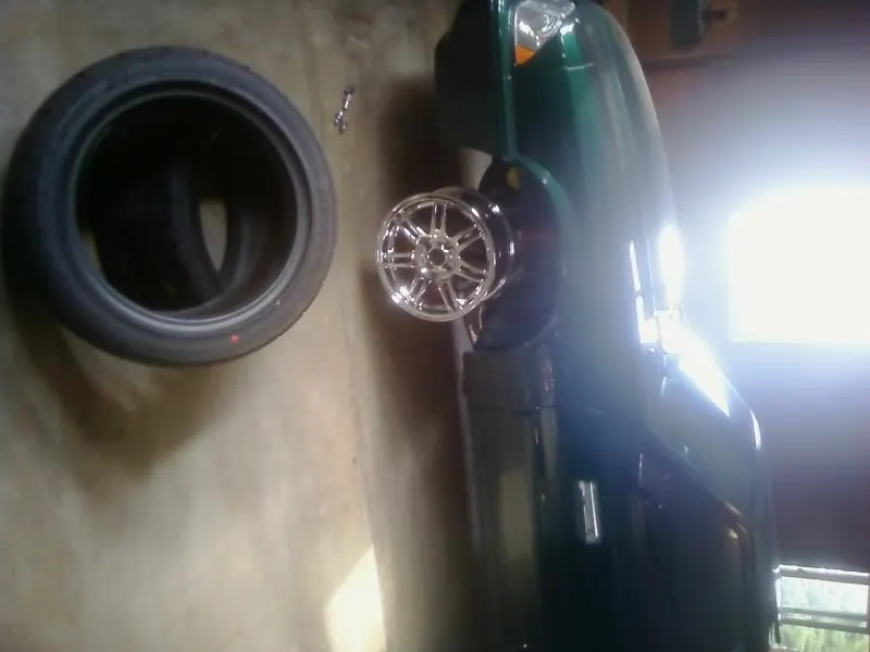

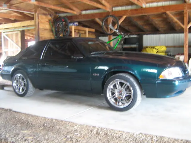

After bringing the car back to MI I ordered a set of 17x9 10th anniversary rims and Dunlop 245/45-17 tires.
With the new wheels took it cruising a couple weeks before Woodward and took it out Saturday night for the cruise after the rain.

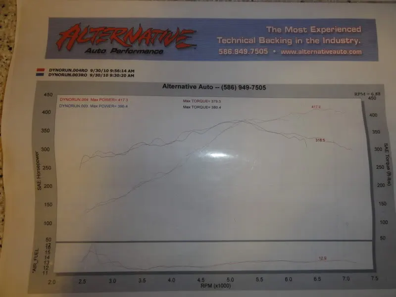

Dyno day at Alternative Auto!
Well started out good...Best was 417.3hp@6600-6800 and 379ft lbs @5200rpm, this was on a dyno jet in 4th gear. Made above 375hp from 5200rpm on up:nice:. My goal was 430:D and realistically thought depending on the dyno and stuff figured 380-430hp would make me happy. So very happy!

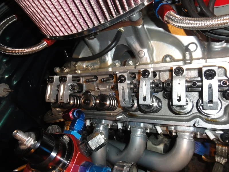

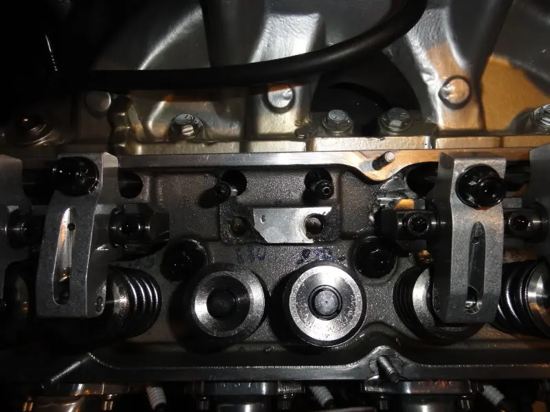

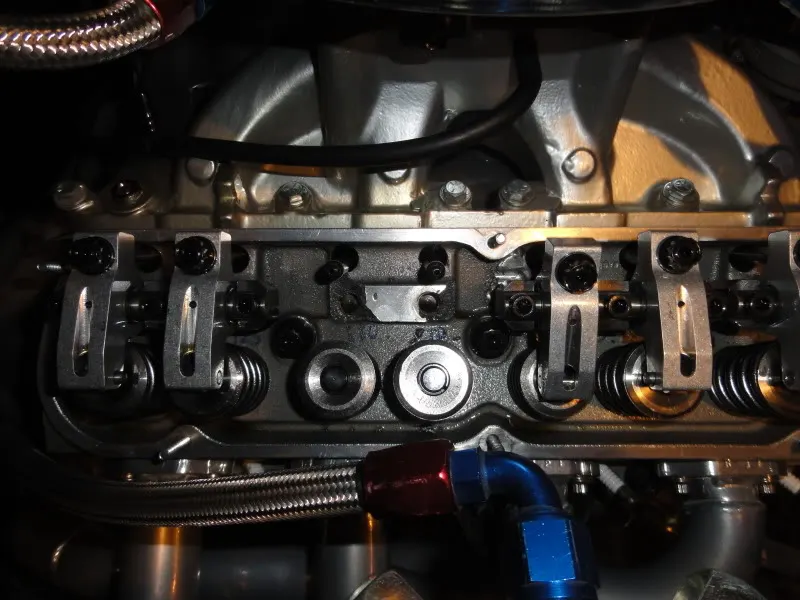

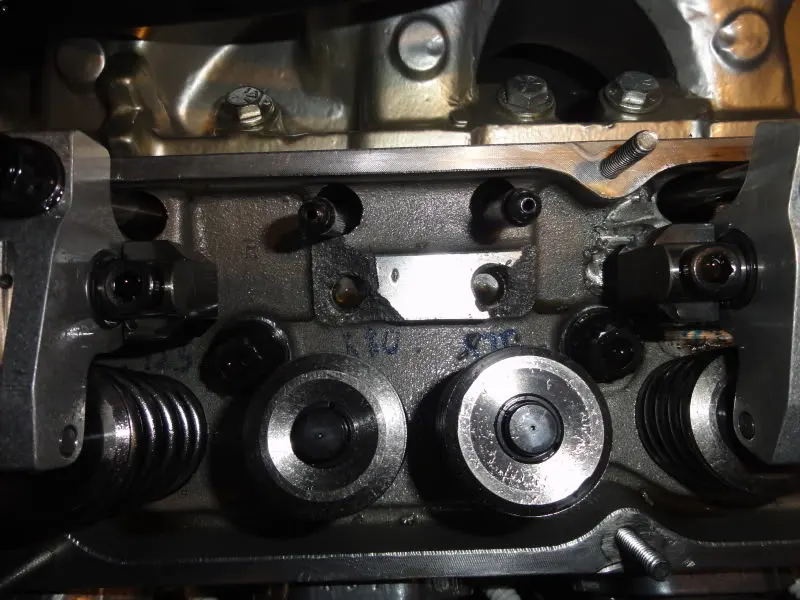

Although did not get to play to much as on the run 4 it pooped around 6500rpm, just a puff of raw fuel out of the carb. Well after timing change and restart to reestablish base line Lidio said she is missing, went thru the heat gun and found #3 was stone cold. Come to find out #3 ripped the rocker boss right of the head:mad::nonono::(:notnice::eek:...again. Note this is shaft rockers so im not real happy since this is the second time with the same head, last time was #2 exhaust. I called AFR and they said send them back for evaluation.
So it was making good power and I think she had some more in her just going to wait till I fix her up again:shrug:.
I am almost thinking of ditching the AFR and going twisted wedge but then a rocker and piston change is needed. All I know is the first time is fluke the second there is a serious problem with the casting quality or just not enough meat around the boss.

The damage...

that really sucks about those heads, ive never seen anything like that, mabye you just got a bad casting or something. Did you make any headway on the cage? and have you ever scaled the car?
I think if I deciphered the date code right they are 2000 vintage heads. I really think there is something wrong with the casting.
I do have a 1/4" plate under each stand to make the rocker sit higher to get the geometry correct. Don’t know if that is a factor or not? I also wish that I made all the 1/4 plates together from one end to the other that would have given more support to each boss.
I will post on Hardcore and maybe over on speedtalk as well to see if I can get any feedback.
Car weight is right around 3000 with quarter tank fuel and with me in it. Joliet, IL was 3040 but I think I had closer to half tank of fuel maybe even more.
Scott
I haven't heard of a boss failing like that twice in a row. My guess just from an engineering standpoint is that you got a bad casting or there's another factor that hasn't been revealed yet that's putting undue stress on that particular area. What has AFR said about the failure?
Scott
Well it broke before with the other rockers so id say you can rule that one out.
And how the hell is your car so light my car is 2980 without me
Since the last time it broke the whole valve train was changed, cam, lifters, pushrods, rockers, keepers, springs, retainers...added lash caps.
AFR will not say much until I send them the heads for evaluation.
weight NO CAGE! My goal is to keep the same weight when I do cage her. So weight will be removed from front brakes, anything that is under the dash that is no longer needed, inside the doors although that may already be done.
Scott
I would definitly send them in, since the castings are so old, mabye they will offer you a newer head for really cheap, that would definitly be the right thing to do
