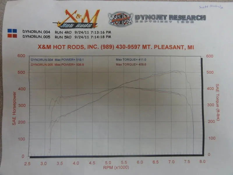

Just made 510rwhp 7000rpm, and 411ft lbs about 5500rpm on dyno! It has felt much stronger from last year but never figured I picked up 93hp! Guess I need a new driver at the track, new best is 11.42 in the heat of the summer at NMRA Milan, MI.
Different dyno and great air today, but still 510hp on NA 331! As comparison, also Dynoed 94 f150 5.0, auto 3.08 rear gear in drive made 168.8rwhp at about 4000rpm and 267ftlbs torque.

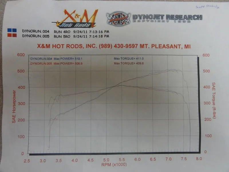

dyno sheet and video. Look at that torque curve!!!! Not giving much torque up top! I need to get this thing at the track ASAP!

Current:
92 Ford Thunderbird block
10.5:1 .030 over, light SRP flat tops at 0 deck, o-ring block with stock head gasket
Forged Eagle rotating assy with I beam rods Buick bearings, .927 Chevy wrist pins
FTI (Ed Curtis) custom solid roller .664/.633 lift .238/.248 duration 110LS, installed at 108*
Trend custom 3/8 push rods
Pre bankruptcy Crane Ultra Pro SR lifters
Probe shaft 1.6:1 roller rockers, with spacers to optimize geometry
AFR205's out of box with my good springs and titinum retainers with Super Victor Intake port matched/cleaned by me and milled.
Warmed over Quick Fuel 750 Think it is about 800cfm currently
4 hole fanalic 3/4 spacer
Bassani long tubes with 1 5/8 to 1 3/4 steped.
Bassani 3" "X" pipe
3" idividual Dyno Max muffers dumped before axle
Spec Alum fly wheel
Centerforce dual friction clutch with new full face disc.
Heads flow numbers as shown above flow 300 cfm.
Old set up was with worked over AFR185s with 2.05/1.65 and Professional Products small single plane. Heads flowed 275cfm they are back a page on this thread. Made 417hp 380ftlbs, dyno sheet back a page as well.
