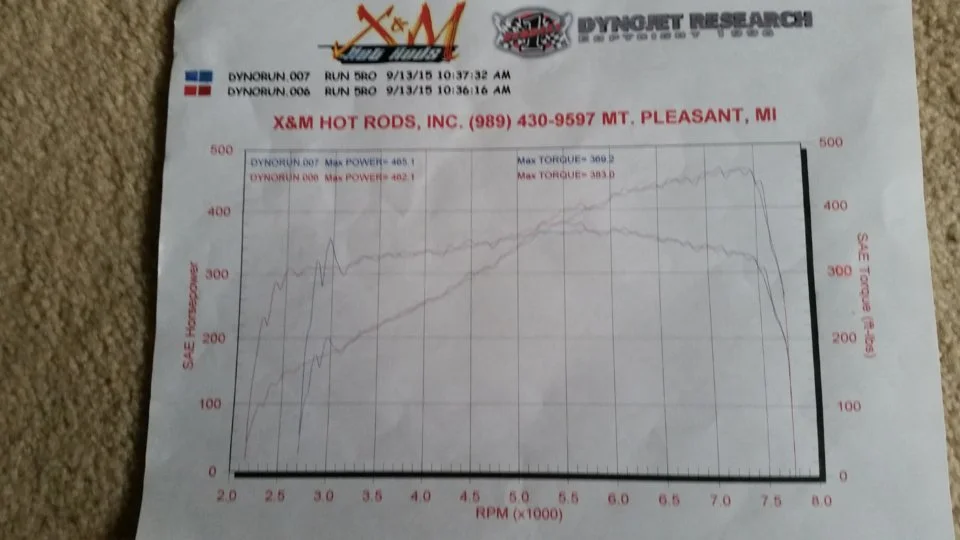

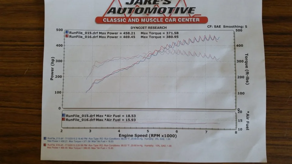

Dyno results last summer:

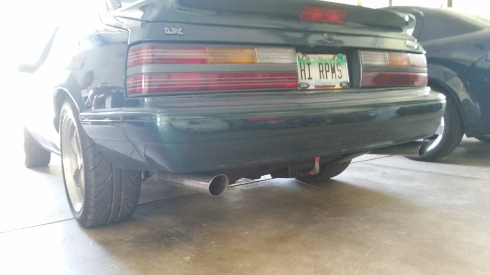

Added custom 3" tails and new mufflers old ones rusted out, again last summer.

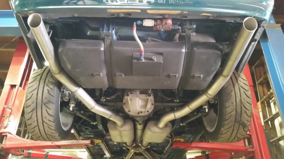

As it sets last fall.
Dyno at a car show last fall, this was with the tail pipes.

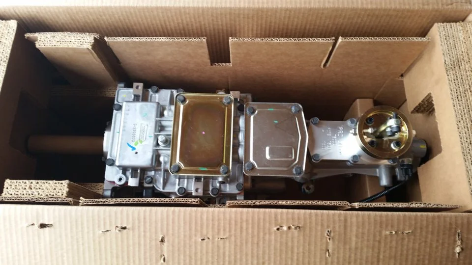

Car was a joy to drive put almost 1000 miles on last summer, but the Tremec 3550 trans was toasted. So I talked with @90lxcoupe about his experience with face plating and Liberty. So trans was pulled first of December and dropped off at Liberty. I was advised a 12 week lead time. Well about mid March I get a call, trans is appart it a cracked case, spun 3rd and 4th gears and on and on. So I opted for a done up TKO600 which I just picked up today! Even if the other trans was salvageable I still would have went this way, this has a faster 1st gear. This will help my 60 ft time.

Damn! That thing screams! I forgot you spun it that high. Keep posting your results with the trans. That was the option I wanted to go.

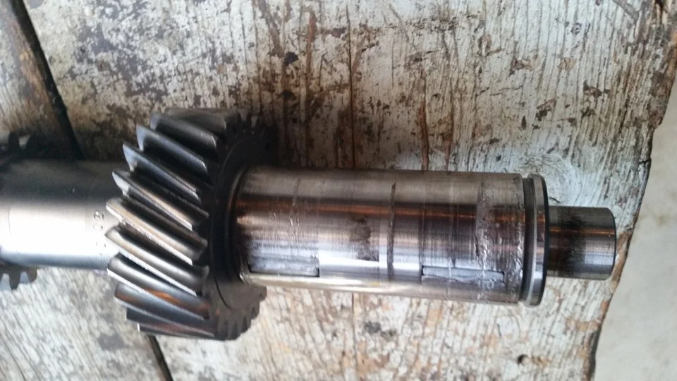

Scott, do you attribute the failure of the 3550 to RPM, power, or both? I'm worried about the well being of mine.

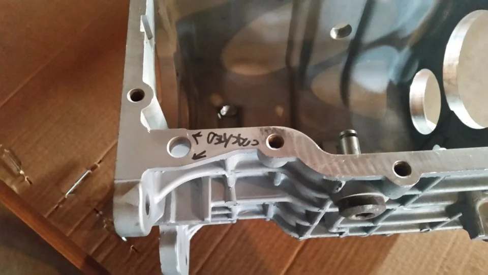

Im not really sure, some of damage does not really seem possible with this power plant. Car came with this set up, so hard to say.
The yoke on the front of the driveshaft is also being replaced, because it wore the outside of the barrel uneven, driveshaft was bent and straightened in multiple places. It is now true and balanced. Here are some pics, case had to be dropped or? the common cracks is the threads where the front retainer bolts on. Again with not knowing the history who knows.
3rd and 4th sheard keys, how does that happen with a NA small block ford torque???
Case cracked at dowl hole

Yikes! Well I've heard that the cases are the weak points on these. So maybe on the launches and high torque moments the case was flexing and caused the failures?

The cases are the weak link in all of the tremec TKO's, i have heard that the newer cases may be weaker than the old school TKO's because the newer aluminum is more porous. No evidence to prove that but it was a pretty reliable source(Bruce Hemminger). Also, having a really tight bell housing to throwout bearing retainer fit may help case life. I had to pry my trans out of the bell, it was pretty tight. I have broken 2 TKO's in pretty dramatic fashion and for whatever reason the cases never broke. First was a original TKO, 2nd was a liberty prepped TKO-600, both times were casualties of too much clutch.
A billet yoke is also a must have, the cast ones twist the splines on the inside of the yoke pretty easily.
Reactions: HotFox, hoopty5.0 and A5literMan

HotFox said:
Figured I should update this thread...
Why is the graph so jittery even with the smoothing on 5? Maybe I missed it, but whats the combo?
HotFox
Jan 5, 2009
1,068
701
164
SE Michigan
Mar 30, 2016
#133
  • Mar 30, 2016
  • #133
We figured it was RF noise with the ignition. But did not notice it in the drive afterwards so decided it was a waste to chase it. Also note did not see it in the fall dyno run on a different dyno.
Combo is 331 with SRP pistons, 10.5:1, FTI solid roller, shaft 1.6 rockers, AFR 205, super victor, 780cfm pro systems carb, super sucker 1" carb spacer, Bassini long tubs with 3" X pipe and 3" Dynomax mufflers.

HotFox said:
How are clearances routing the exhaust under the axle like this? If you lift the rear of the car, does the axle drop and make contact with the pipes? How's ground clearance?
Reactions: HotFox
HotFox
Jan 5, 2009
1,068
701
164
SE Michigan
Mar 22, 2017
#138
  • Mar 22, 2017
  • #138
As you can see in the picture, I did the exhaust at a buddy's fab shop on the hoist suspension was hanging so we kept it very close to the axle knowing it would be way out of the way. No issues with rubbing, and the mufflers are lower. The front headers rub since they are behind the front wheel. No regrets on the way it turned out, way better then over the axle exhaust IMO.

I agree. I like below the axle better. I've seen guys installing 99-04 Cobra exhausts on Fox, so I see a trend. Plus it's nice to be able to drop the exhaust without cutting or pulling axle
