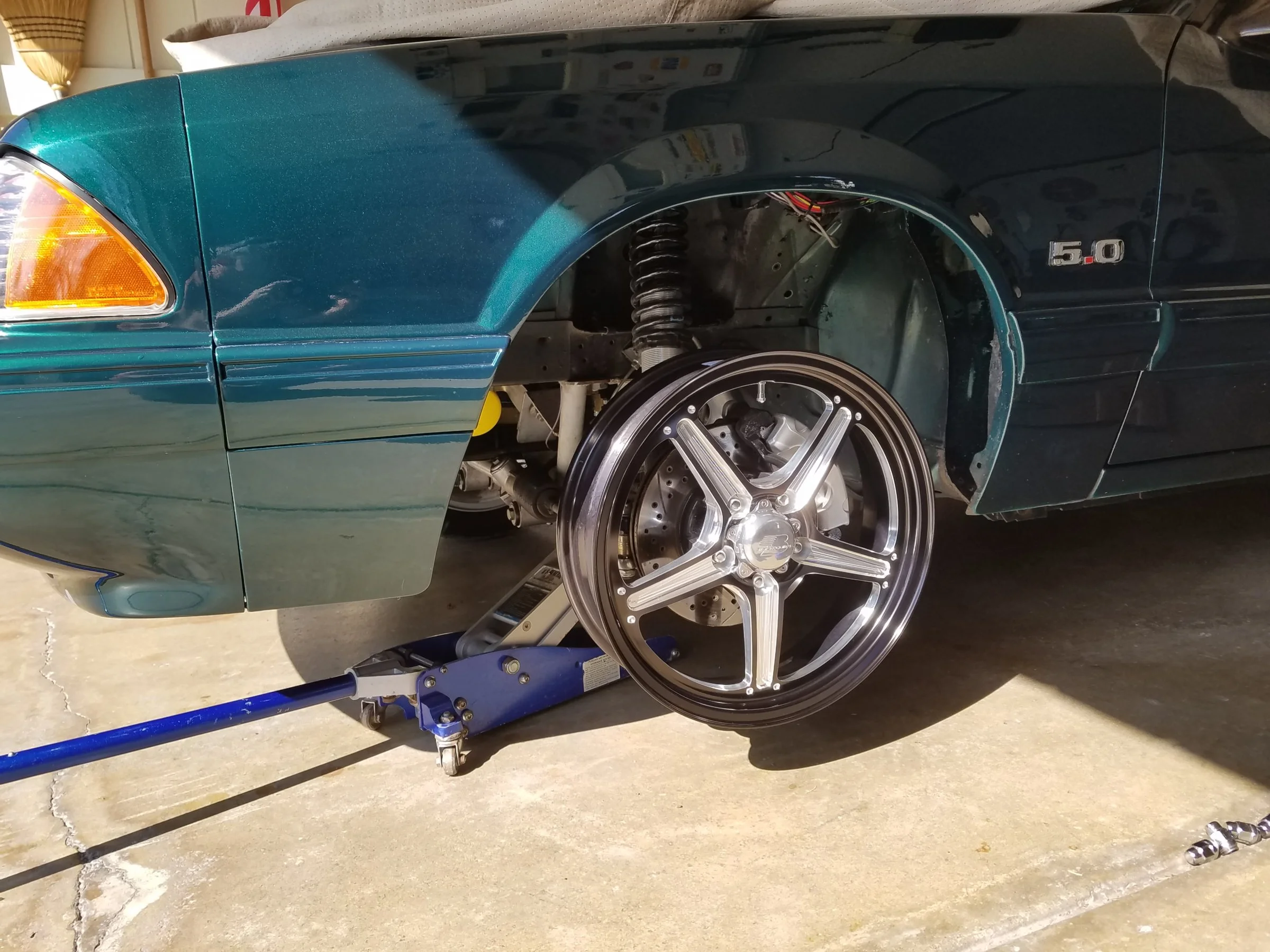

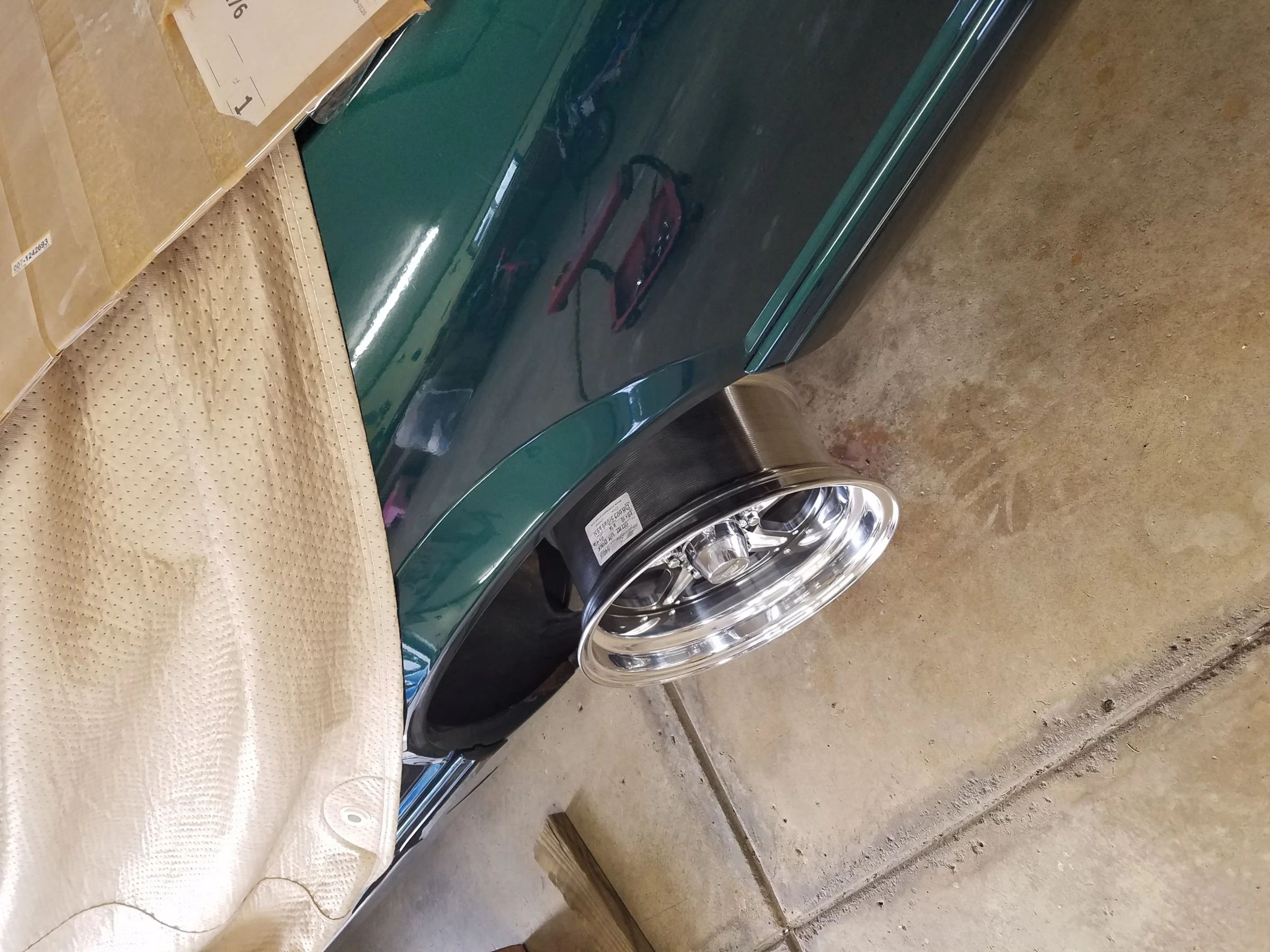

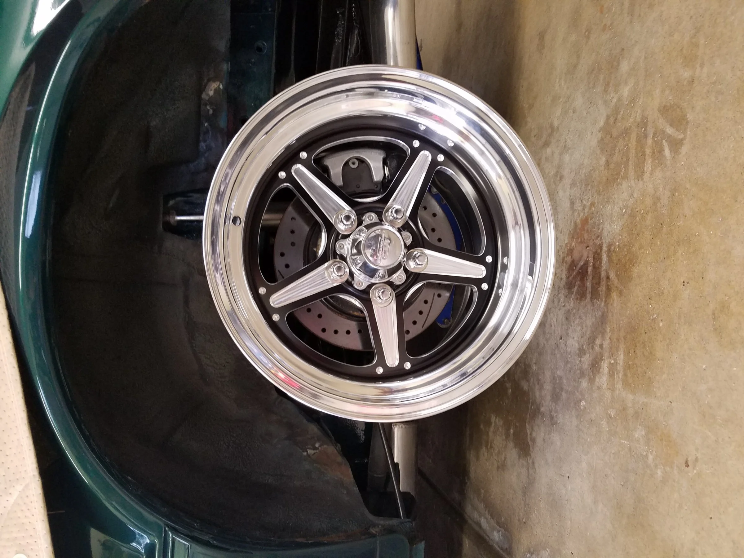

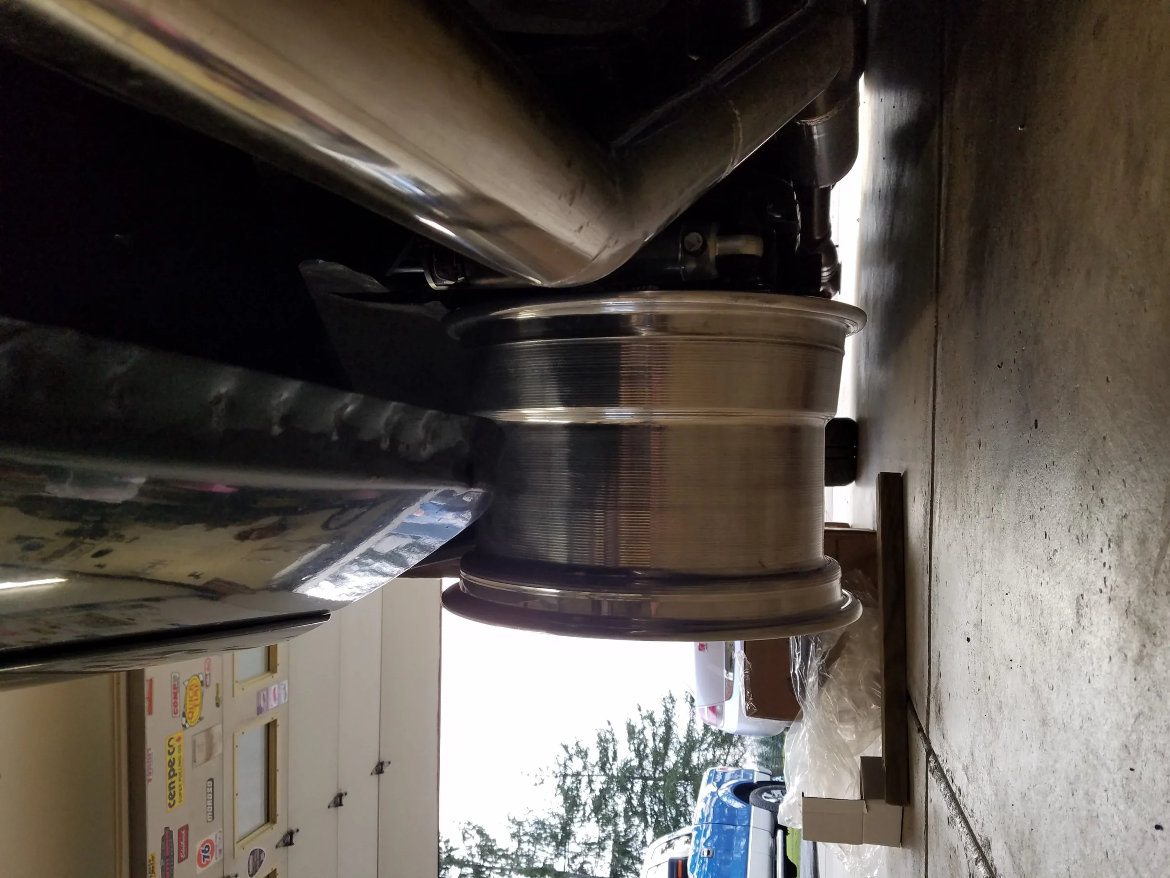

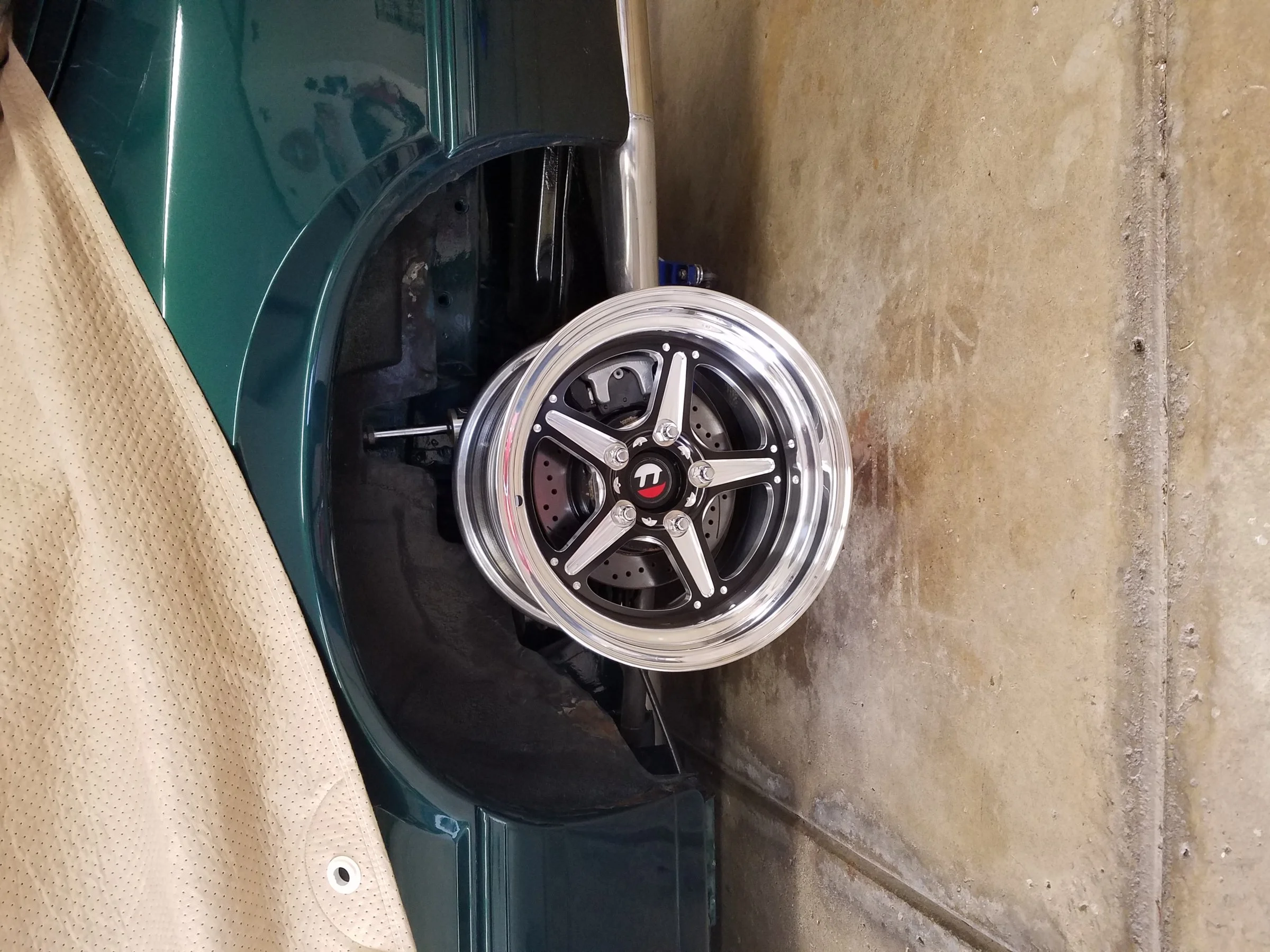

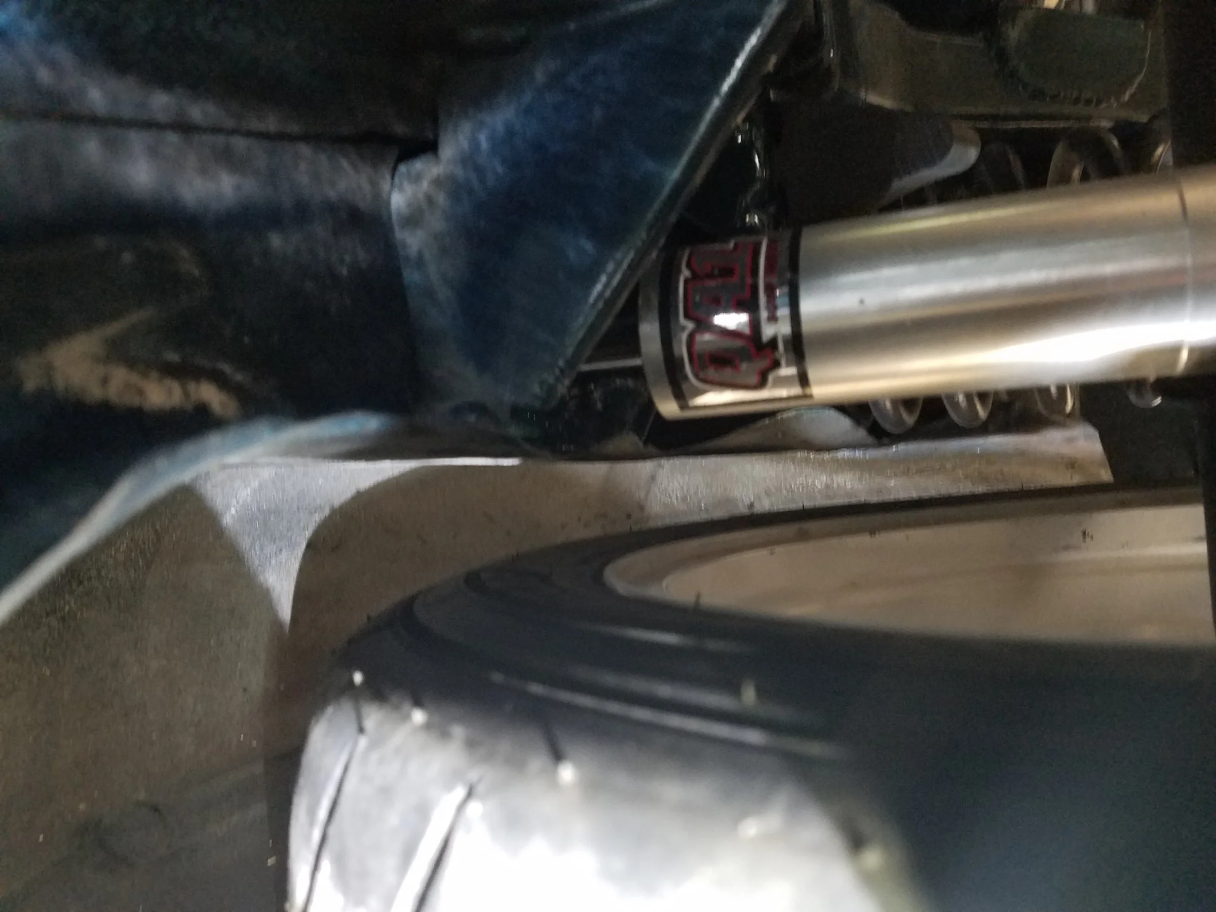

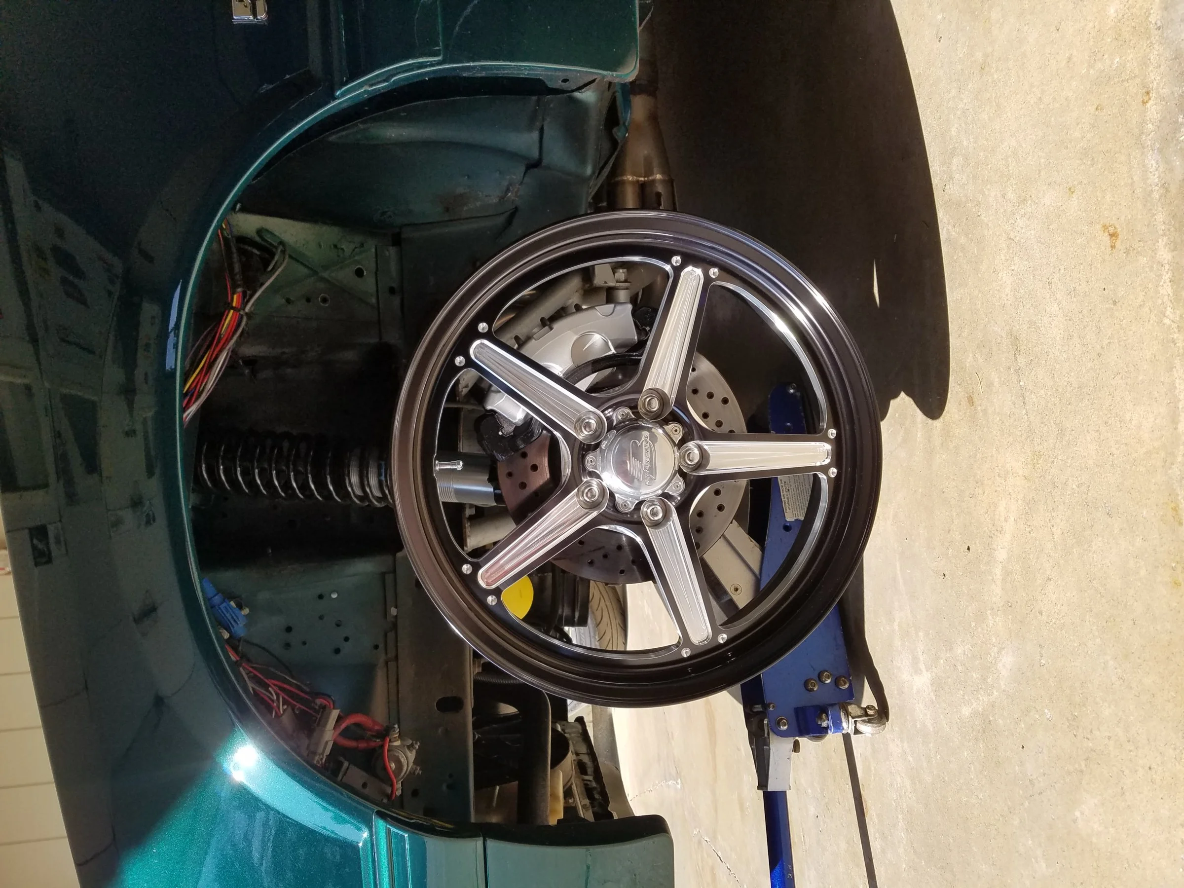

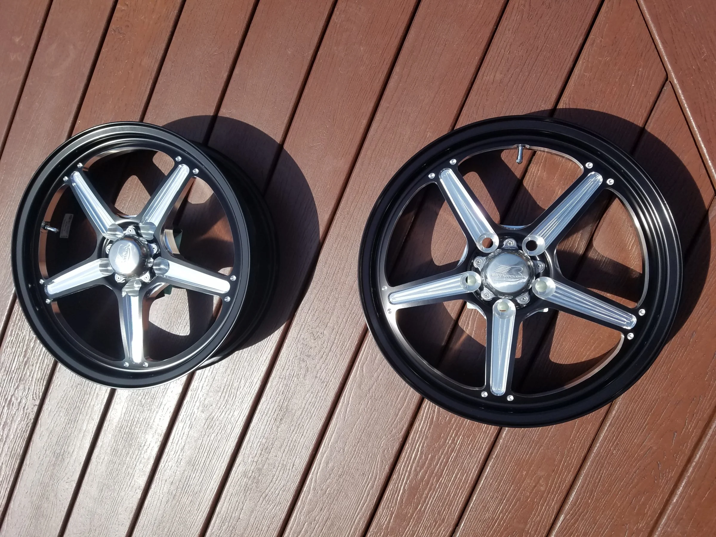

15X10 with 6.5 b/s takes some hammer work to fit a 275/60. On my fox the 6.5 b/s centers the tire very well. Have run as large as 28x11.5 QTP. That took some BFH work and cutting the lip. I can say for sure that 15x10 with 7'' b/s would not work on my car.
Are you running SN95 axle or fox width?
This is about 1.5" of clearance on my Bullitt wheels which are 17x8 OEM'S with I believe 5.75" BS.
How much tire buldge do I need to plan for.
I think I am seeing that your right now way for 7"bs will fit.
I have fox axles. With the stock 28 spline axles i was using a washer on the studs to keep it from rubbing (inside) When i went 31 spline moser,i noticed some light marks on the outside right (275/60) pulled the washers and it is ok now. It's just that close to spot on with 6.5 b/s. 26.5x11.50 QTP's will be here tomorrow,they should fit no problem...
Reactions: HotFox
When I was looking into 15x10's everyone told me to run 6.5" and a 28x11.5x15 is about the biggest tire you can fit and that takes some massaging of the wheel wells. That is with fox axles.
