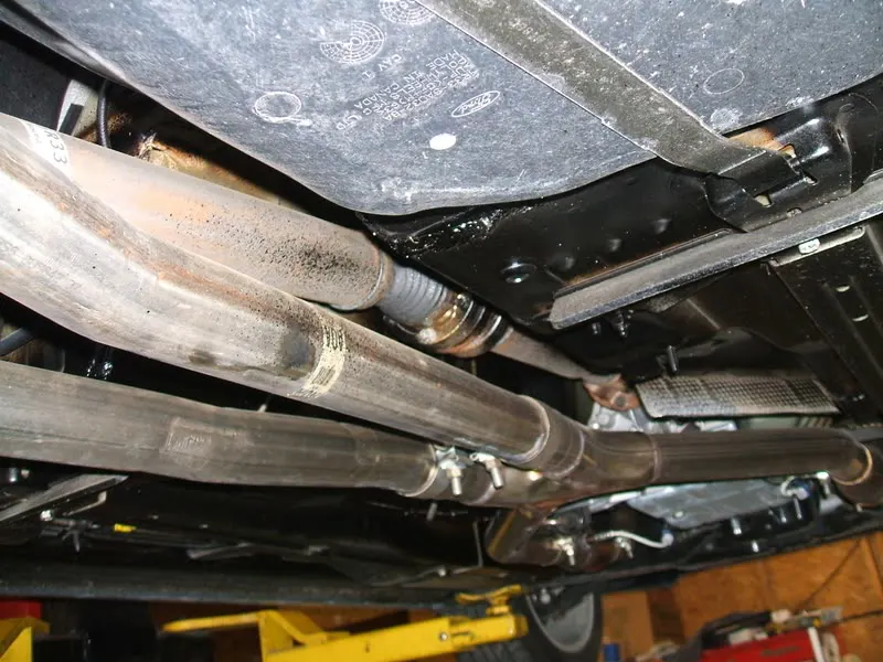

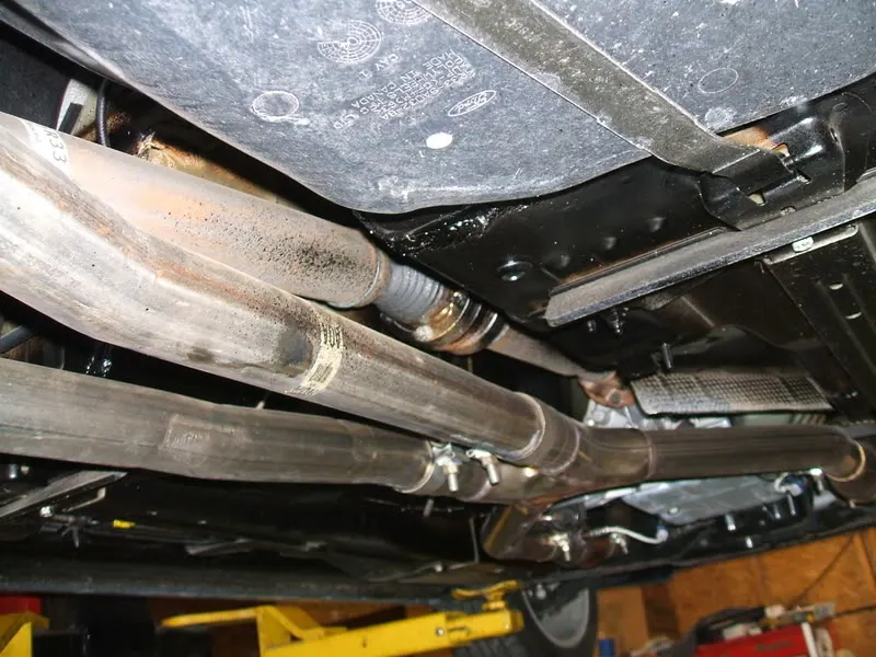

Don't forget the two on the center, and you probably won't even need to mess w/ the exhaust depending on how high you are on jackstands. You should be able to slide the stock shaft out rearward and the new in in reverse order. That is so long as
you are not running some crazy exhaust setup.

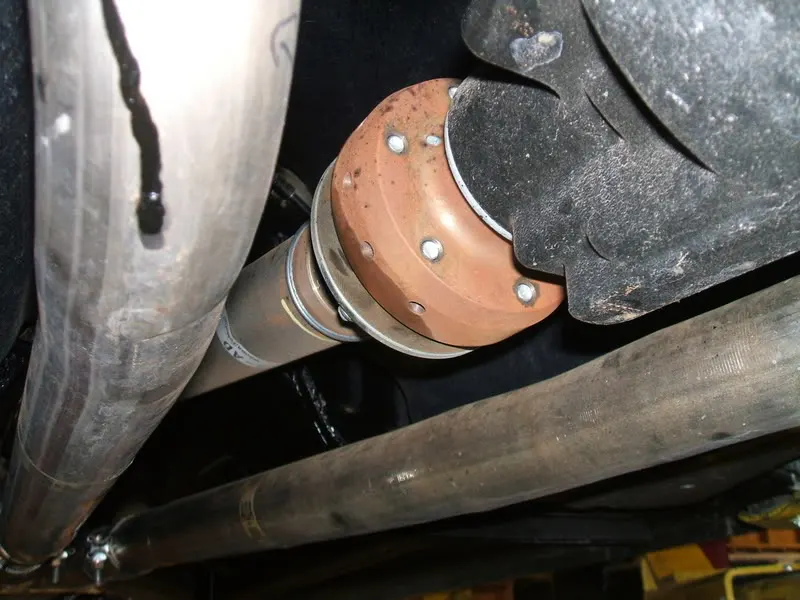

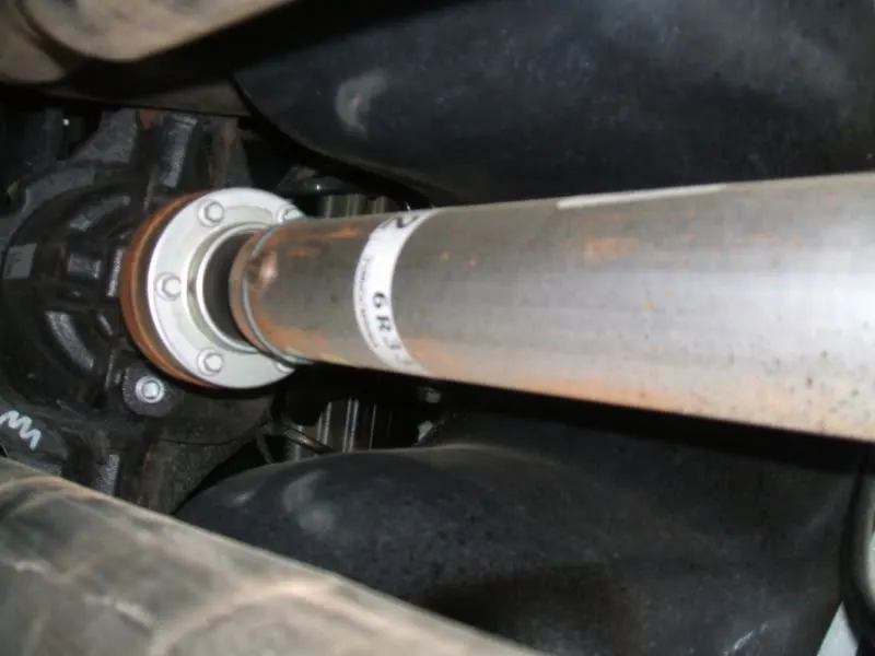

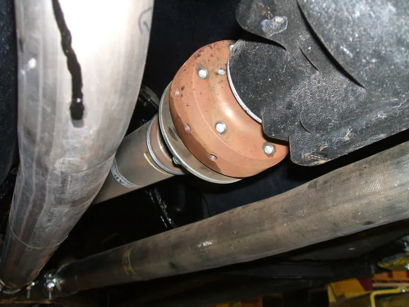

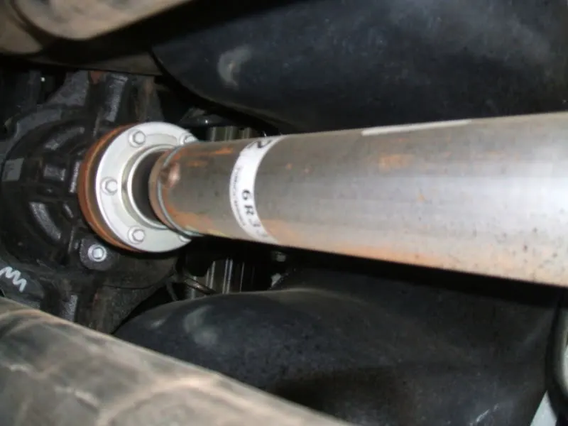

okay I installed the shaft and it took a few combinations on the pinoin yoke to get the vibration out of it. I had to add a hose clamp to get the rest of the vibration out of it. I did install the shaft the way it came, but at the same time the pinon yoke on these cars are different. So that also plays a role in the balance of it all. There is an adapter on the JPC shaft that bolts to the factory pinion yoke. There was a factory mark on the pinion yoke where the factory weight on the end of the shaft would line up. So I installed a hose clamp on the pinion yoke where the factory mark was. The vibrate is almost gone. I even tried installing the shaft 180 degrees and it really made no difference.
Now onto the performance and SOTP feeling. The shaft really makes the cars accel faster. Especially off the line and midrange. I can't really feel a difference at higher rpms but maybe that is because it pulls much harder at low and midrange rpms. Over all I am very happy with the difference in performance with the new shaft. This is a must to have on these cars. I would recommed this mod to anyone. They (the driveshaft shop)are currently making a 3.5in shaft instead of the 4in, because of clearance issues on lowered cars.

Also those four simple bolts take a while to run down because of the clearance between the u-joint and where the bolts go. You can't run the down with a socket, you must run them down with an open end wrench and then run them down with a ratchet wrench or a socket and ratchet. That is whatt takes most of the time. Then when you must removed the shaft to rotate it. It is an even more of a pain in the ass to run them out becuase of the lock tight. There was no instructions on torque specs but:
Use locktight on all bolts
4 bolts where the shaft meets the trans 76 ft lb (Factory specs)
6 bolts where the adapter bolts to the pinion yoke 60 ft lb in steps and star pattern
4 bolts where shaft meets adaptor 50 fi lbs in a star pattern
