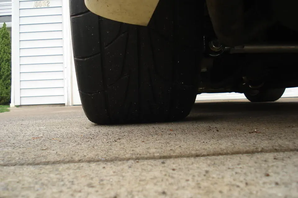

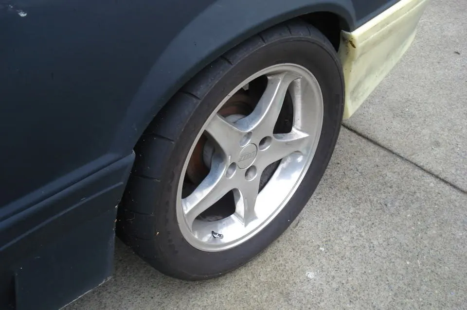

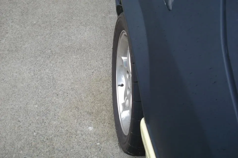

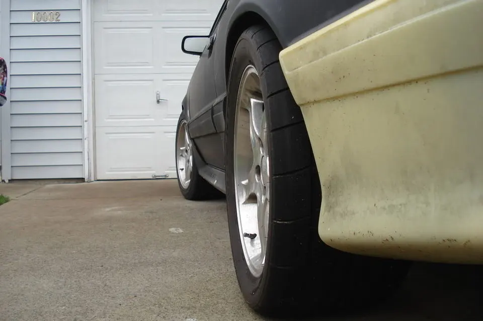

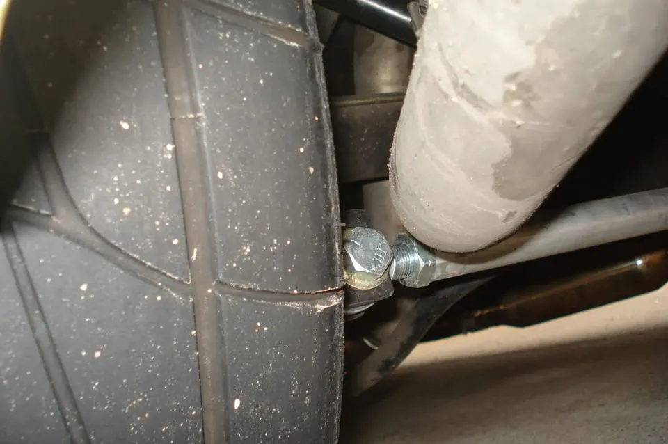

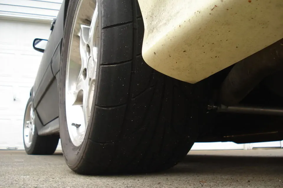

I also have the 315 nitto DR on the back of my fox with 17 by 9's with tail pipes and it is also lowered. I beat the inner fender quite a bit but I could still beat it in more. I'll have to when I do a 5-lug conversion for the 17 by 10.5's that I have sittin in the garage. I'll post pics when I get home from work.
Please excuse the dirt and such I use the stang as a daily here in Washington and we get rain here about 9-10 months every year.
