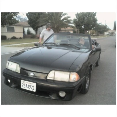

I just added a 90 GT to my family. This car replaces an 86 LX 5.0L Vert which got totaled by the insurance company. It is a nice looking car with 18 year old car issues. (Image attached) The person I bought the car from swaped the engine with a rebuilt unit from a wrecked GT Hatch.
