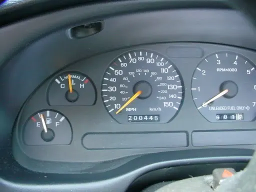

Another Possibe problem:
Just after i really get on the car it tends to heat up in to the "A" part of the temp gauge... Just wondering if it was normal of this car or if i might be needing a water pump in the neer future

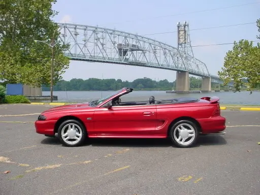

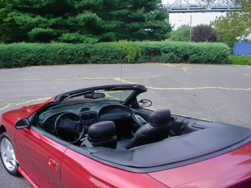

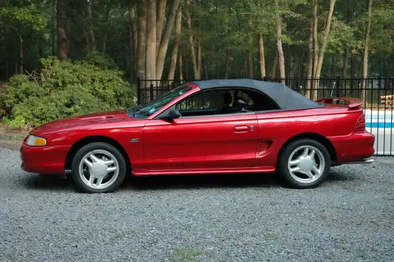

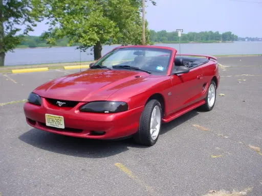

For thoes who are intrested Pics of the car...

It's a good lookin ride Adam - enjoy!

Vert's always seem to get a little leeway when it comes to ET's. If it's 200# heavier, then it should be in the the neighborhood of .2-.3 seconds slower.
I can't believe that you get 601.3 miles out of 3/4 of a tank of gas! Hahahahahahahaha!
It's a sharp car. I've always loved that color.

A is a bit warm. it could be a faulty ground strap (black wire on the drivers side that runs from the motor mount to the chasis near the fuse box) or maybe its just time to change the coolant
