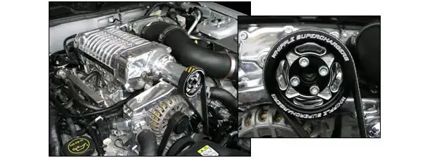

Whipple posted 462, and Procharger posted 525+. None of these companies are in it to blow engines up. You can bet they have conservative tunes, and will be reliable, especially at 5 PSI.

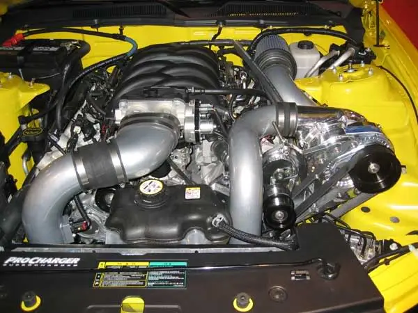

I have verified the Procharger offers 11s out of the box, but I am still waiting on exact dyno numbers and E/Ts.
Procharger will ship in a matter of weeks, and the Whipple, well it may be a while yet... :rolleyes:

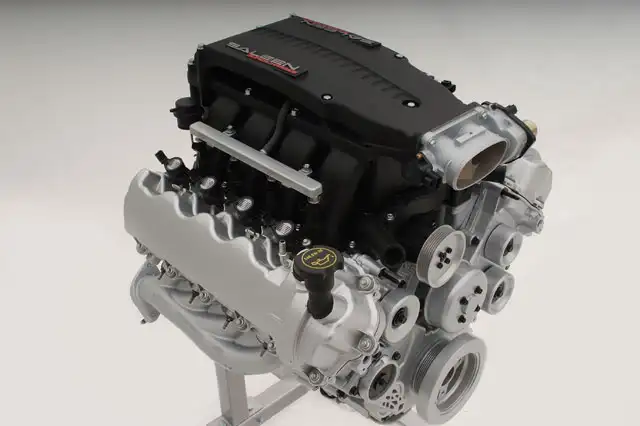

Saleen:
Procharger:
Whipple:

Never had ANY issues with an out of the box Procharger... Largely do to charge temps at ambient!
And check THIS out...
http://www.procharger.com/2005_mustang.shtml
Saleen claims that the 05' s/c will fit under the factory hood, being that is only slightly taller than the factory intake. As far as the fuel system, they say the stock injectors and pump have enough flow/volume to support the s/c. Right now they are testing the 05" Series V setup for fuel requirements( inj. size.,pump) and to see how the factory bottomend will hold up. The 05' series VI uses the larger whipple 2300cc blower. That is way they claim more hp at lower boost level.

I saw the Saleen kit installed today on a local guys GT. I must say that I was more than impressed with the design and the fit and finish of the kit. The setup uses the blower upside down and under the intake, like the old SVO 4.6 2V blower kit did. It's a Whipple twin screw blower. The kit currently is setup for only 5 psi, because all the companies are still sorting out the 05 tuning. The kit fits under the stock hood, and installed you'd never know there was a blower in there. VERY nice kit, and I think one is going to find it's way onto my car for some testing :nice: .
