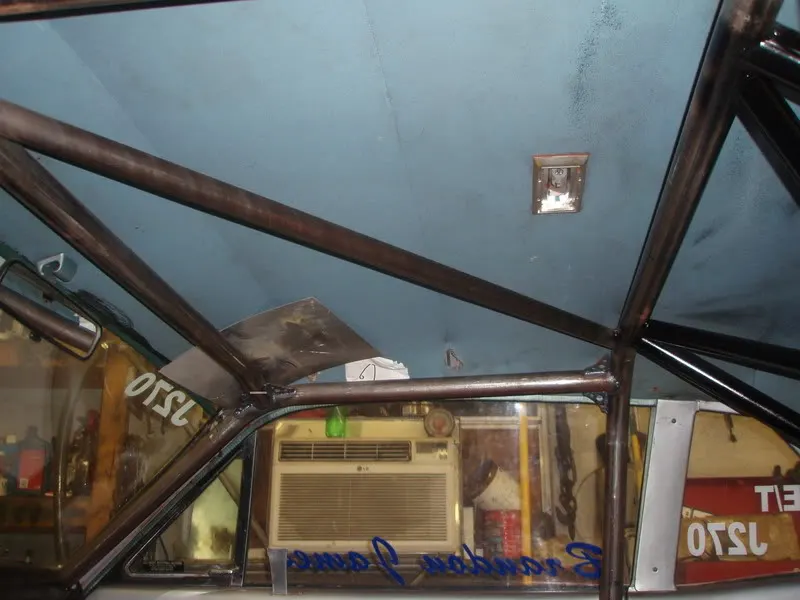

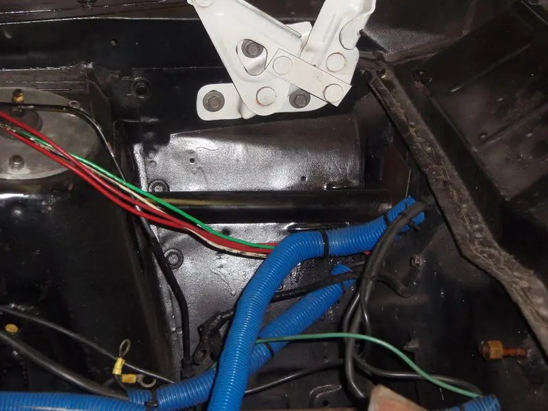

Just drop my car off at the Chassis Shop to get a Cage

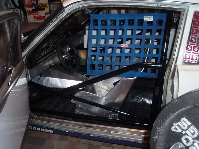

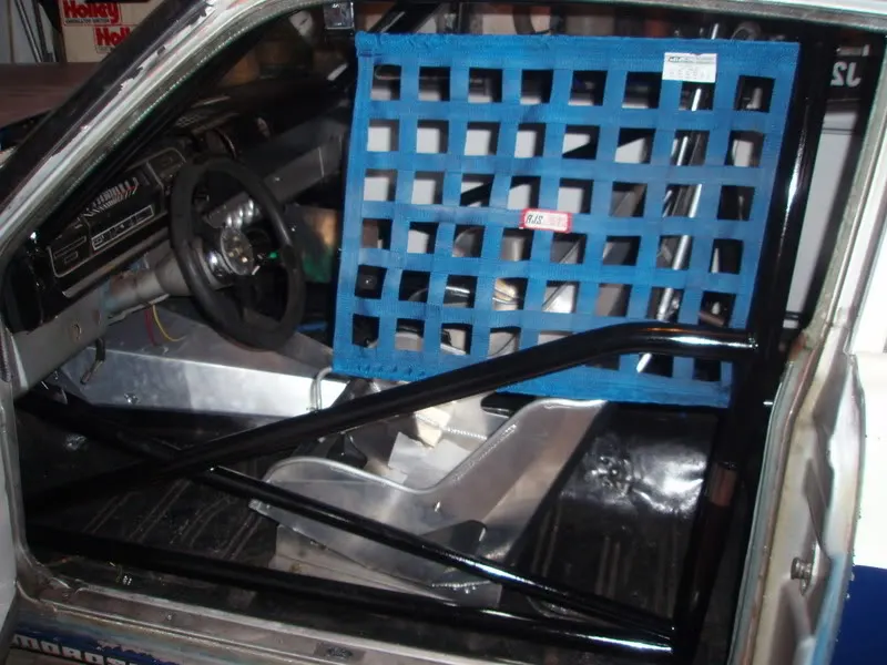

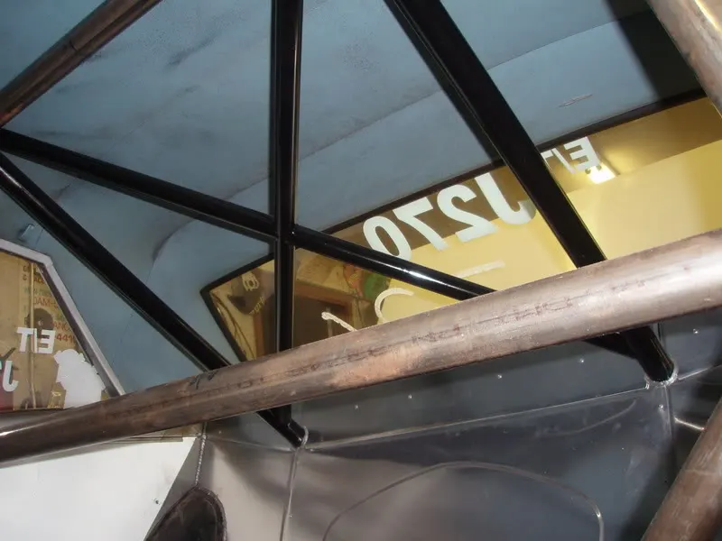

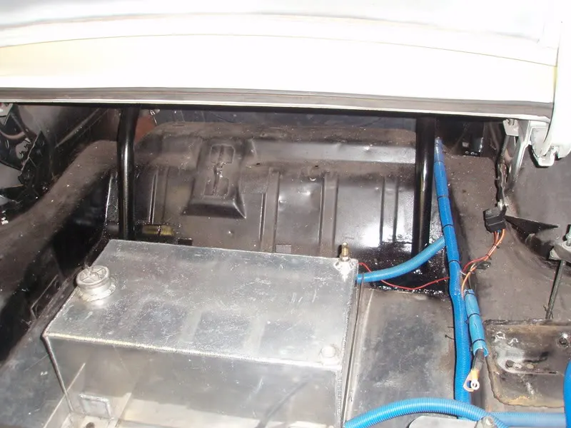

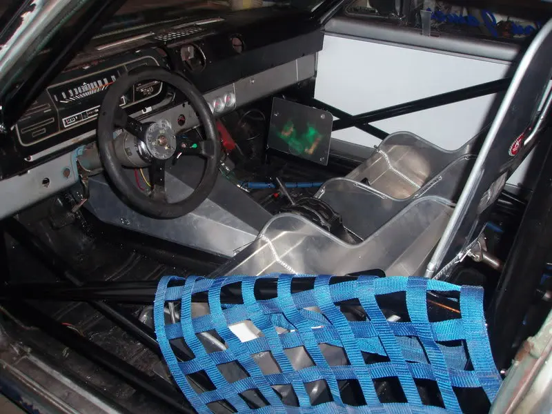

Here are pic of what it looks like when I drop it off last night. I took the old roll bar and everything out of it. I'm getting a 12 point cage and new seat installed. I'll start build the new motor next week. It's going to be a FE 427 stroked to a FE 486ci. Hoping for high 9's on motor at 3200lbs. I also have a Wilson plate system on it. But the car is for backet racing so the Nitrous will only get used a few times. I hope to finish my dads car before I get mine back.

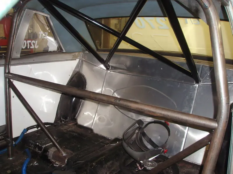

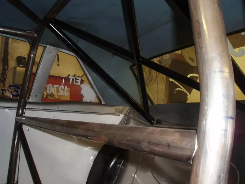

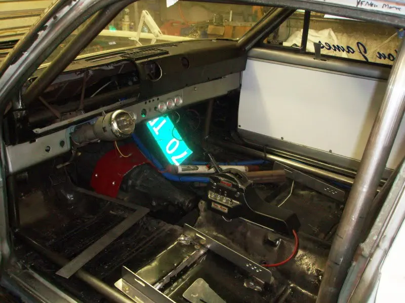

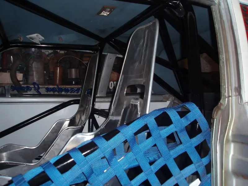

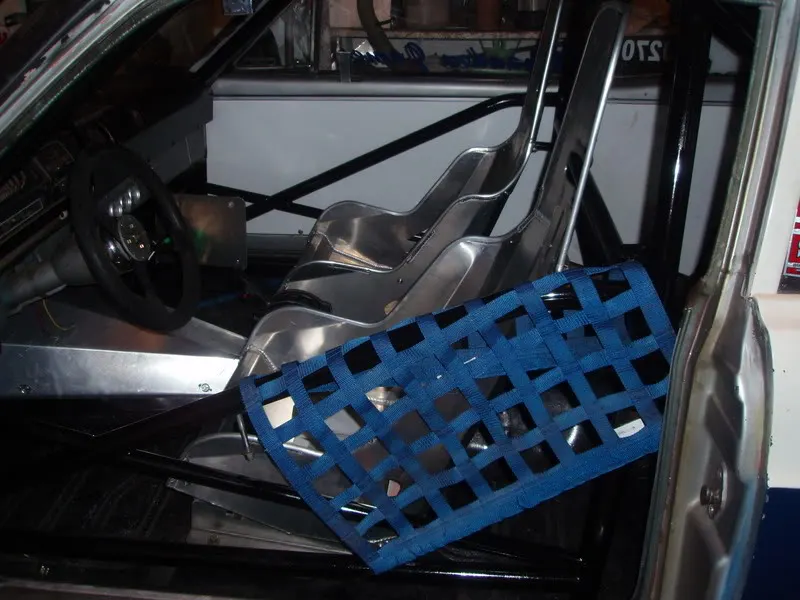

Here some update on my cage it's not done yet but he said by the end of the week it will.

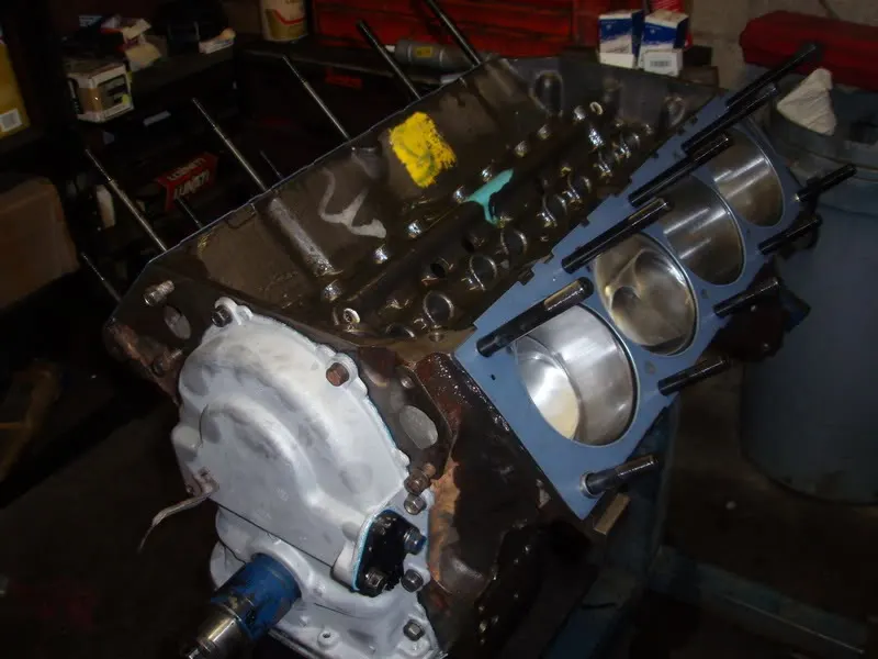

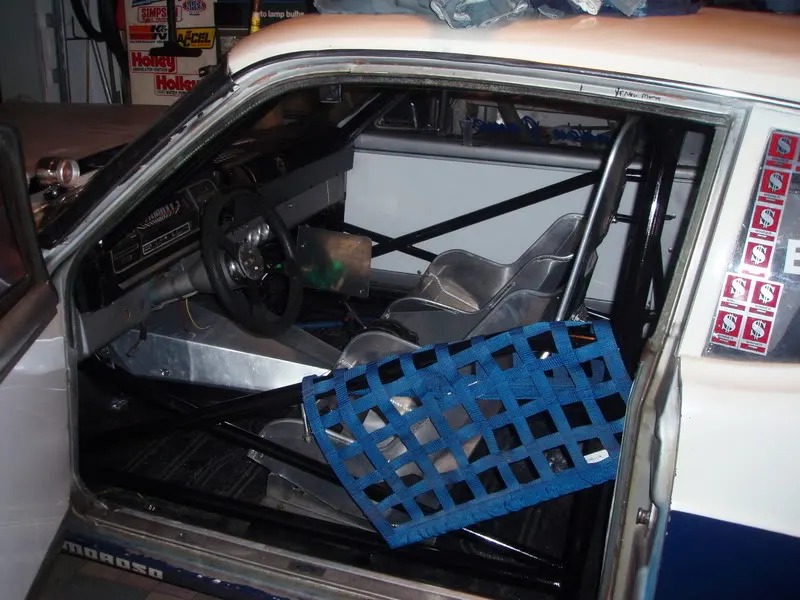

I picked it up last night. I have a few thing I want to do to it before I put it back together. I'm also waiting on my Pistons to be made. I should have them in 2 weeks.

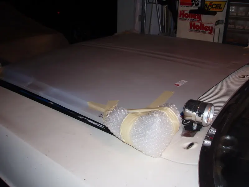

Here is my Fiberglass hood that i will be made in to a 4in cowl hood.

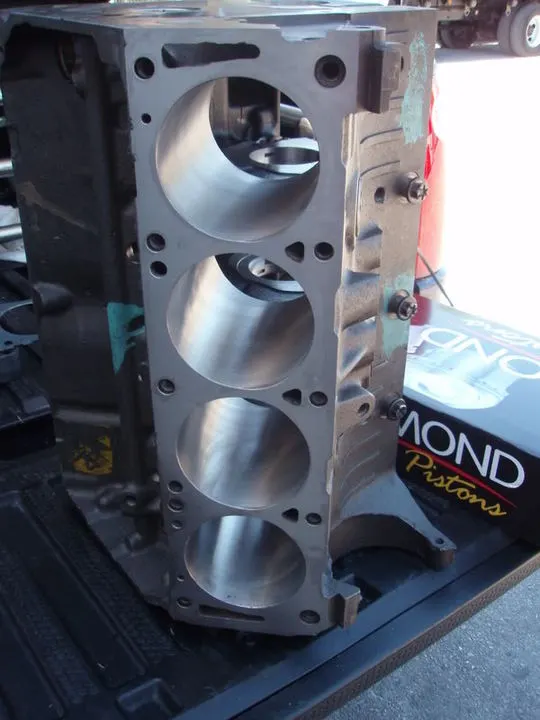

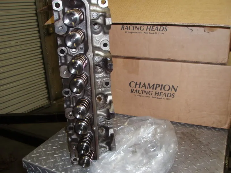

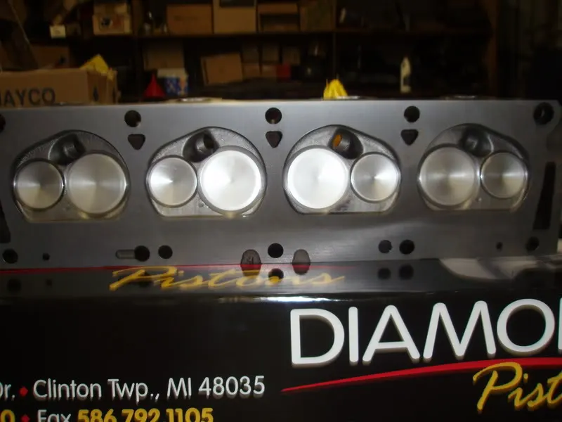

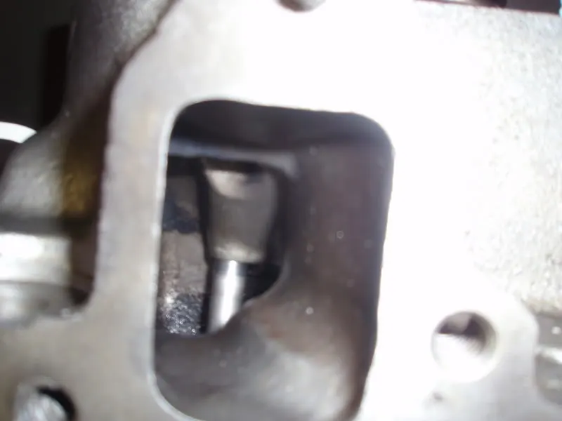

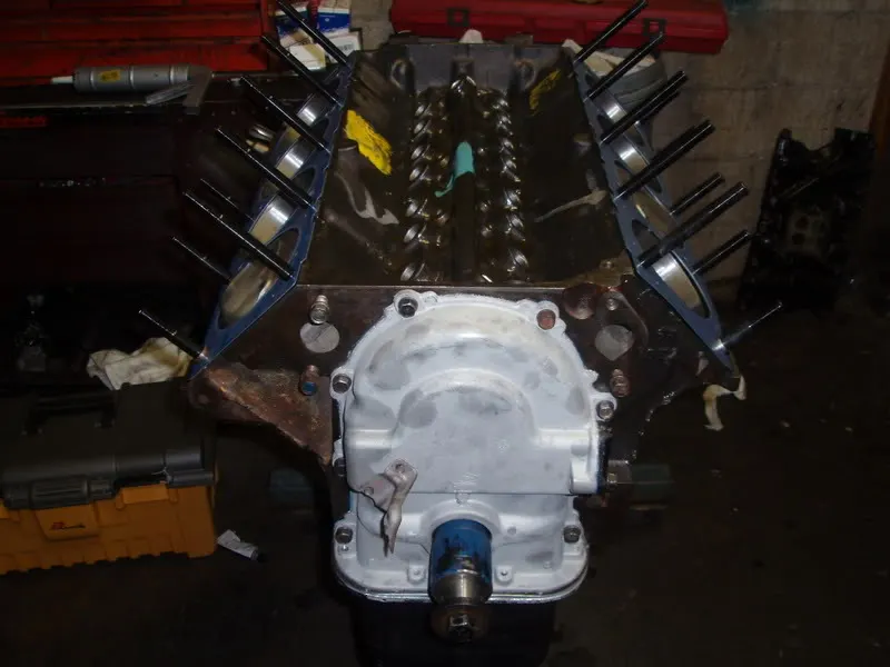

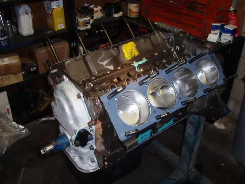

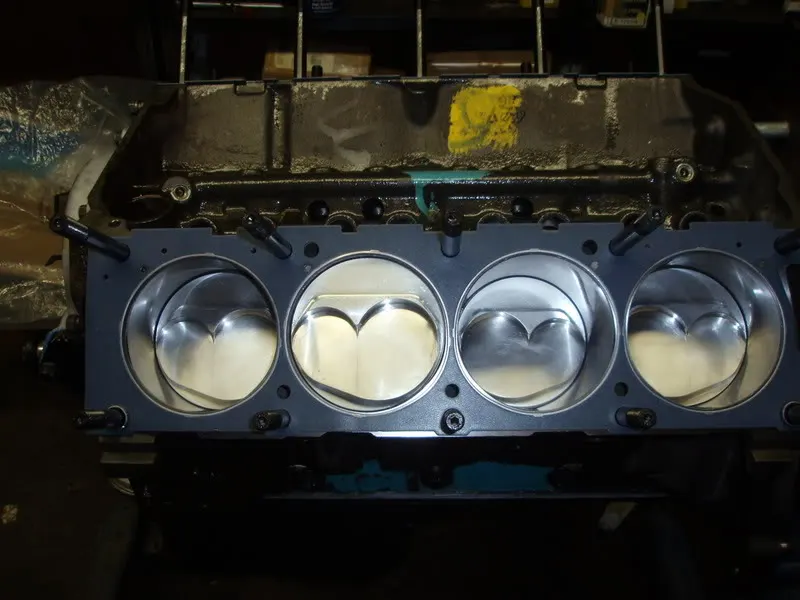

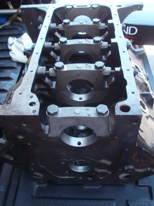

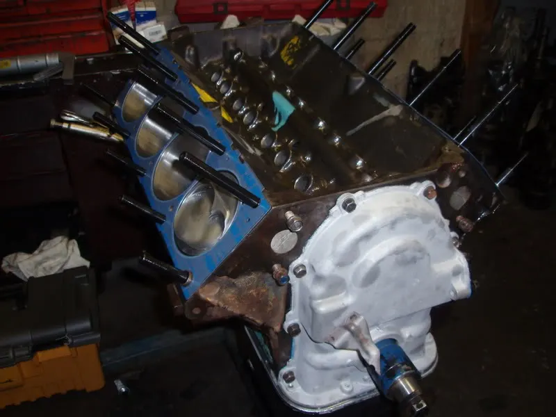

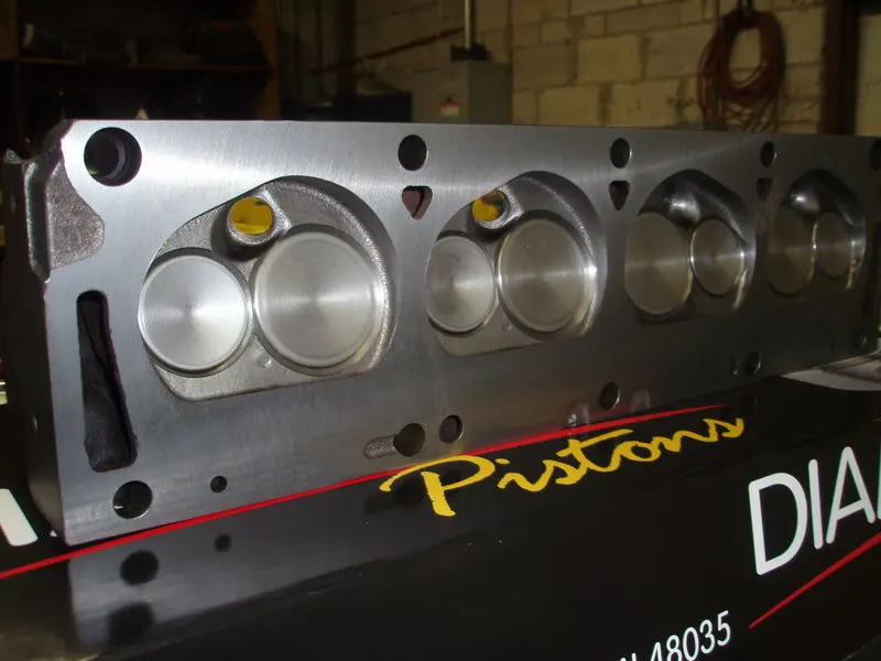

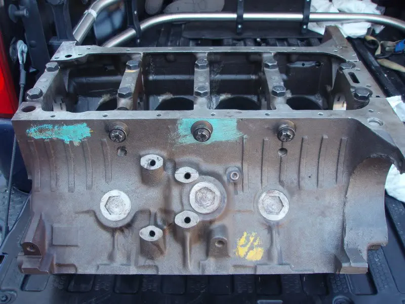

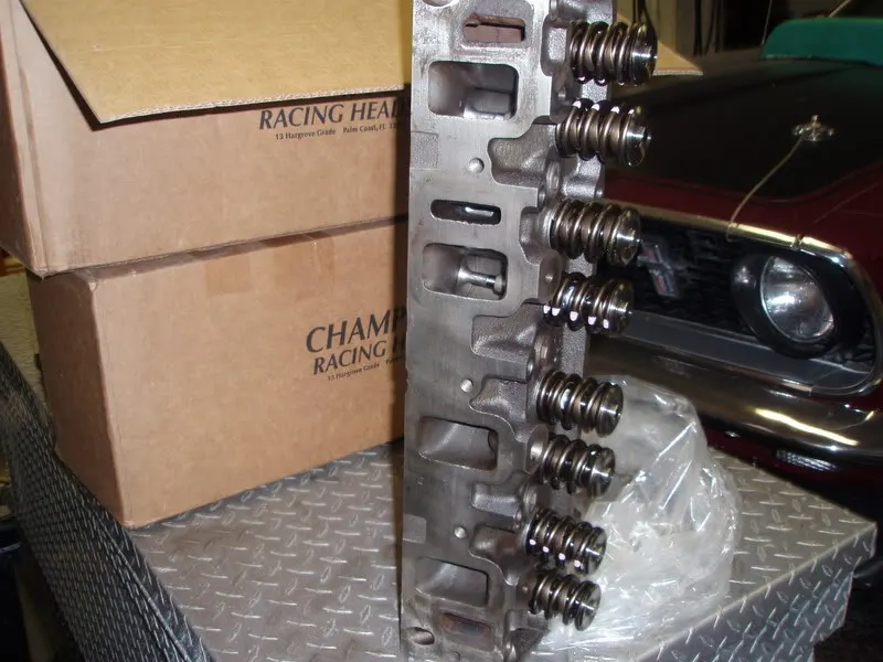

The heads have 70cc which will make the compression around 13.7:1 which is not what I want. I have Iron CJ Head. I want 14.5:1 so I either mill these heads or just put them on they way they are and later down the road sell them and get what they are worth and buy I nice set of BT or Dove alumium heads. The cam I'm running is a comp cam soild roller .740 lift 276in 284ex duration @.050
