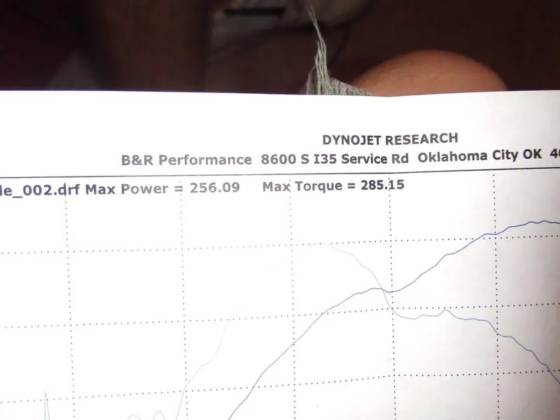

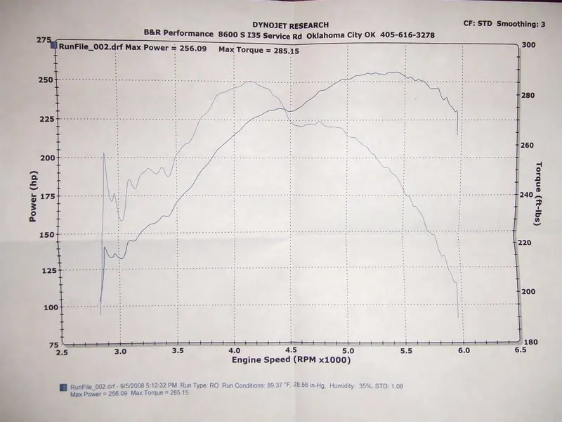

well i had my car put on the dyno today to see where my a/f was at, and just as i thought, it's off the charts with a stupid 10.3:1. i just can't keep this thing from running fat! i'm going to put my 19# squirters back on again and see if that doesn't help some. anyways, as is, it put down 256rwhp/285rwtq on a dynojet. not too shabby for how rich it's runnin. here are some pics of the dyno charts...

get the AFR leaned out, i would be targeting 13:1 or so.... 10.3 is PIG RICH, 10.3 is too rich even for a blown car. i bet you will notice a good difference in getting the AFRs leaned out a bit like they should.
yeah i have a few things i'm going to try to help get the a/f in check. i'm sure there's still a good amount left on the table; he dropped the fuel pressure a total of 3 psi which gave me a .2 increase in the a/f from 10.1 to 10.3 yielding me 7hp. so i definitely think there's going to be a decent power increase once i can get it to 13.2:1
