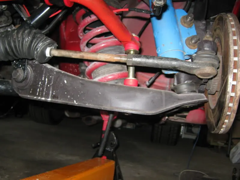

And for some reason i have trouble finding this link and i always loose it... so im posting it here...
Front Sway Bar End Links & Bushings
i measured mine for the correct length... not the best pic

Something to keep in mind. If you need to prioritize funds, do things up front first. The front suspension is much harder to take apart, and you have to get the car aligned everytime you mess with it. The rear suspension is a piece of cake, so it's easy to go back and change things like upper and lower control arms back there later on. It's not a bad idea to change out some wear items up front, like the control arm bushings and ball joints. Make sure you gob the grease on between those bushings. Definately do the sway bar end links up front, they wear out quick, and replacements are cheap. The bump steer kit doesn't honestly help that much, but the outer tie rod ends notoriously go bad on our cars. It's not a whole lot more money to just go ahead and upgrade to the bumpsteer kit over replacing with stock outer tie rods.
