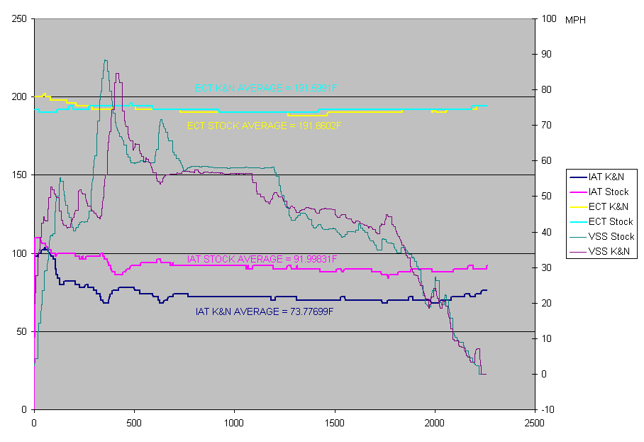

The next run is a 1 mile higway run from one exit to another. I tried to keep the same speed and driving habits so the data can be relevant.
STOCK
IAT MAX : 110F
IAT MIN : 84F
IAT AV : 91.99381F
ECT MAX : 196F
ECT MIN : 190F
ECT AV : 191.8602F
MAF MAX : 19 910GM/S
MAF MIN : 538GM/S
MAF AV : 2376.385GM/S
K&N FIPK
IAT MAX : 104F
IAT MIN : 68F
IAT AV : 73.77699F
ECT MAX : 202F
ECT MIN : 188F
ECT AV : 191.5991F
MAF MAX : 20 707M/S
MAF MIN : 485GM/S
MAF AV : 2511.444GM/S
Right away you see a differene of 18F in average IATs. Since the K&N filter is more exposed, air flowing through the engine bay can be sucked in by the K&N filter. The stock filter being enclosed in a plastic shell, can only suck air from a small area, close to the fender. With K&N you can get IAT as low as 68F. So, once the car is moving, K&N IAT will dramatically drop and will ahve cooler charge than stock even though it's not a cold air intake kit, jsut the fact it can be in contact with the air outside flowing through the engine bay can reduce IAT.
Here's a graph of both runs. You can see those two fine curves, those are the VSS of both runs, in MPH, so you can see the speed are very close to each other in both runs.

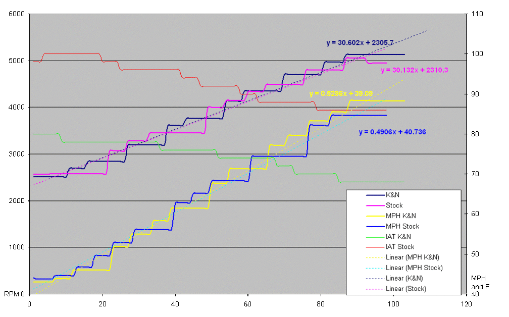

Here's a 3rd gear pull on the highway atabout the same speeds. I've also calculated the RPM curve equation and VSS curve equation.
As you can see, the acceleration with K&N is slightly higher than the stock one. K&N is increasing at a rate of 30.602 RPM/Unit time as opposed to the stock which is increasing at 30.132 RPM/Unit Time.
VSS for K&N is increasing at a rate of 0.5296 MPH/Unit Time compared to the stock's rate at 0.4906 RPM/Unit Time.
The fine red and green curves are the IAT during the run.
