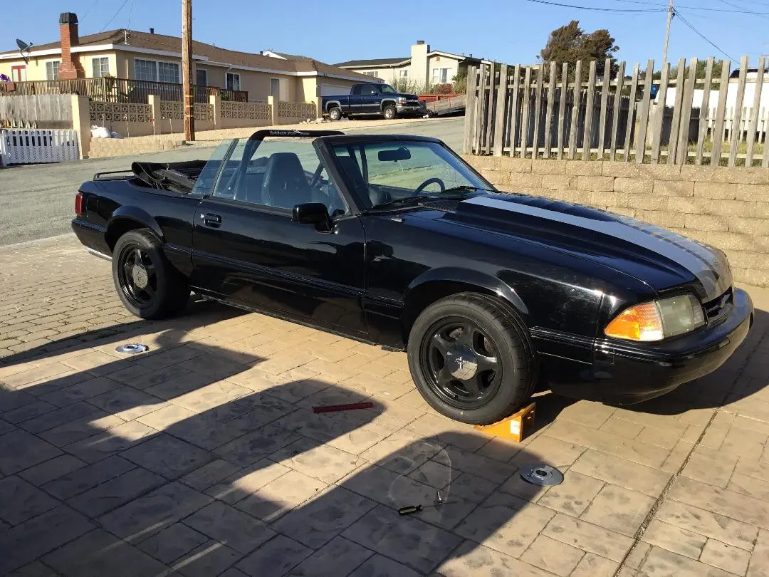

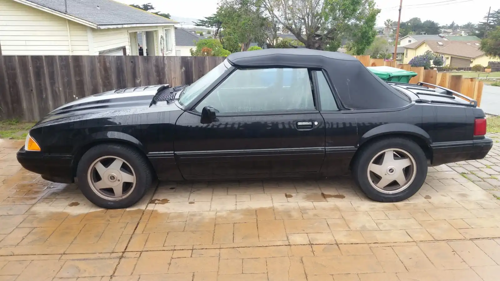

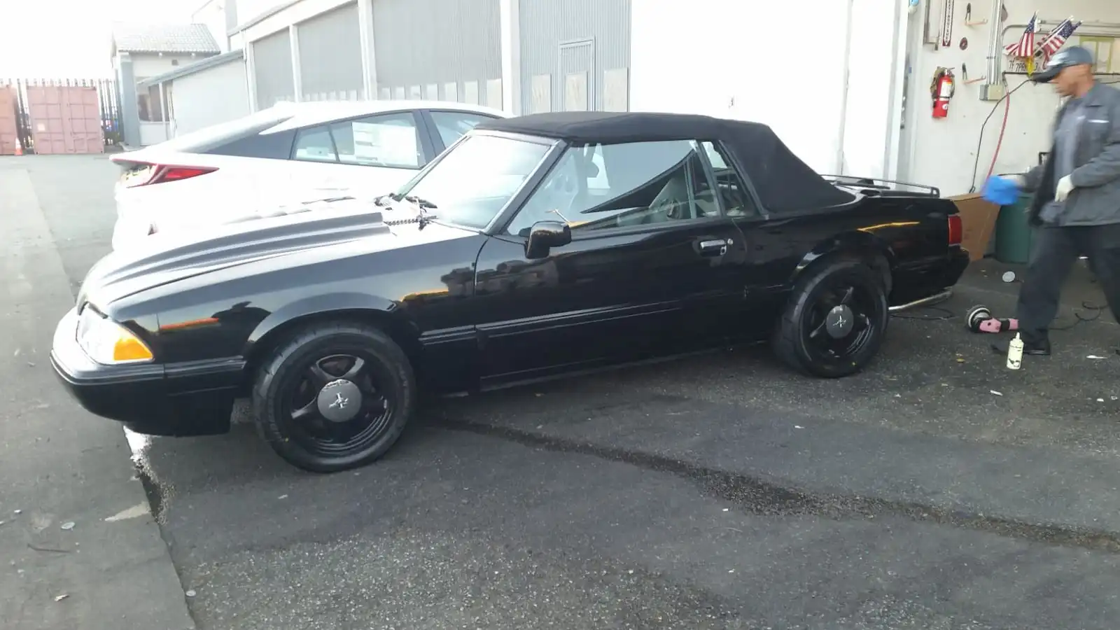

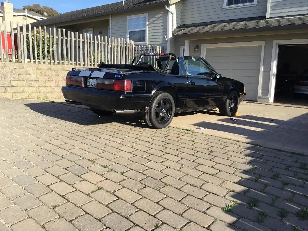

New pipes & new wheels. Do you guys like these black ponies more? I'm not really sure. The old wheels look a little better than they did now that they're cleaned up:
Oh, I also added some old black pony floor mats, too. I think those mats are a nice touch in the interior. I didn't grab any pics of the interior before I took it back to the detailer.
I don't like that the tire is a lower profile on the ponies, but I don't think that's the issue. Black doesn't come out too well in the pics, honestly. I think it looks alright both ways, but neither really pops for me. Probably silver ponies would be best, but unless I get a direct trade for either set, I'm not going to keep sinking money into it.
It sure as hell looks better with exhaust pipes, though. Right? It does to me, anyway.

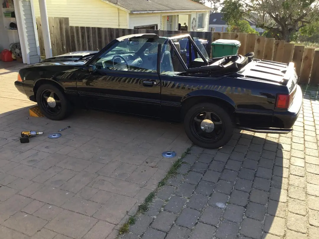

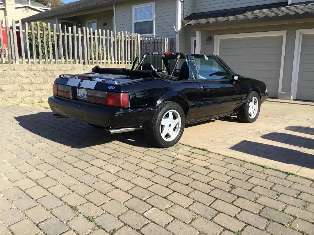

Before:
After:

It was a frustrating process to get them aligned right. Lot of cutting and rewelding pipe. They've got a nice upward rake that stays with the body, now. I was actually impressed with the quality of the stainless steel. It was hard to cut, and utterly non-magnetic for the welder ground. I was not so impressed with the fitment on the driver's side. It really wasn't even close until I cut it into 3 sections and my buddy rewelded it. I wonder if these LMR deals are made in China.
I think I'd like it better if the pony wheels were argent and the febder gap wasn't so large.
The black wheel just look black. No style
Yeah, I'm thinking that way too. These wheels have a really nice set of tires, but the low profile doesn't look great without lower springs (C's or B's would be good, but don't think they're made anymore. I might list 'em for trade locally if I come across a clean set of silver ponies.

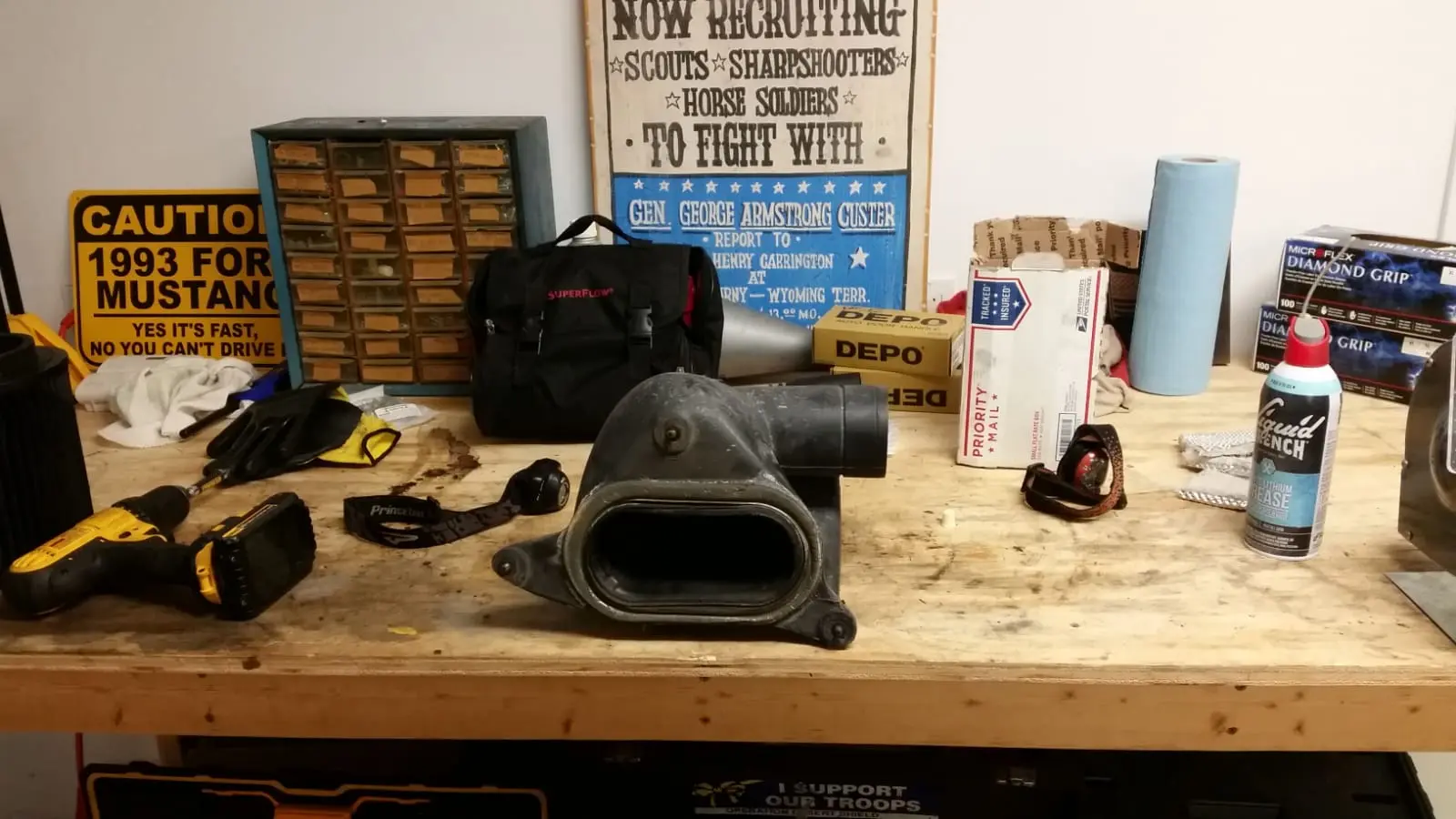

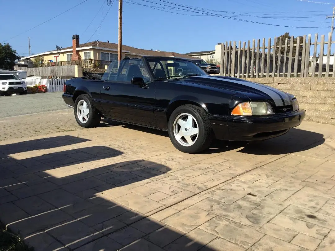

Damn... I haven't seen one of these since the '90s. I didn't even remember how it looked, lol. I apparently got the only fox left in America that still had one. I removed the conical "hot air" engine bay filter (cut off on the left side of the picture), and replaced the stock airbox with a K&N flat panel filter. Plugged 2 exhaust holes, found a loose header bolt and tightened it down. The throwout bearing started making some noise, so I hit it with some lithium grease. Hopefully, that'll keep it going for a while. Replaced broken temp knob, wipers, & door striker bushings. ID'd that the clutch is nothing special. It's a LuK, and it looks pretty plain jane. LuK doesn't really have performance clutches. So, I'm actually a little surprised it's holding the power.
