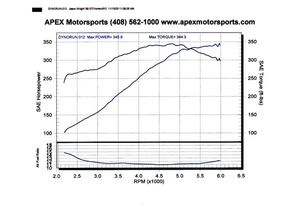

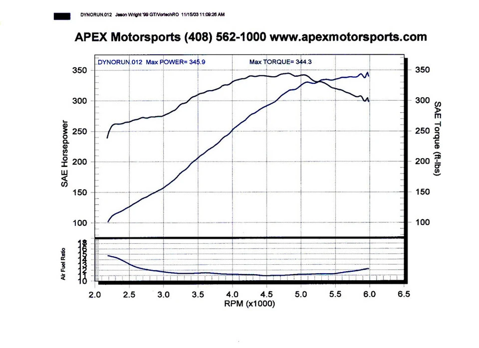

No need to be rude dude. :nono: Just take a look at your own dyno chart. It's all the proof I need to illustrate my point. The KB torque figures hit hardest at about 3600rpm to the tune of 420ish lbs ft/tq on all runs and falls off to a hair above 350lbs ft by redline. This is also about where that strait line horsepower curve starts to deviate as well. A similarly tuned Centi kit won't pull as hard down low, but will pull higher and harder as RPM climbs with the curve getting steeper not more shallow. It's not a poke at the KB, it's just the nature of the blower. I wasn't insinuating that KB's wouldn't pull to red line, I only stated that they didn't pull to red line as hard or as high (rpm wise)as a centi in comparison.

I was just comaping those two graphs and I noticed 2 interesting things.
1.) I noticed that the Vortech car's hp started to "laydown" at about 5500. BY that I mean it's upward growth started to level off.
2.) The Vortech car never made it to 350 ft/lbs of torque. The Whipplecharged Saleen STARTED at 350 ft/lbs climbed to over 400 and never dropped below 350 again. Plus hp just kept steadily climbing and climbing, never surging or falling off right up to redline.
A rough average of those two graphs shows the Vortech with about 311 ft/lbs between 2500 and 6000 rpm and 254 hp between 2500 and 6000 rpm.
Over that same rpm range, the Whipplecharged car made average numbers of about 398 ft/lbs and 315 hp.
When you look at the graphs for those two examples and the peak and average power numbers, it's pretty evident which is the better car.
Peak numbers mean exactly ZILCH. You have to look at the "area under the curve" or in other words the big picture.

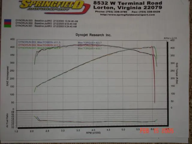

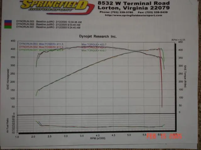

To support 2000_4.6 and confirm what he says, here is my dyno in comparaison.
That's at 9psi on 91 pump gas and no other mod that the saleen borla cat back.
Note that power is still climbing at 6000rpm...
Man, our dyno's look almost identical. Great numbers!! Isn't it amazing that KB is so good at what they do that they can create identical looking results with an "off the shelf" chip without even touching the car.

That is very interesting!! FYI...the Saleen (00s281sc368) is a Kenne Bell 1.7L....not a whipple.
