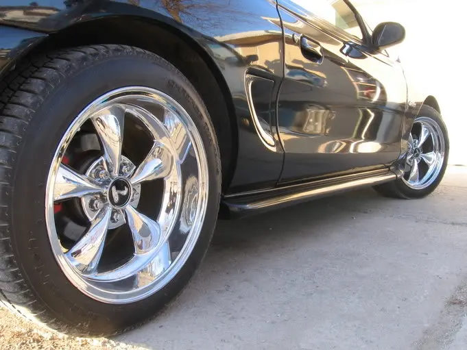

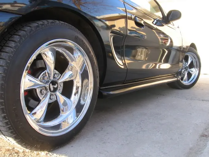

i love mine also , the KDWS tires are A1
