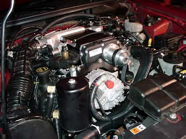

I have attached a picture of the engine compartment that show the completed job. :D :D :D :banana: :banana:

Engine bay looks sweet! :nice: I can't wait.
