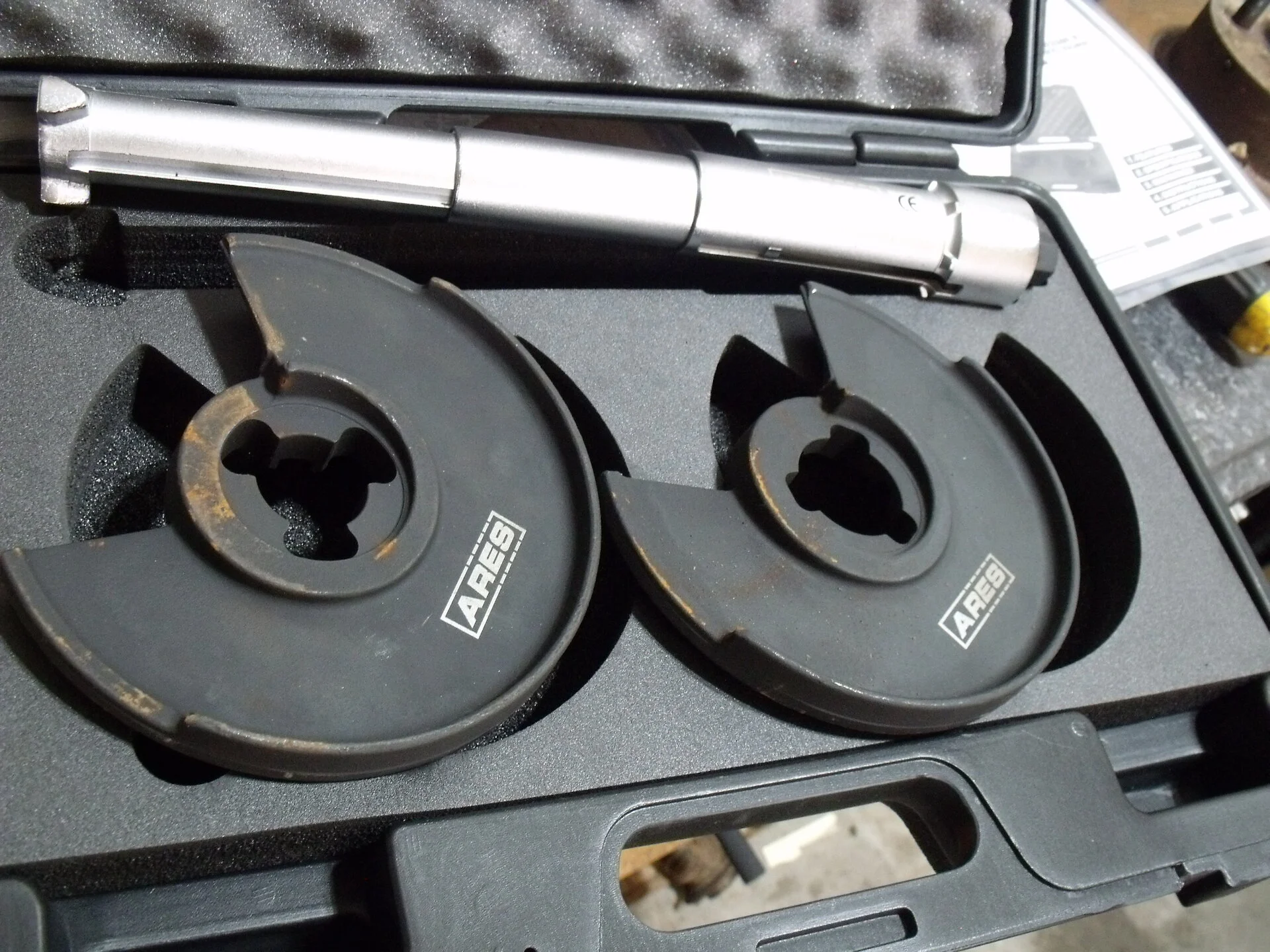

Ok so the saga continues.....
the fancy dancy compressor I purchased will not work... The discs ( see pic) will not fit in between the coils... Just my luck....
Looks to me like the only kind that will work would be the kind with the "claws" at each end or the kind with the claw at one end and the flat forked plate at the other.......
Any recommendations?

I've seen some use several large steel hose clamps to compress the springs. Not the safest probably, but If you used enough of them I would trust it.. using those you can probably compress the spring enough to disconnect the ball joint, then drop the spring out the bottom, perhaps it may need some prying with a pry bar but I'd bet it would come out.
You could also try compressing them with several ratchet straps, then when you get some compression on them, before you disconnect the lower control arm ball joint, add some mechanics wire on them as a safety.
I never had any luck with spring compressors on foxbody mustangs. Many just don't fit. The rear springs are not nearly as hard to change but still require some caution.
Maybe the hose clamps and the 2x4s from engine cradle to ceiling joists would be best? It's harder with no engine in for sure as you know.
Good luck and be safe. If you try something and it seems too sketchy, stop and reevaluate.
Honestly, regardless of how careful you are, doing coil spring work always has a degree of sketchiness to it. You just have to be as safe as you can and really pay attention to things...(and where your hands, face. Arms and legs are located at all times)

I’ve done it with hose clamps. Not the safest.
Let me ask you this, if you put a Jack under the balljoint, can you compress it upwards at all with the weight of just the chassis?
If you can, you can likely just unbolt the strut and lower down the A-arm. As long as there is enough weight to let you raise or lower the arm then it’s possible.
If there isn’t enough weight and jacking up the balljoint lifts the whole car then do not unbolt that strut. You’ll have to hold the spring compressed
I haven't tried that yet, I will give it a try.....
It will immediately lift the entire car if you jack under the ball joint with no engine\trans in the car. There is little to no compression, especially with stock springs

What about adding weight to the k-member to simulate a motor ? Several 50lb bags of sand/concrete/ whatever…. May be enough to get the springs to compress under the ball joint?
Just trying to think of some safer alternatives to the sketchiness of doing it with no weight.
Fail.... LOL.....
If I screwed a couple of 2x4 to the ceiling joists, attached two 2X6 to them, running the 2X6 down to the K member and ran bolts through them into the motor mount area of the K member, that might work?
