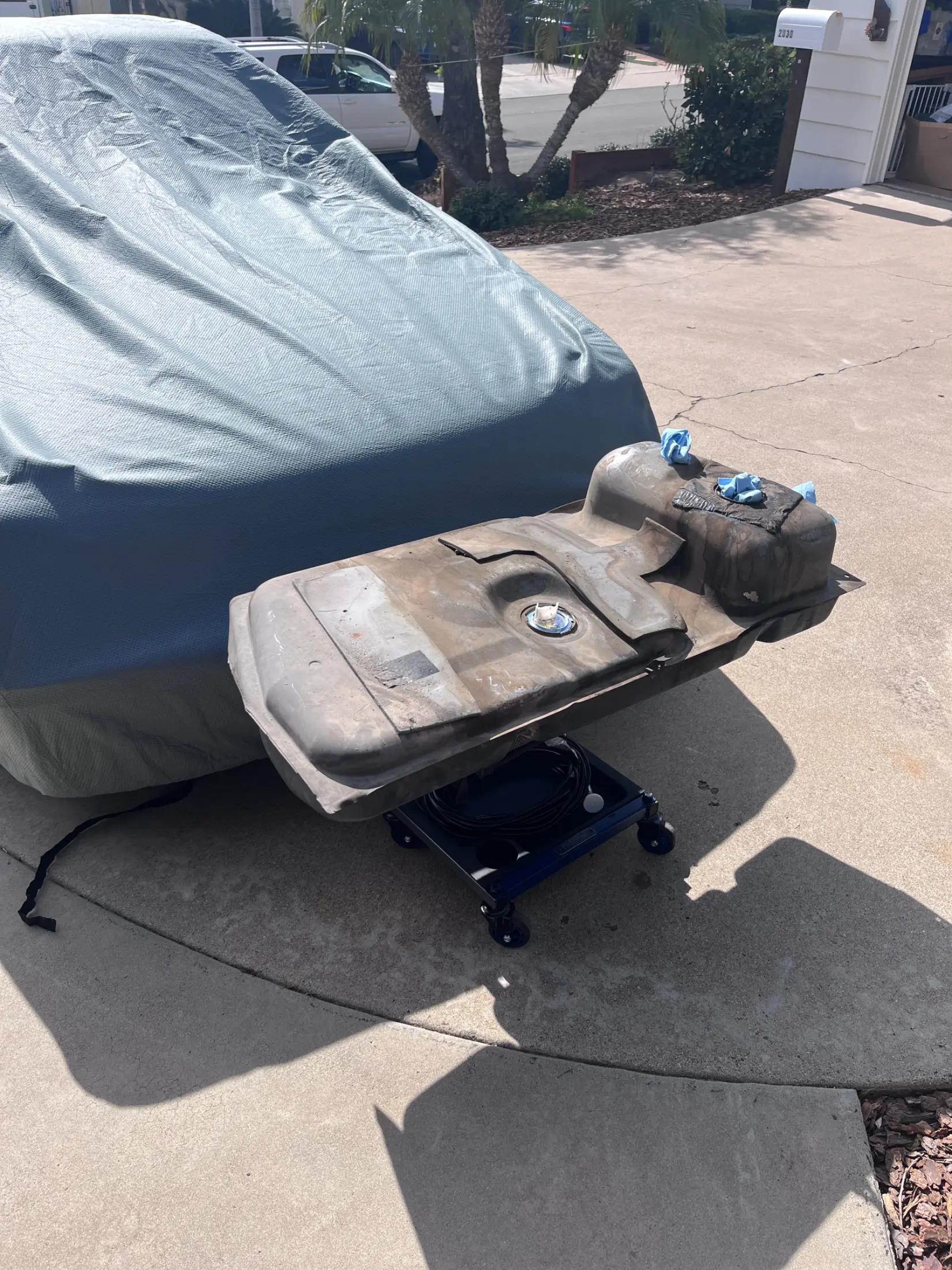

So I remove the entire tank, set it on a rolling cart just to get it out of the way and so my neighbors don’t see a gas tank just chillin. I literally cannot see the filter looking from the top or the filler neck hole. Murphys law, I can’t find my super bright flash light, of course. It’s super bright outside which makes looking in the holes that much harder.
Here’s where I’m at lol

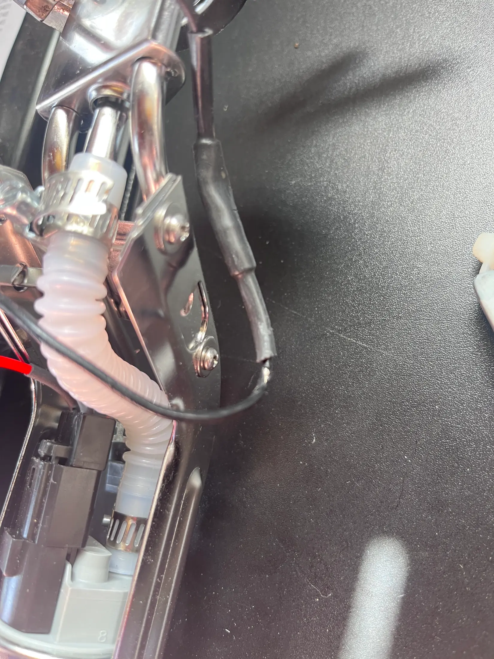

And here’s another damaged wire upon inspection (after I fixed the red wire). Both must’ve got cut when spinning the assembly around multiple times trying to get it in:
So now I’m just gonna order a new pigtail and start fresh with the wiring. Two damaged wires with patchwork fixes doesn’t give me the warm and fuzzy.
Any tips on looking for the filter? For some reason I thought it would float but I think it’s sunk and is chillin somewhere in the back of the tank. There is fuel in the tank but I ran it down to like an 1/8th tank knowing it would help make the job easier.

Sock filter will sink to the bottom. Tilt the tank up so the filler neck end is the lowest. There is a baffle that the sock filter and bottom of the pump sits in so that when the tank is low on fuel it doesn’t slosh and starve the pump. My guess is you will have to fish the filter from around that.
Bummer cause I can’t tilt the tank too much without gas coming out of the filler neck hole. I’ll figure it out somehow. Guess I could drain gas into a bucket or something.
Got my new pigtail… had a go at soldering the two wires together. Watched some YouTube videos on soldering… placed my solder gun underneath the wires, got them hot enough to melt the solder above the wires but the solder didn’t like ‘sink’ into the wires like in the YouTube videos, it just made like a mound of solder on top of the wires.
Then I couldn’t get the wires hot enough again to melt the solder even though I just did what I previously did. Lol
So anyways, cut that mess out and was just gonna butt crimp them together like the directions say anyways, and ran out of heat shrink large enough to fit over the butt connectors. So ordered more heat shrink and will finish the job tomorrow.
Im getting dangerously close to running out of usable wire on the pump assembly side though.

As for the issues you had above, it sounds like your iron is not hot enough.
I have a 60W Pen iron that I use for small work and a 120W with a half-decent stand for heavier stuff.
