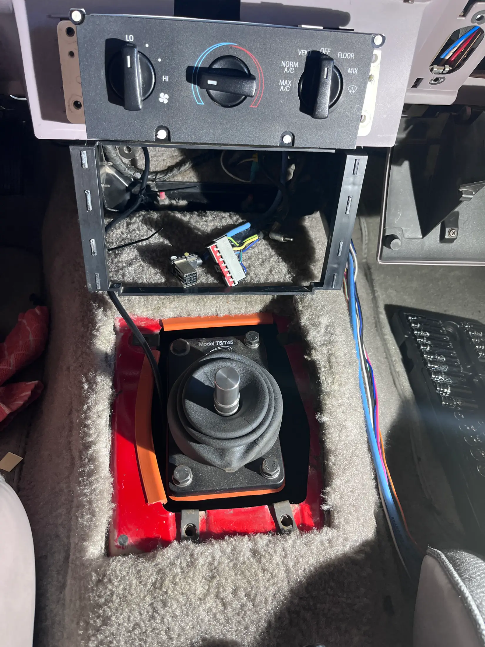

Got the wideband wiring ran down through the transmission/shifter opening. For now I’ll secure the wiring and sensor under the car until I get the xpipe dropped and bung welded on:
Thanks! I know there’s members here who do way more involved stuff, in less time, but I do have a sense of accomplishment for myself. Can’t wait to get her out on the road more.
There's also a bunch of members who have done less, gotten frustrated, and quit for a long time. Don't compare your work or how fast you get it done to anyone else, just enjoy what you are doing and enjoy the car. You should feel a sense of accomplishment, that wasn't a small job.
