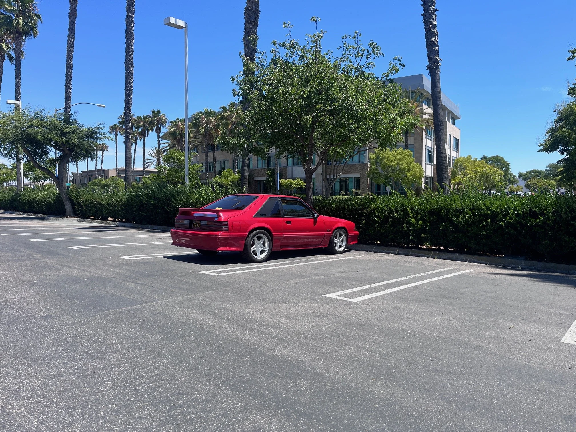

Also was able to drive her to work today:
I noticed i get a lot of rear end movement going over bumps, like for example going on a curved on ramp or interchange between freeways at higher speeds while turning, if there is a bump in the road the car really wants to kick out from the rear. Need new shocks? For those who don't remember my exact setup, i have H&R Race Springs, unknown condition Koni orange shocks, MM HDLCAs, and a stock sway bar. I wonder if the H&R Race springs are too low for the Konis to keep up.

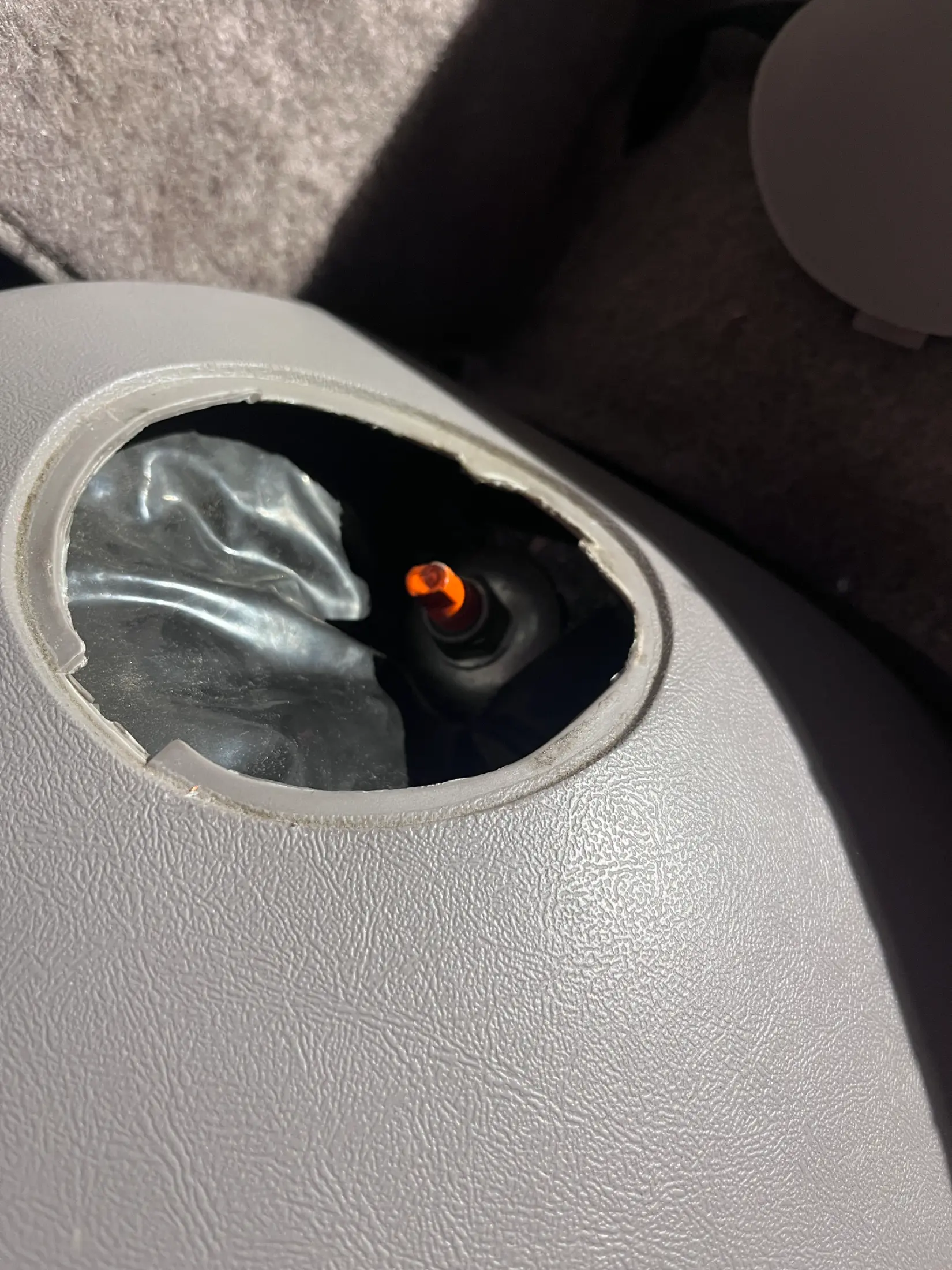

Alright possibly dumb question but I’m just trying to make this go quicker than maybe it has to be. Do I need to remove the interior hatch panels to loosen/tighten the top of the shocks? Obviously a socket won’t work because it just spins the shock shaft. I was trying to use crescent wrenches but it’s not going to plan with the little hole available.
If I need to remove panels I will, just hoping someone had a trick to share.
I have both bottom bolts out for each shock.
