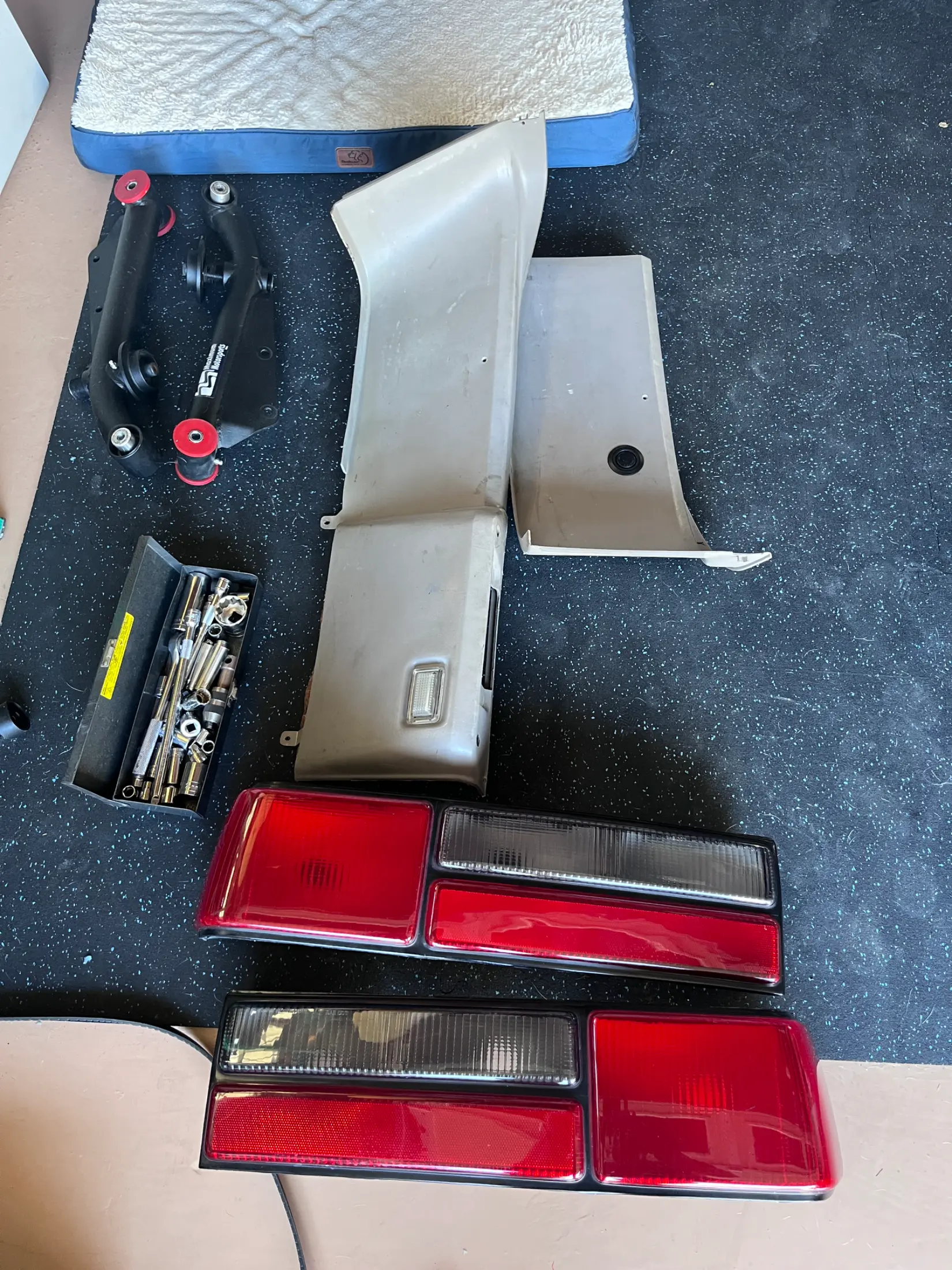

I also ordered 93 cobra taillight lenses since they were finally back in stock.

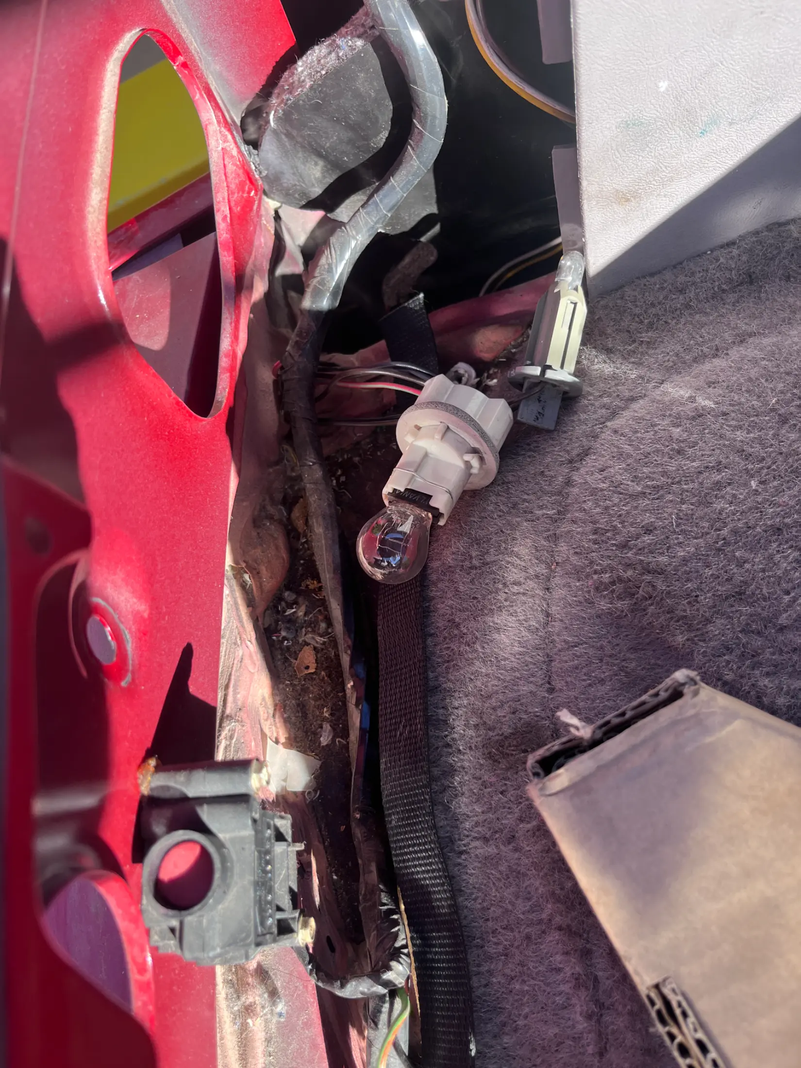

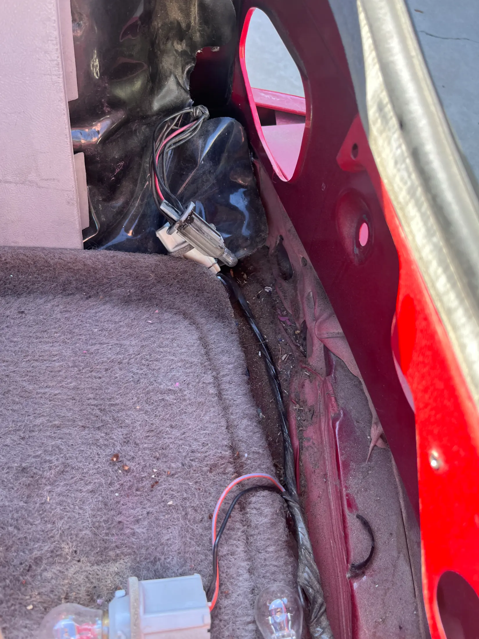

Now I understand that you’re not always poking around behind the taillights and under the spare tire board but thishahaha, you remind me of my favorite youtube car guy, Chris Sullivan. He's big on cleaning all the crap you can't see (not that I disagree) and is very much a "while you're in there" kind of car guy.
drives me nuts, I can’t have it this dirty. Hahaha, again, I don't disagree. Which is why I sent my car to @95steedamustang for the build cause he's so OCD he has to "show quality paint" the underside just because he will know.Now I understand that you’re not always poking around behind the taillights and under the spare tire board but thisdrives me nuts, I can’t have it this dirty.
The engine too, so much dirt and grime everywhere, if I did have a leak somewhere I’d never know!

Even as dirty as it is in the unseen areas, I assure you, yours is in FAR better condition than most and lightyears ahead of where mine started.
