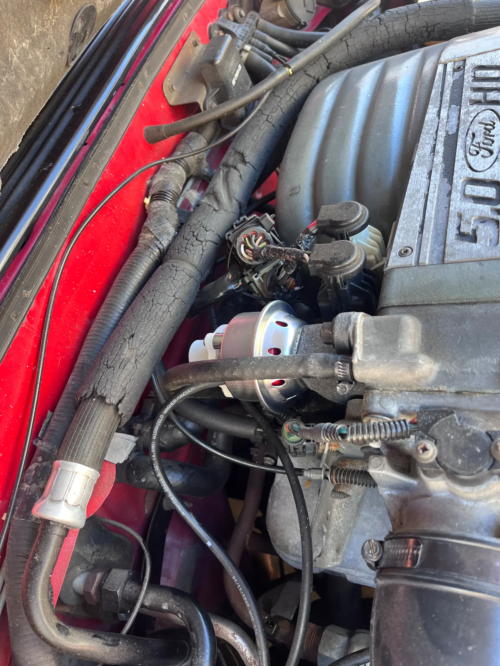

Replaced my EGV valve and sensor today. Was getting code 34 so hopefully this will clear that. Pretty simple job, of course both tabs broke on the sensor when removing it from the original EGV sensor. But it went on snuggly on the new sensor.

One thing i noticed that was different between the new EGR Sensor/Valve compared to the old one was the old sensor used Nylock nuts to attach to the valve whereas the new one just uses small bolts. I'm wondering if i should have used some Blue Loctite on the bolts, or just periodically check them for tightness?

Nice, well the new EGR valve/sensor cleared my code 34. Now i just have Code 67 which i just need to install the Neutral Gear Selector sensor in the trans. Hopefully that clears that then i can finally run KOER tests.

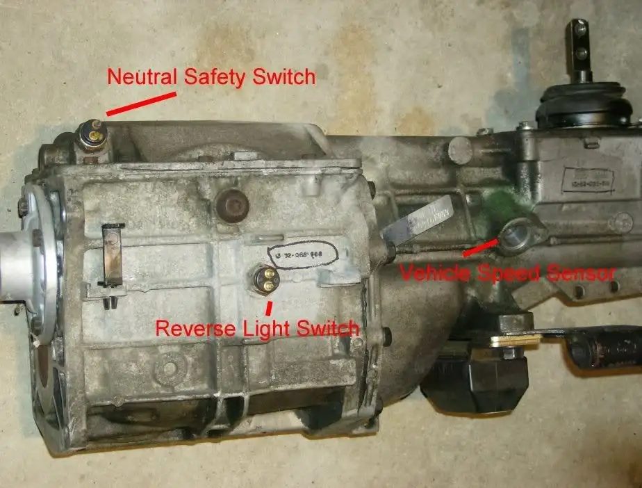

Sorry I may have used the wrong acronym again, I think I was referring to the neutral sensing switch as shown in this photo:
Which I think is located at the forward top of the transmission per this photo? I just googled code 67 fox body and a few different articles referenced this sensor.

They are referred to as neutral sensing switch and neutral gear switch. The one thing they are not is a neutral safety switch as they have nothing to do with the start circuit.

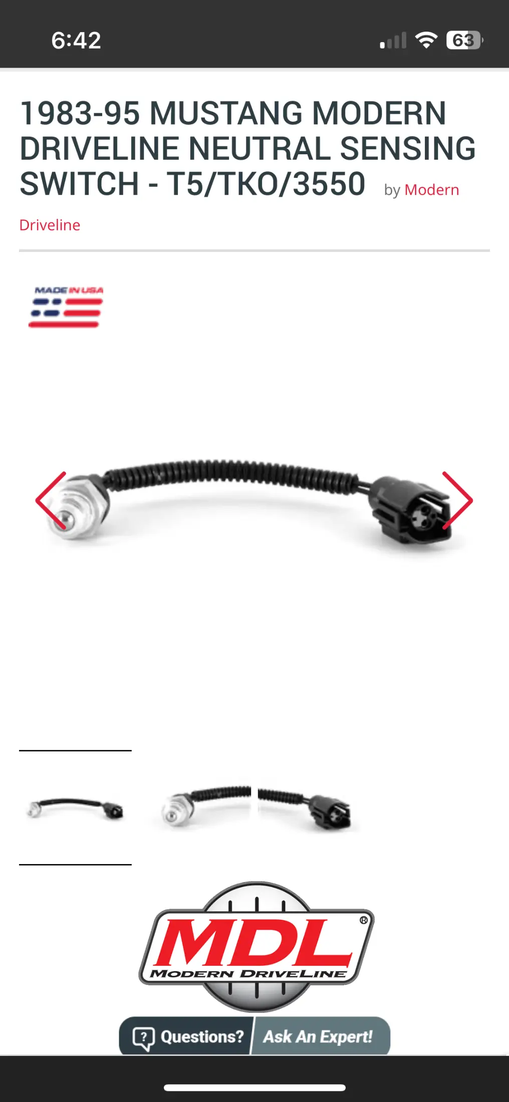

This is what I ordered and plan on installing:
Is this located where the above photo says ‘neutral safety switch’ and the photo is just mid-labeled?

That will install in the top cover and go from the switch to the connector on the harness that comes through the trans tunnel.
