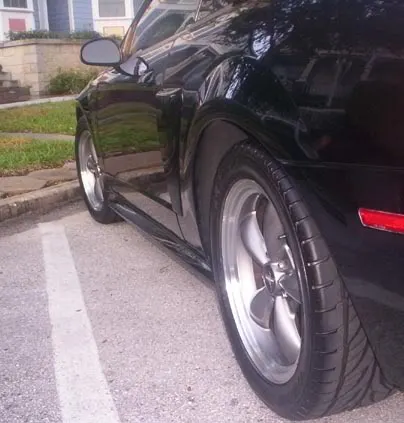

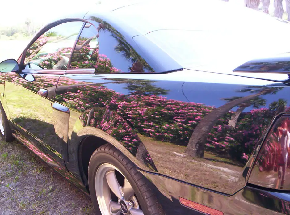

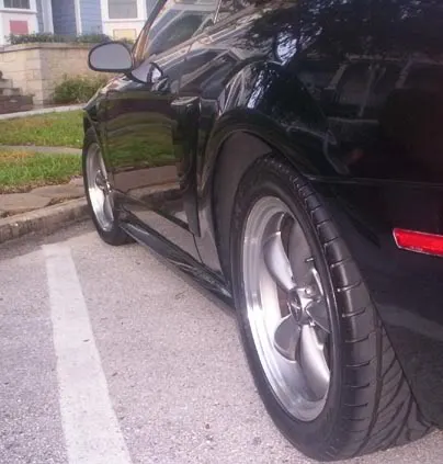

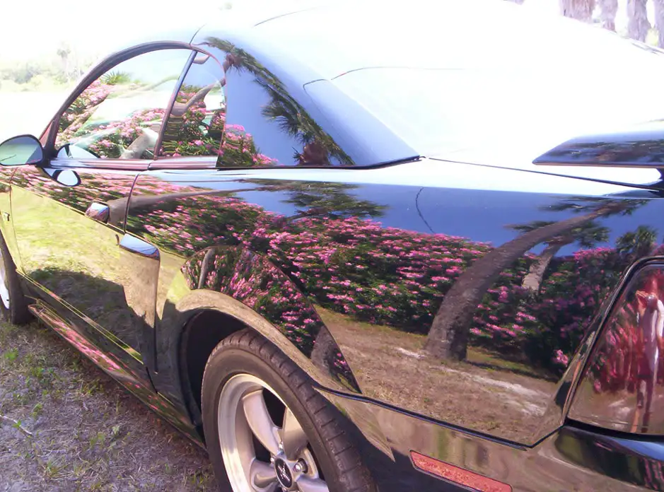

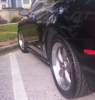

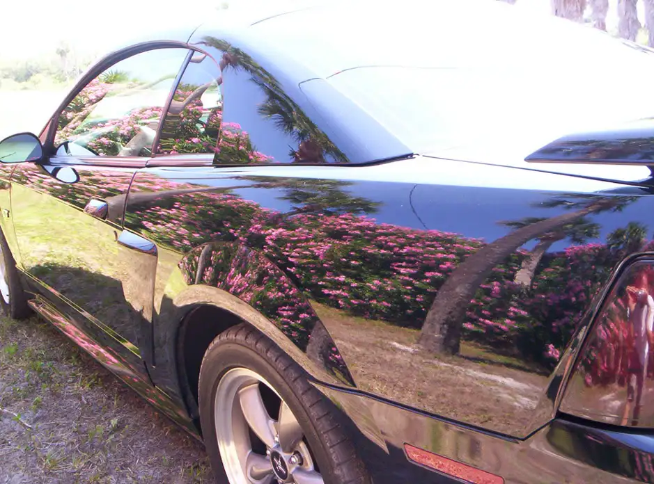

275's at all 4 for well over a year of hard driving with no problems. I like the extra meat. Flame suit on.
Kuhmo ecsta mx's 275-40/17 in the rear and 255-45/17 front.
absolute BEST bang for buck for any street tire!
btw, you can run 275's all the way around on the stock rims. I just prefer the looks of a 255 front and 275 rear.
255 will have straight sidewall.
275 will have .125" - .25" protrusion from rim. Looks good. Stretched tires look crappy. Makes me think of all the hondas with 13" wire rims, 3" wheel spacers, and 165 series tires
I have 275/40s out back on some 01 cobra wheels, but I also had 275/40s out back on my factory bullitts. You will not have any problem with them. I keep the stock 245/45 on the front because I heard that the extra width of the 275 would make it handle like crap in the front.
