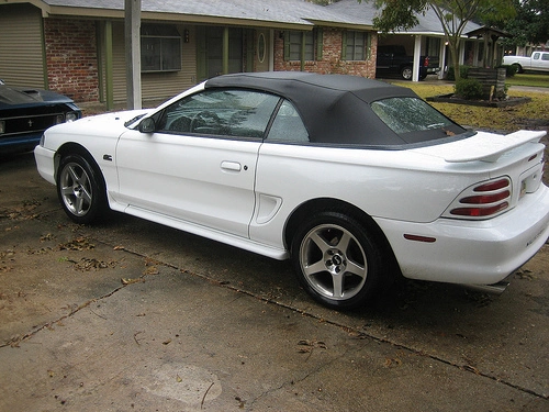

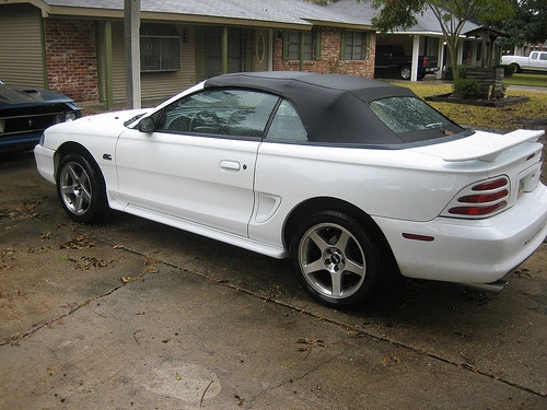

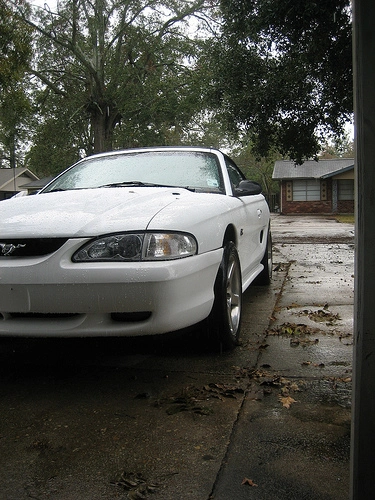

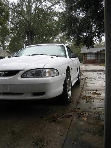

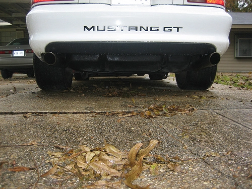

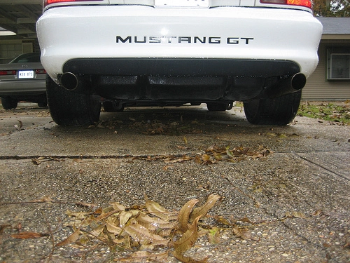

Here's 10.5" rear with 315 Sumitomos and 9" front with 275 P Zero Neros.
