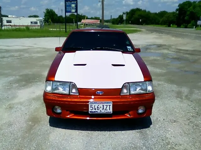

The hood was identical too but the second time I ordered the 1.5" Mach ram air hood and loved it much more. If you wanted to get a nicer hood or a different nose then I highly reccomend Cervinis. Flawless fit and finnish and they require almost no prep work before paint.

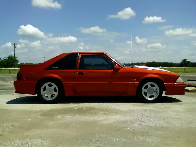

This was the Cervini hood and the nose is a LMR replica. Unfortunatly they didnt use a flex agent at the shop that painted it so the paint chipped right away. Both fenders are LMR repos as well, the $90 ones.

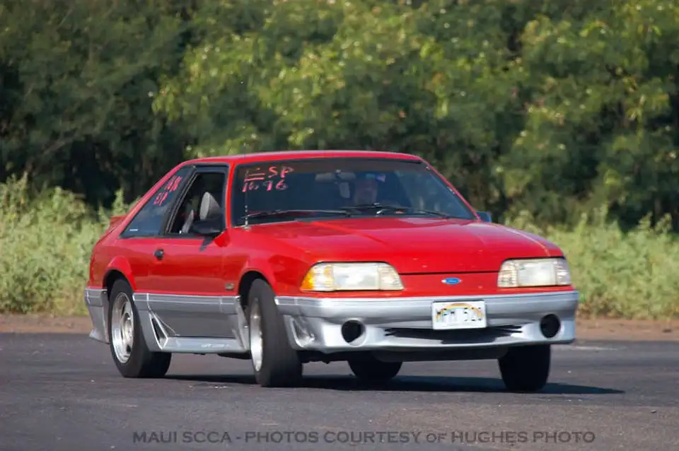

And this is the OEM style hood from LMR after itwas on the car for about a year and TONS of track time.
Just wanted to chime in, adhesion was your problem, flex agent only keeps the paint pliable for a short period of time so that you can assemble without having the chance of the paint cracking. Flex eventually dissapates from the paint over time. I know its way off topic but I just wanted to say something cause many people think thats why paint chips/falls off bumpers. Its all in the prep.
Thank you this is very useful info since it is from the same company LMR. Does the ram air hood really work or is it for show?
You replacement hood looks like the real factory hood and so does the fender. Both items just as strong as factory? Not thinner or lighter? I will also need to get the bumper cap and the guy at LMR told me they use the bumper camp mold from ford. The company that makes the fenders is Fender Bender Inc.

I dont know how else I could put it. They are IDENTICAL to the Ford pieces.... well one exception. On the inner lip of the OEM finder there is a stamp in the steel. The new ones didnt have it and I cant even remember what the stamp said but I remember going over them and trying to find a difference and could not. Although it required less shims to install as well so I guess they fit better. :shrug:

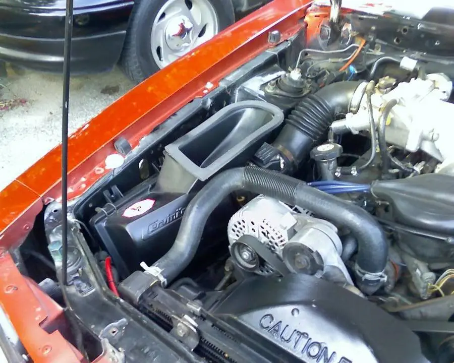

As for the ram air hood, it was functional and thats why I got it. I hate fake scoops on cars. When I had my Terminator I was always so tempted to drill holes under the side scoops and make brake vents. :rlaugh: But Cervinis makes the box cover for the ram air and includes a K&N filter but you need the stock air box lower half.
PS: Good luck on the fender skirts. You can see the orange car dont have them cause I could never find them anywhere. :(
