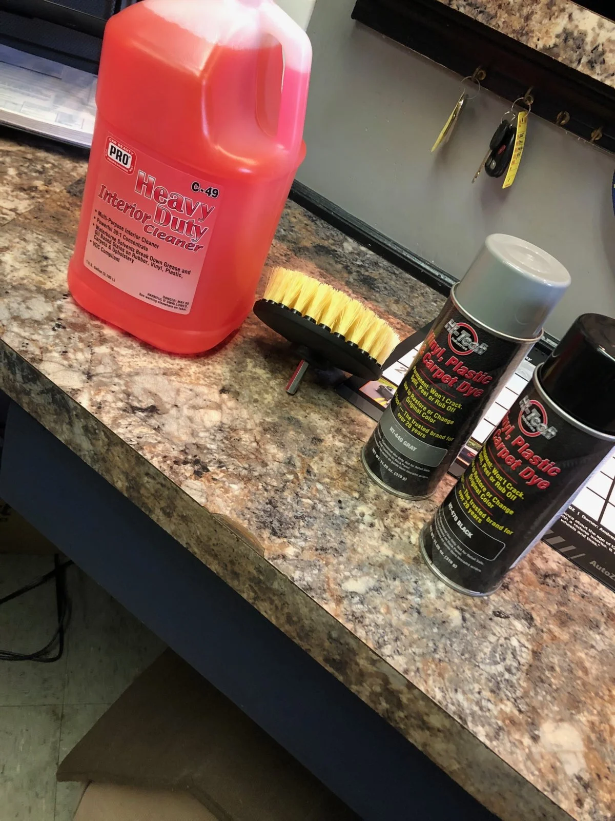

These are the things I picked up to try to finish out the carpet and the seats this weekend. Has anyone used this cleaner before? I picked it up from our detail product supplier when he came by yesterday, I have never used this stuff since we do not do a ton of detailing here (purchase welcome car mats and few other things from him). He swears by it, says he uses it in his house to clean the carpet and dilutes the crap out of it. I plan to use it in a concentrated fashion on the worst spots of the factory carpet with the carpet brush that goes on the end of a drill. We shall see, I have a few things to do with the wife today and hope to work on this stuff when we get back.

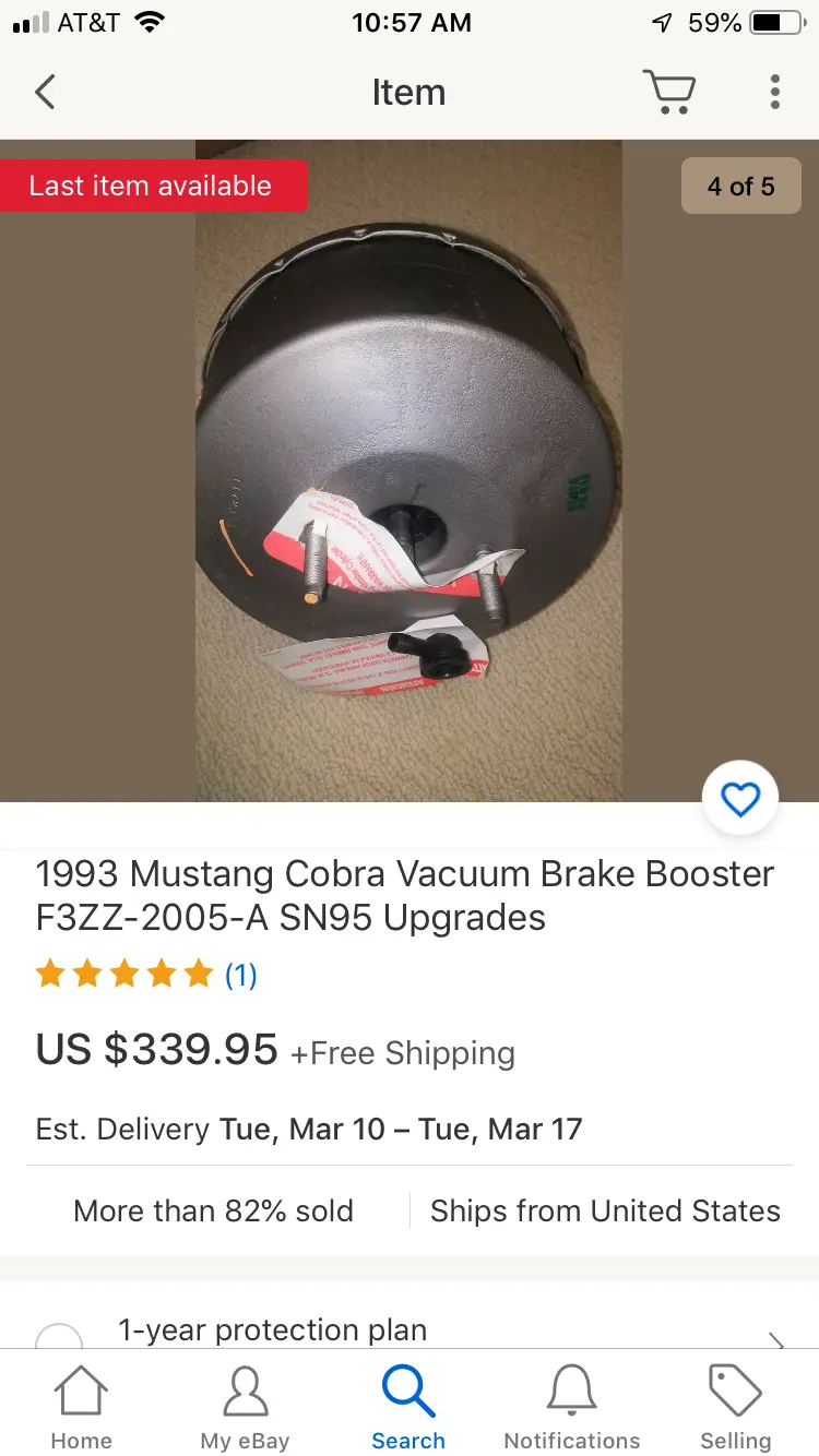

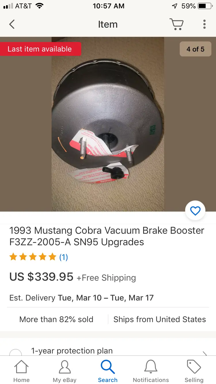

Yea that is why I was looking into them because I am planning on upgrading but if you find a 93 cobra brake booster on ebay or lmr they are double that price. There is one on ebay right now as we speak for 339.95$. Is the one at the parts house the correct booster that I will need to do the upgrade or are they just selling the booster I have now as a cobra booster as well?

$330 for that booster is a joke. I have one on my shelf. It’s a reman. Pretty sure Cardone did it

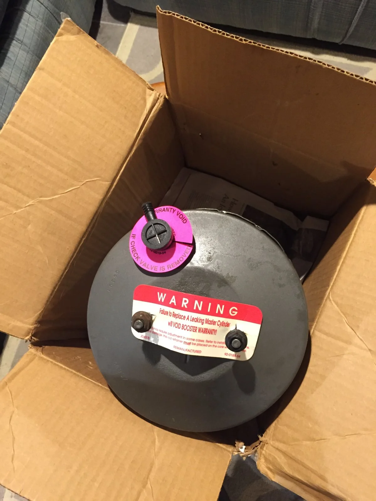

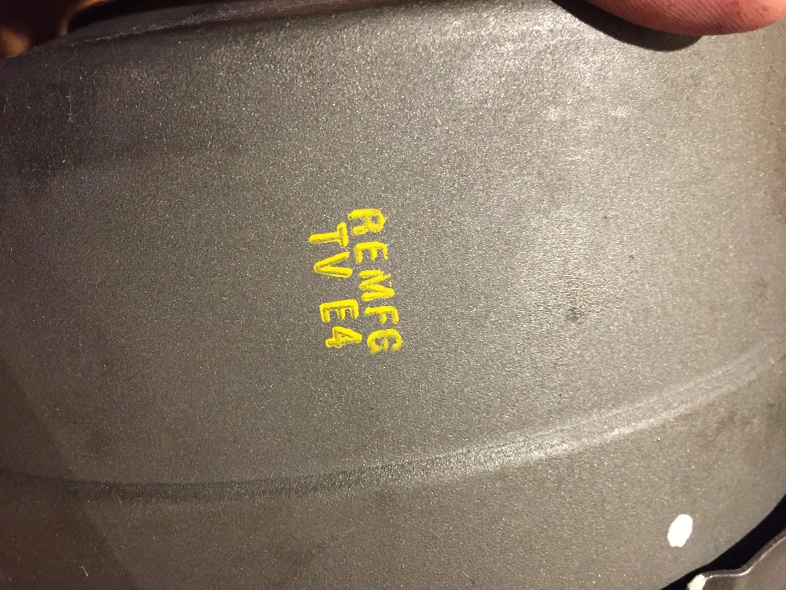

The $340 on on eBay is a reman. Look for the small green label on the side of it. I have the same booster, here’s what it says
Here’s mine
I paid $60.

You can clearly see the same reman stamp on the LMR unit.
