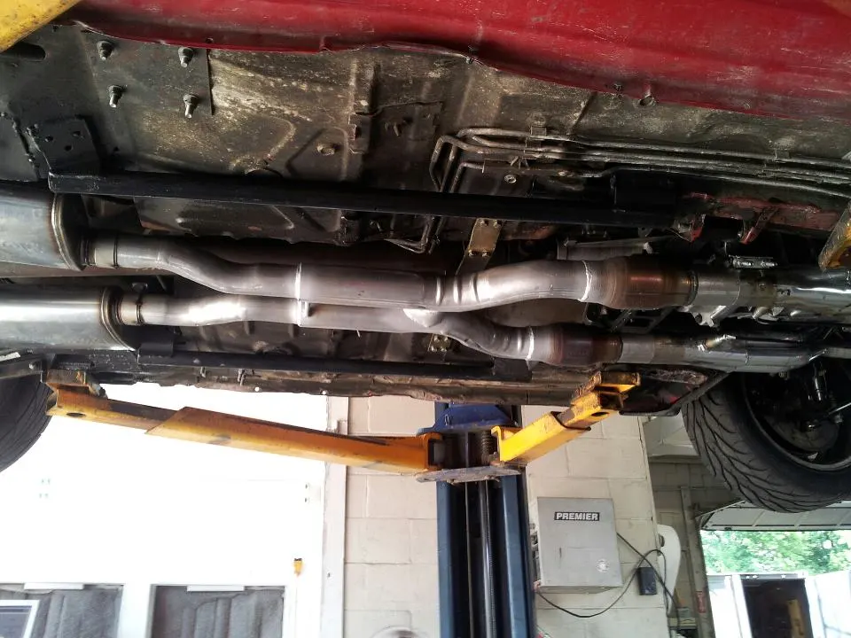

I had a set of the universal 3" Spun cats welded onto my H pipe when having my exhaust finished up last year. I dont think it would cost to much to have a pair of cats welded onto an O/R H or X pipe. I had so much done to my car at that time I cant tell you for sure what the actual cost was of having that done.
