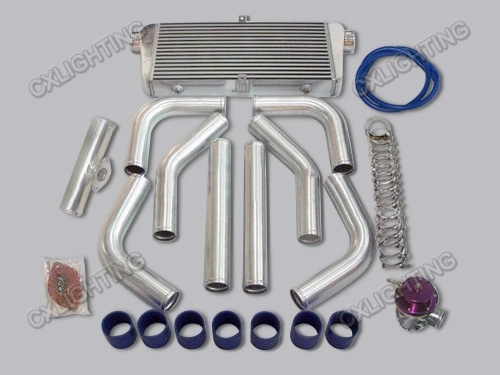

How about this one?
http://cgi.ebay.com/ebaymotors/4-Intercooler-3-BOV-Piping-Kit-3000GT-SRT-4-Mustang_W0QQcmdZViewItemQQ_trkparmsZ65Q3a12Q7c66Q3a2Q7c39Q3a1Q7c72Q3a1171Q7c240Q3a1318Q7c301Q3a0Q7c293Q3a1Q7c294Q3a50QQ_trksidZp3286Q2ec0Q2em14QQhashZitem518a7da4a3QQitemZ350215840931QQptZMotorsQ5fCarQ5fTruckQ5fPartsQ5fAccessories
You can probably ditch or sell the meth injection if you are getting a front mount. Do not think you will need both. A good flowing frontmount will do the job just fine. You can sell the meth and get some $$ out of it towards the intercooler. Most people run the cxracing intercoolers from ebay. Its 31x12x3. Here it is. It will require some pipe modification, but nothing to huge. This is what I will probably end up doing.
http://cgi.ebay.com/ebaymotors/CXRa...TruckQ5fPartsQ5fAccessoriesQQsalenotsupported
