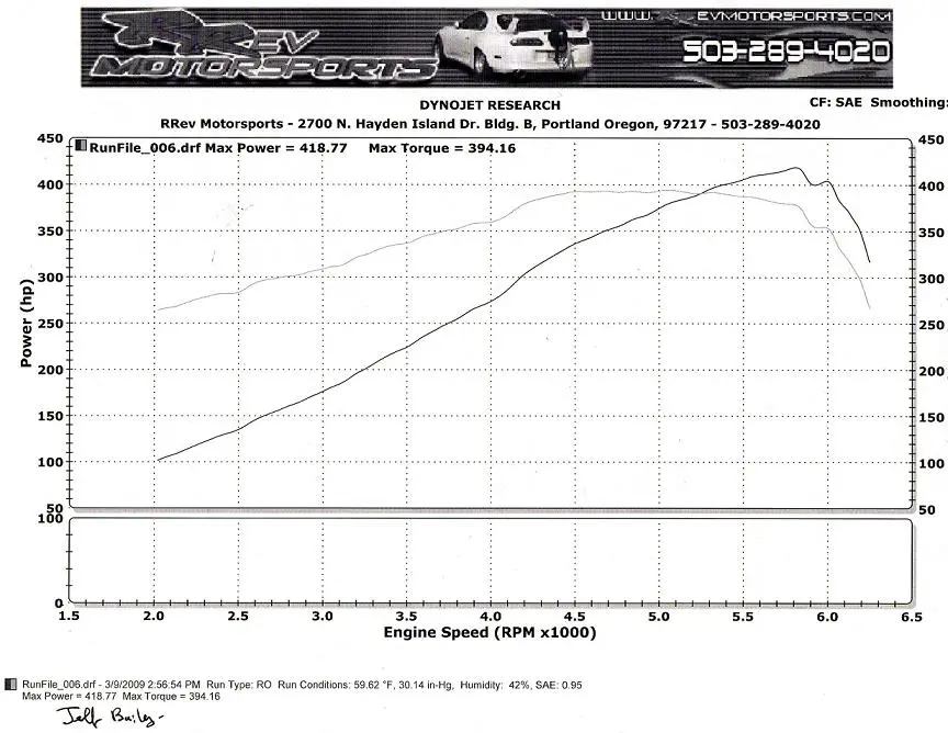

some food for thought.....
KB's make the power down low, for me; step on the gas.. 8 psi lasts till I shift gears, I've heard it falls off with RPM but am yet to experience it. Heat, sure it gets hot, but I've never had any real problems, even in the 100+ NC summer. Yeah, I popped the head gaskets, but in their defense they were originals, facing 10 psi, second back road run after installing the KB, good times though....limped home, backed off the timing, swapped pullies, swapped HG's......multi throttle romps, and several cross country expeditions, still worry free
I like it, but this isn't a track warrior/vette slayer, never intended to be. Soon I'll be adding Eddy heads, a "cam", ported lower, and some fuel stuff to ditch the 19's and FMU, again looking for some more oomph, kinda the opposite approach you took Grady. I've had it for a few years now, still has plenty of oomph in it, just needs more fuel, so I figured while I'm at it...even got the Tweecer, just need the time to put it all on. As for it being a few years old, I'm yet to experience the fabled oil drinking KB's are notorious for. Not saying it doesn't happen, maybe I just got the good one from the assembly line.
No hands on experience with the vortech types, but don't they need the RPm for boost....to me RPM is that (oh so sweet) noise, that'll attract attention on the street, maybe not the kind we want. With the RPM a natural occurence is gonna be speed, again drawing the negative attention. Not trying to dog the vortech guys and sound like the KB's are better or what not, just some thinking out loud, well, on a keyboard anyway. Maybe some of those guys using them have their thoughts...
6 one way, half dozen the other

And last the dyno sheet. SAFE TUNE! There is alot more in this combo but why push it?

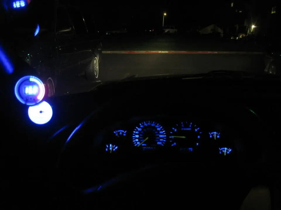

and i did some LED action too :D lol.... its fun having a boost and A/F guage..
